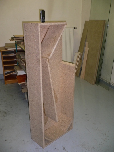

Graham,
These boxes are back loaded, maybe it's not the right for this circuit as you say. Though T-bass do make a difference, as "jump factor" is better with the circuit.
What I wonder about my transformers is still the inductance of coils. CLS mentioned his coils were around the 300's mH, while mine are much lower. At least according to my meter.
Cheers
http://www.diyaudio.com/forums/atta...5833d1207687672-sonido-bib-march-2008-003.jpg
Wonder if the Sonidos would reproduce better with their backs removed ?

Hi Peter.
Do try taking the back off one of your Sonidos - might prove worthwhile ?
If your transformer impedance above about 150mH - very likely OK with decent amplifier.

Graham,
I suppose you mean inductance. The problem is that I measure ~20mH with a multimeter, which of course can be wrong. Oh well, I have to find someone to measure more accurately....
Regarding taking off the back of Sonido boxes. No, I won't do that, I have other plans for T-bass...
