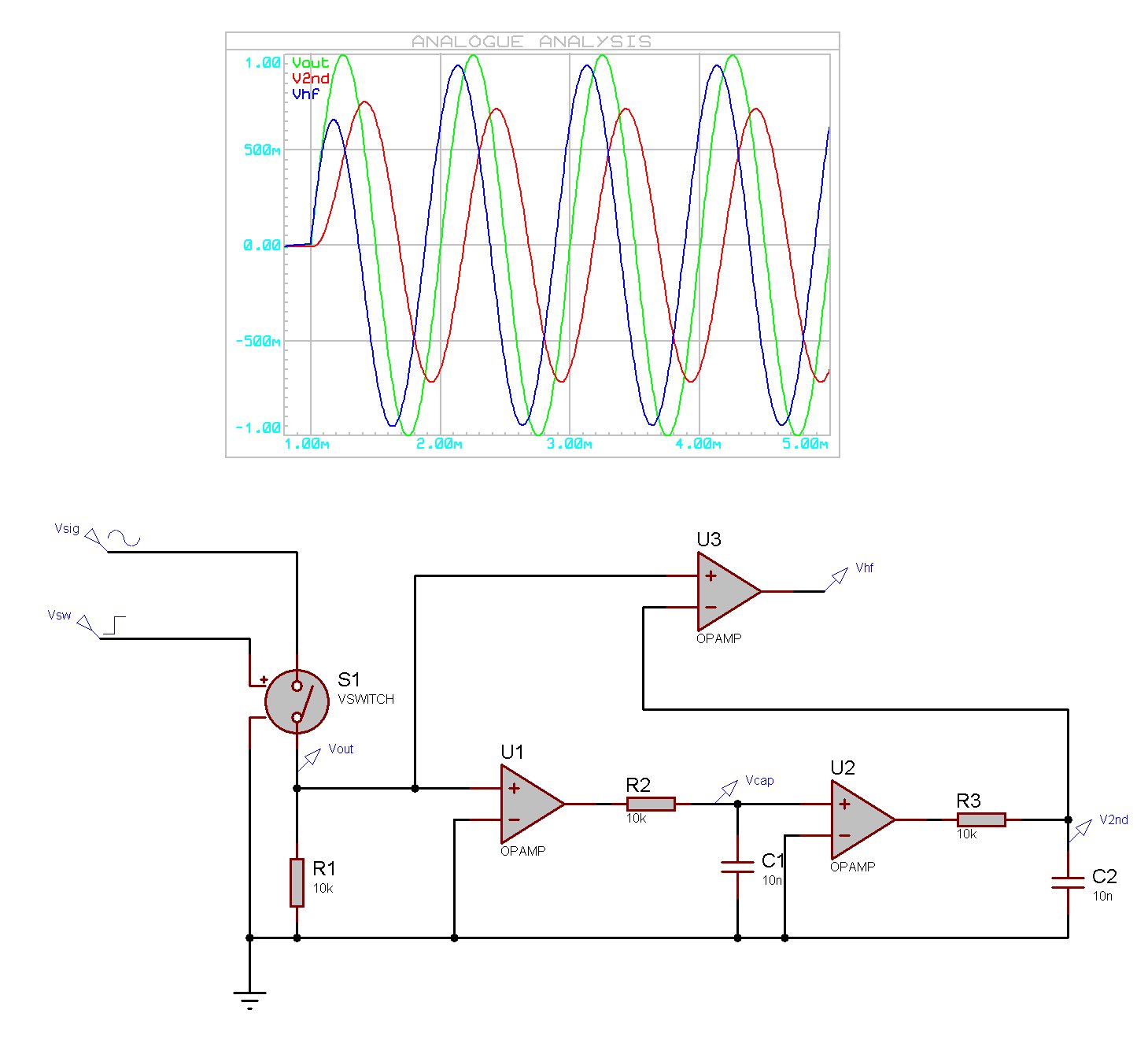

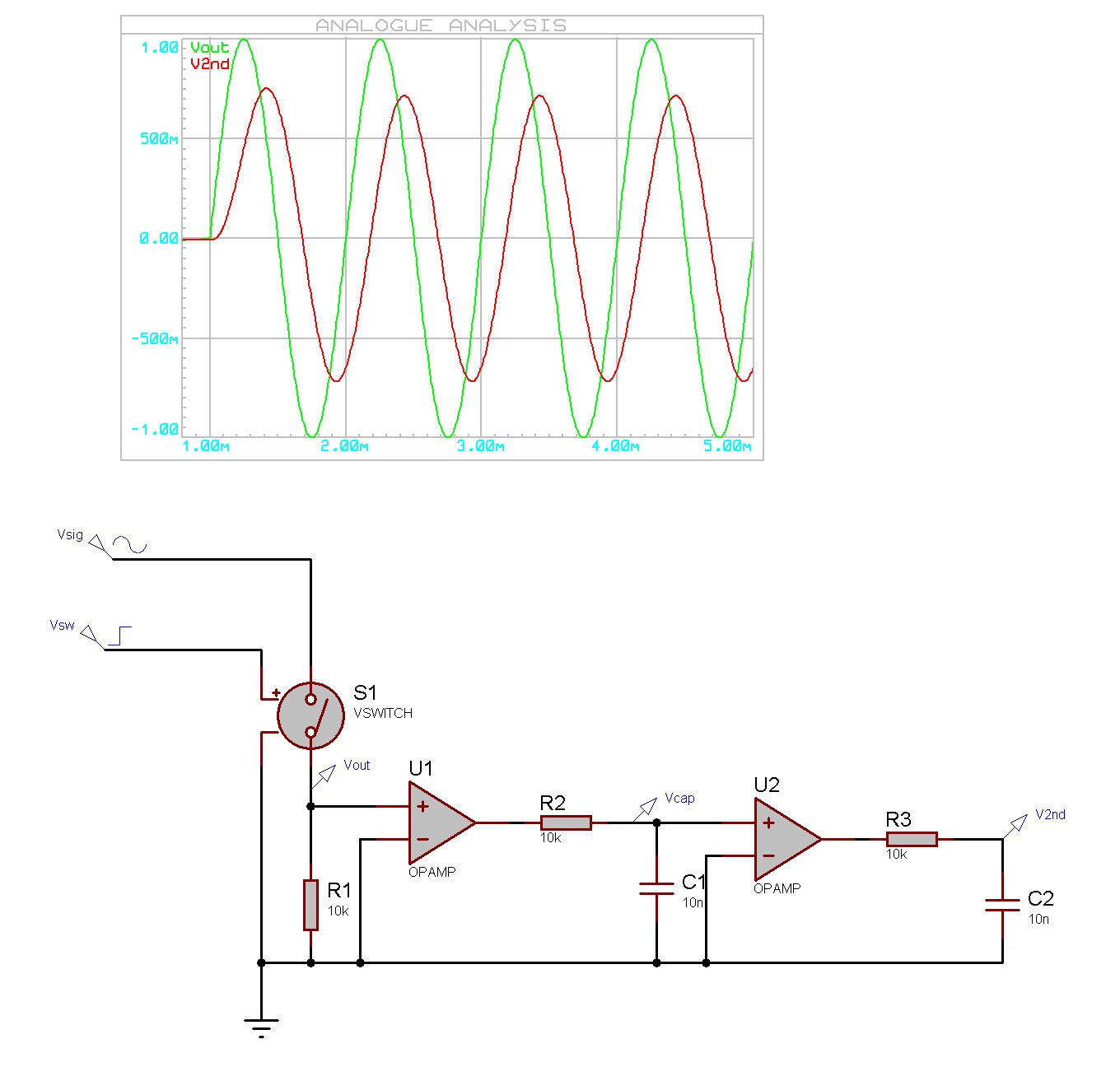

The attached show what I mean. I simulated a first cycle with a sine source switched on at T=0 with a voltage controlled switch.
The original first cycle is in green and shows the sudden start-up of the signal.
Next I simulated a 24dB xover (the opamps are just x1 buffers to isolate sections, output in red.
You see that the initial attack is much more gradual now, and also that the signal amplitude is less than the 'ideal' first cycle. So that is what the woofer sees, and that is what I believe the woofer has no problem with.

I also looked at what would go to the tweeter, by taking the difference between the original graph and the woofer part (blue).
You can clearly see that the 'fast' part (blue) is split off and will go to the tweeter, the lf part (red) goes to the woofer. Adding red and blue gives you the original again. (The top opamp is a unity gain difference block).
jd

Hi Grahan (it's 'janneman' btw, without the 'r'),
Yes maybe I miss the point. I was under the impression that you were trying to correct something that was the result of a 'first cycle' distortion, however defined.
My point was that the first cycle you showed to illustrate the issue is not a realistic signal and therefor the 'problem' is only artificial and doesn't exist in real music with real speakers.
Are we miscommunicating? What is the relevance of 'first cycle' to what T-bass tries to do?
jd
It will be more obvious, if you use a signal that consists of at least two different frequencies. In your example the tweeter sees the same signal shifted in phase, but with a higher amplitude than the woofer, because the crossover frequency is below the signal's frequency. There is no 'faster' and 'slower' part in a sine signal with a constant frequency.
[snip]There is no 'faster' and 'slower' part in a sine signal with a constant frequency.
Of course, but when you use a tone burst, there are several harmonic components that are routed to the appropriate driver depending on freq and xover, that was what I wanted to illustrate.
