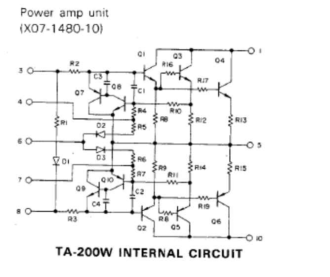

Does anybody know where the Kenwood power amp (TA-200W) can still be obtained? I have one in for repair, and the shop owner says he can't find any at all.

Here's the schematic - very simple. Outputs are darlingtons, the bias diodes are included in the package. Rbias could be 200 ohm trimpot, typically ends up in 10-30 ohm range. The outputs are mounted on the back of the board against the heatsink. The 330pf caps probably compensate for the airwiring. And I know the circuit is a little over-protected.
Prototype 1 used the SAP15 transistors which include the emitter resistors - but the SAPs are out of production. Prototype 2 used parallel pairs of STDs, but stability, or rather docility, was an issue - probably due to wiring.

I've included a schematic of the KR-9600 output board, but it's a bit hazy. Anyway, pins 1 & 10 are power, pins 3 & 8 are drive, 5 is output, 6 is ground.

I made a replacement STK-0050 module for the folks at the AK Pioneer forum. They are using them in the SX-780 and some Fisher models.
We have saved a few from the landfill 🙂
I simulated the design in ltspice.
One member has made up the Al plate to mount the pcb on, it attaches to the existing heatsink. The plates are being sold on eBay and I have made the BOM available at Mouser.

check out post #11 underWhat do pins 4 and 7 do in the original chip?
Is your circuit based on what was originally in the 200W chip?
Or did you design this from scratch?

If you can't find a replacement TA-200W power amplifier, what would happen if you soldered in transistor STD03P in slots 1 thru 5 and soldered transistor STD03N in slots 6 thru 10? Would it work, or major damage?
TA-200W are virtually impossible to find, there must be a way to engineer this problem!

I have been asked by a member if I can make up a TA-200W module, like we did for the STK-0050 as used in the Pioneer SX-870.
If anyone is interested, let me know, I may consider making one up.
As we did with the STK-0050, it would be advantageous to have another member, with a KR unit to work with, so we could figure out the design details and test it out. I do not own a KR unit that uses a TA-200W.
I will need a TA-200W(dead or alive) in hand or measured up in order to even start.
It might take a while but I think it is feasible to do this one up and put some new life into the old units.

Hi, I’m the lucky owner of 2 kenwood 9600s , with a total of 3 bad ta200w s. I did see the schematic you mentioned from alpha yes, but it is missing some of the component values. Would you have a complete schematic, listing the components. Ide appreciate it thanks mike
If you are asking me, sorry, no TA-200 replacement design, it is summer for me, so no time right no, I'll see if I can get to looking at it this coming winter.
Hi, yes I was asking you, rsavas, appreciate the timely reply. What I was asking was if you knew the missing values of the components on the diagram that alhaynes had posted. I though I had read that you had built one and that it worked well.
