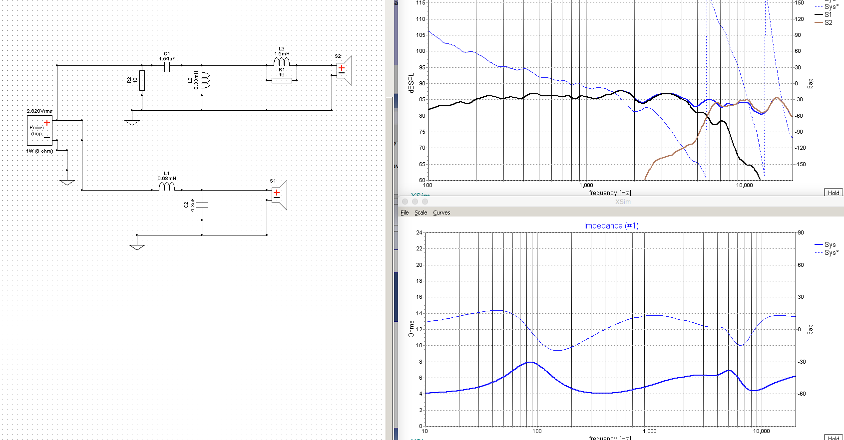

As an introduction, you can get Dayton's zma and frd files for that driver and get the free XO simulator, Xsim (it's here at DIYAudio).
That will not give you real world data of the driver mounted on your baffle and in your room, but it's quite good practice.

A very quick try with that Dayton driver, with 2nd order XO and a BSC on both shows some promises...

Well ok then that is promising. Thanks for the tip. I had an emulator on my Mac once but a OS upgrade created huge issues. I will look into this, I always wanted to try out some of the SIM software, this would give me a chance with no cash outlay. Been a big help Perceval.

I am playing with XSim running on WINE. Well Crossover (just realized the pun, but not intentional) which is the paid version, using their trial. Works great on the Mac as you stated. As I work through this I am pretty sure and committed to running with the CX120 in the TABAQ if I can get the XO/BSC where I am happy.

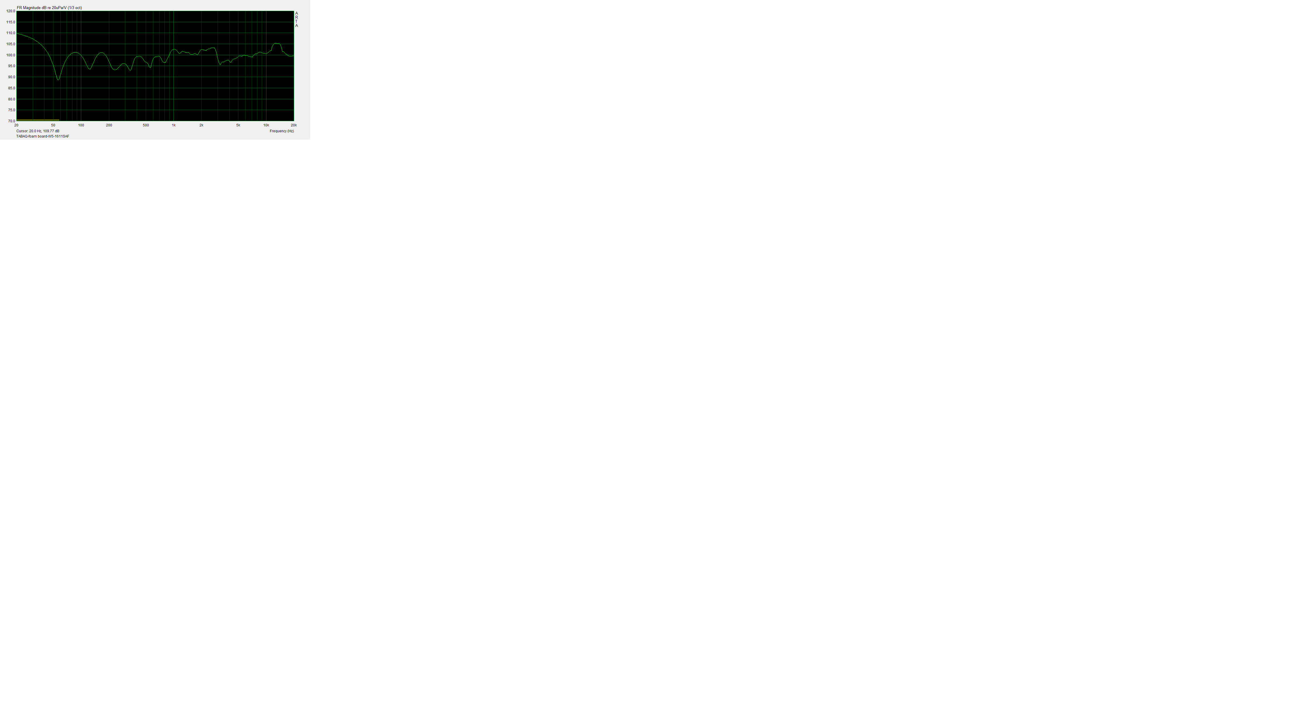

Need help interpreting the response graphs for foam TABAQ
completed building a foam core board enclosure. Using a Dayton Audio iMM-6 mic and the ARTA software got these graphs but not sure if they make any sense, would appreciate any help I can get in interpreting them.

The mic was placed about a meter in front of the speaker.

How did you measure the first and second graph to have different curves? The first one would drive me nuts with that spike at 1kHz.
Also, your foam core enclosure is very leaky, but the looks of the lack of bass from that TB 5" driver. I doubt foam core is appropriate for this size of a driver and the pressure generated, unless you triple the amount of foam core boards... then, maybe... perhaps... not completely sure.

Thanks for that feedback. I am not sure if I am doing it right - I record some generated pink noise.
