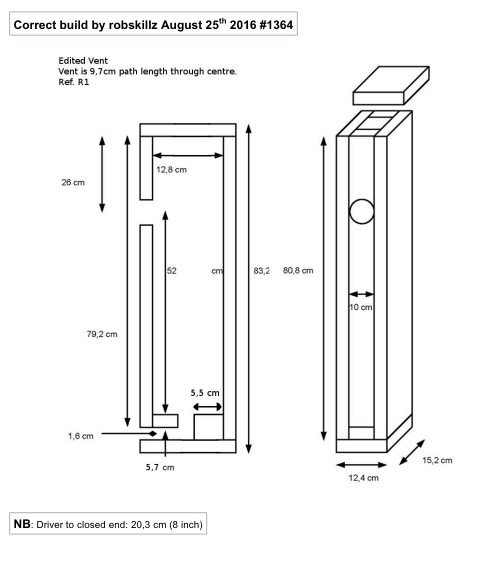

Slow but now is time....
Mid January I was asking about the FaitalPRO 4FE32 (I know I'm slow). The time has come to get to work on building. Well within a week or so.
I have looked to see what others have done regarding enclosure size, placement of driver, length of opening and stuffing. I found PDF files regarding different 4" drivers which gave me some direction. Found the PDF of the change robskillz made to the plans with diagram (see detail attached image) from PDF. Is this even close to what I should consider using for this FaitalPRO driver?
Bjorn your right, its not the prettiest driver around kinda ugly for sure, but i am hoping to mount from the back of the baffle and round edge on the front. I might have to go 21mm baltic birch though in case i need to knotch the sides out a bit for the tabs to fit. I think it is worth the try. I am using now the TB 315E which sound great on my system with a sub. I am hoping these will perform as well but a bit more bottom. Thanks for the bit of reassurance though.
You could go super-baffle. Mount a (an artistic) ring on the front of the speaker then mount the ring on the baffle. The fixings for the driver can be wider than 10cm without chipping away at the sides of the box. 4FE32 on PE website is modelled as having F3 of 77 through 59Hz for the 4 - 16ohm variants resp. the 8 ohm sitting in the middle. You'll probably get more bass balance off them but not deeper extension IMO.
J.
Yes Jerms I thought of that as well. Some nice purple heart or other exotic might do the trick. but I will test first the sound and get it to my liking before doing the pretty stuff!
I will toss it around in my head as to which way I would like to attempt. The deep extension isn't important to me as I use a sub with my TABAQs but like you say a bit more bass balance would be nice. Mostly trying these because the 315E's are no longer available through PE, and it's just fun to experiment. I will post my build once I get things underway.
