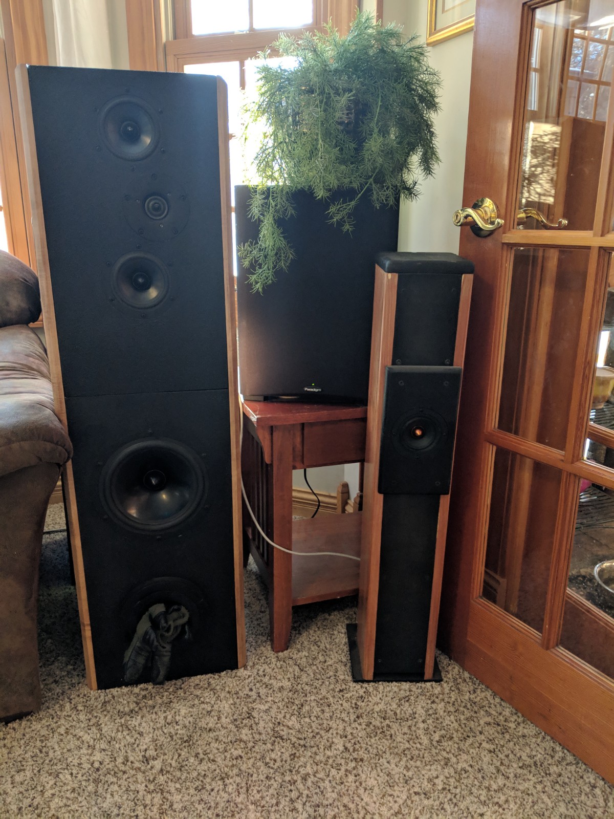

I pulled my TABAQs out of the corner this morning to listen to them. It still amazes me how good and how big a 3.5" driver can sound. These are Dayton PS95-8 drivers.
I have a pair of TangBand W4-1337SD drivers I think I'll try. They might need a bit of taming up top, but I'd like to see how they sound. These drivers have been used in the TABAQ, correct?
Thanks,
Mike
