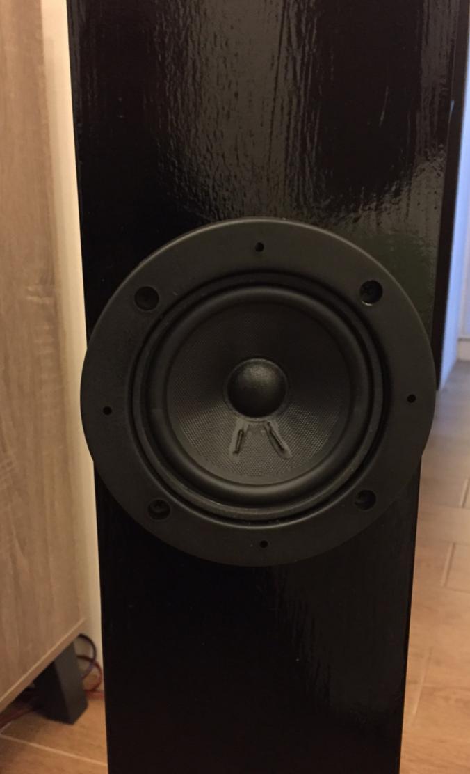

docbak in my case I did not like the filter so I take it off but of course is just a matter of taste, I have a good EQ so I can manage frequencies, for the driver fixing I used a plastic ring, I put the picture more easy to understand....all the best
The 4fe32 will not overhang as you can see the front baffle from the Tabaq original design must be 10cm then depending from the thickness of your choice plywood could be 12,4cm or more so plenty of space for fit the driver....all the best
