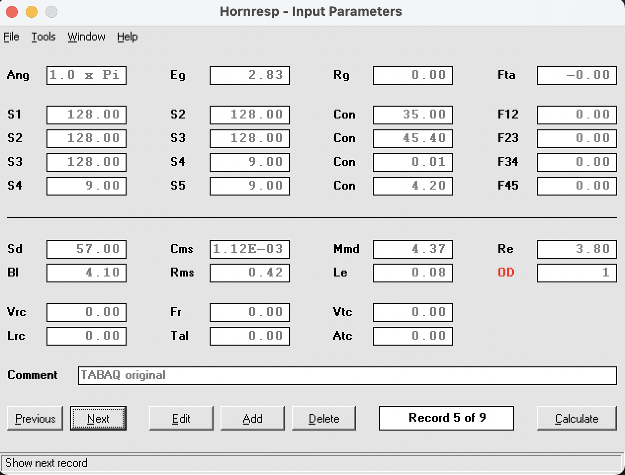

One other question, is hornresp a viable or even proper tool for modeling? I learned to navigate it with tapped horns but TABAQ is pretty much the polar opposite in every way. Identifying the segments is different since the transitions (mouth/port area) are abrupt (if that makes sense)
EDIT- I believe my problem is choosing the proper alignment name since I have to do it in 5 segments rather than 4. I'll keep digging through the help file.
Sure, HornResp is great for this and so many other designs.
I made a template of the TABAQ in there, so it is a starting point when I find other drivers and I tweak from there.
Have a look, hmmm. that looks like a tweaked version. I guess I should redo the template that was overwritten. Still gives you a headstart.

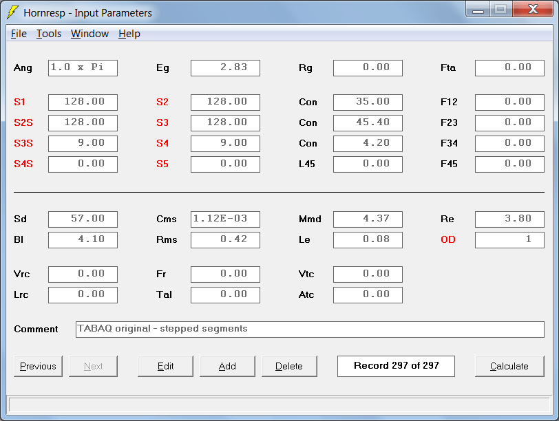

That is extremely helpful and reassuring that I was going about it right. I had to do a 0.01 L value for the transition into the vent/mouth to make it 'assemble' correctly. I can find the tweaks and work it from here I believe.
I may be back for help or a second set of experienced eyes in the near future though. Thanks again!
Not if you specify stepped segments. That way you also have a spare segment to play with :).

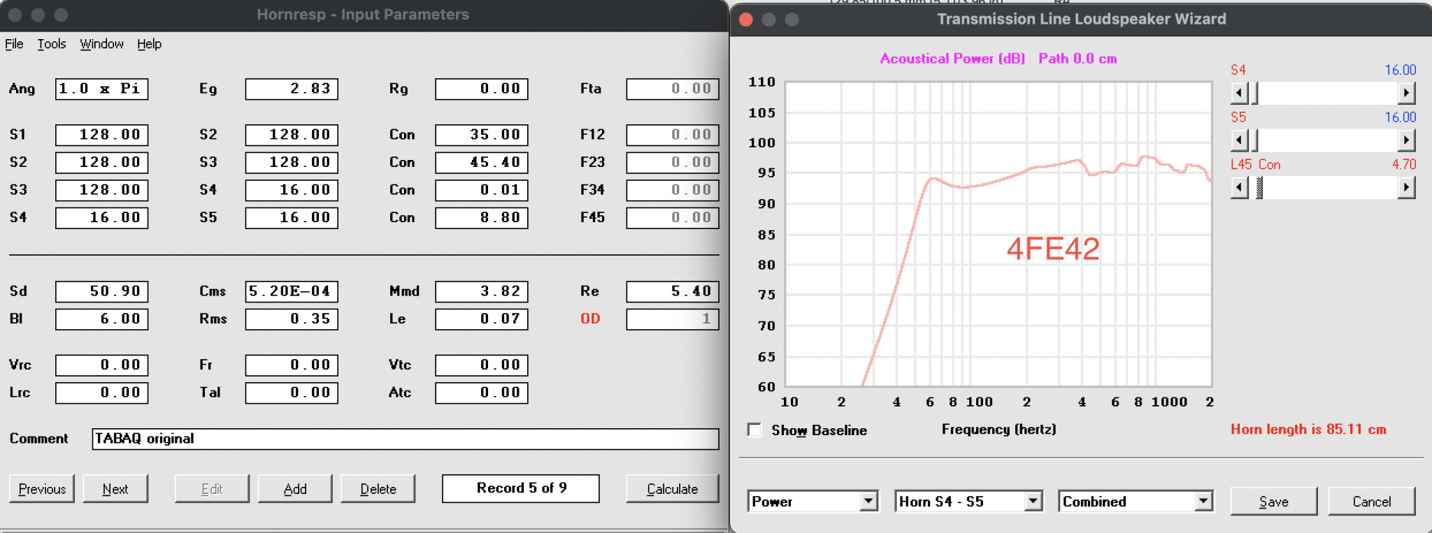

Hi Bjorn. Hope you are still around. Would it be possible to run a sim for this relatively new Faital Pro 4FE42 8 Ohm driver please? Specs attached. The Qts looks about right.
I have been running 4FE32 drivers in my TABAQs for more than 2 years now and I’ve been more than happy with them. But disaster struck when one of my amps misbehaved this weekend. Something popped on one channel and it blew my one driver. Would be great to know if the 4FE42 drivers might bring something new to the TABAQ?
  • 4FE42_datasheet_8.pdf

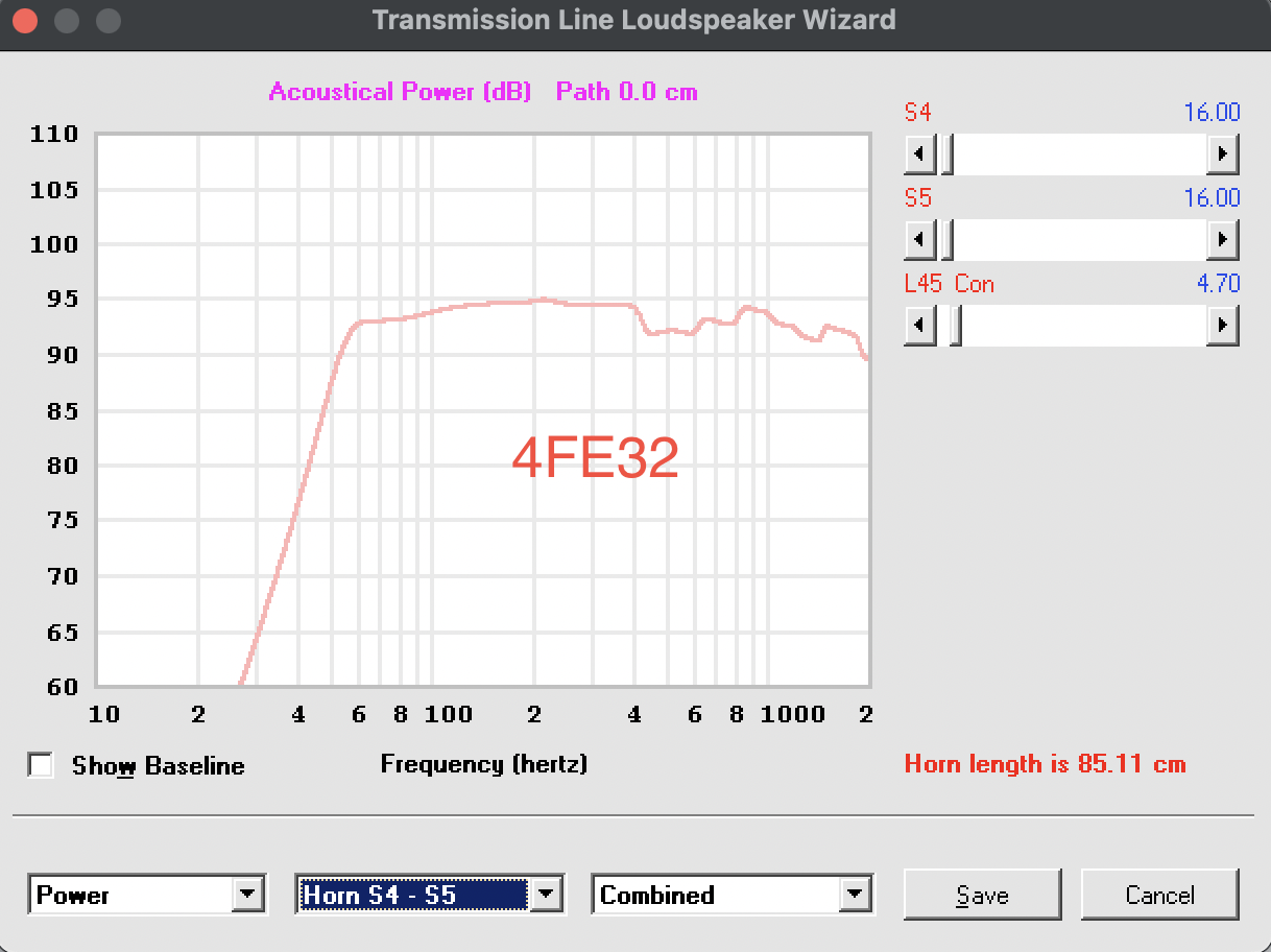

Bjørn can confirm later with his version, but having plugged in the 4FE42 quickly into my template, I think you should stay with the 4FE32 instead.
The knee is not as clean on the 42, and will make the ripples going up in frequencies fell worse.
I also reduced the port length considerably... I didn't like the shape with using the original 9cm port. The 4.7cm looks a lot better.
Room acoustics will help lift the couple of dBs lower around the knee.
So, I would just get another 32 version to replace the blown one.
