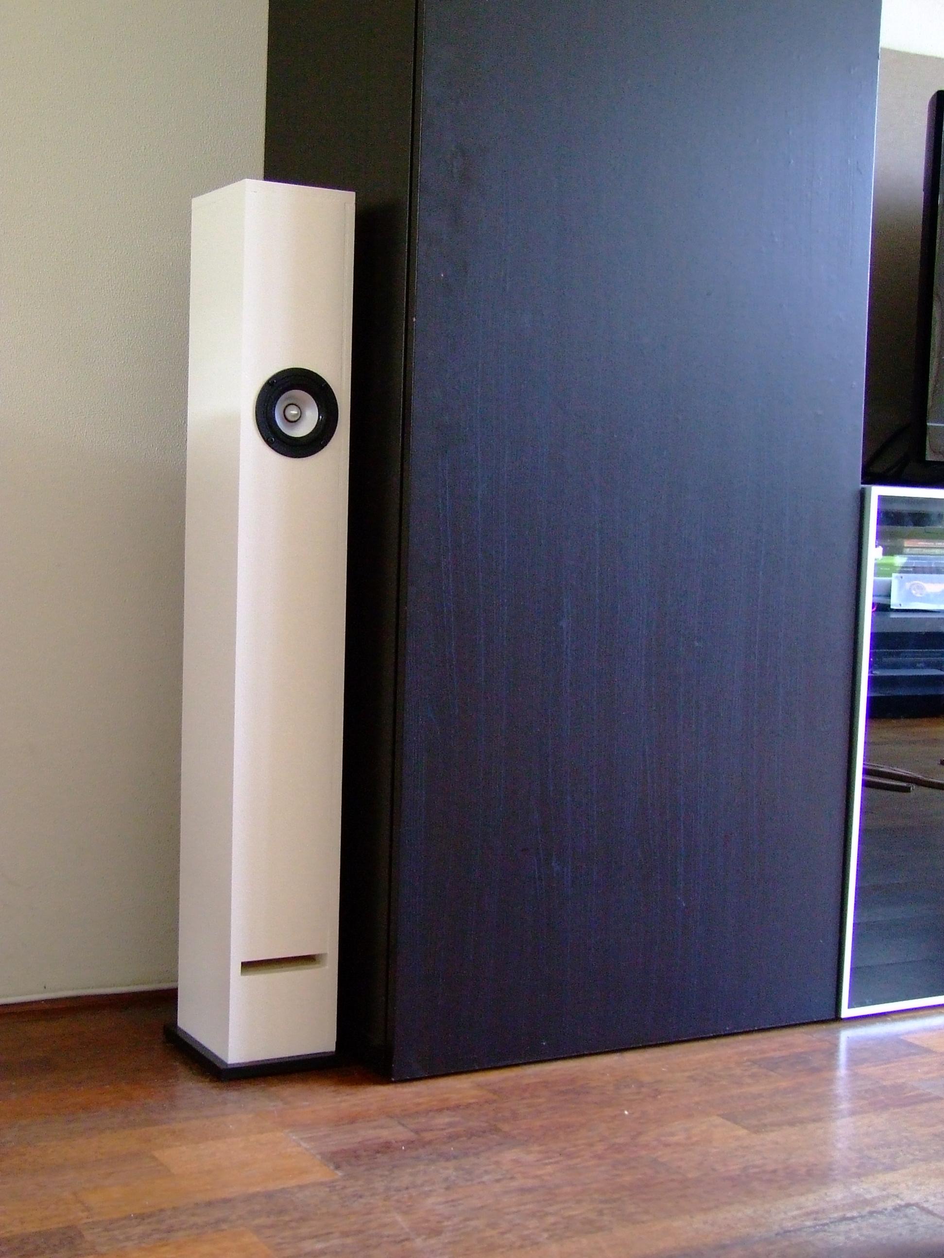

I finished my Tabaq speakers yesterday.
The workmanship (woodworking, painting and soldering) could have been better. However, I am very pleased with the sound, especially after a few hours of running and listening to some of my favourite cd's.
A big thank you to Bjørn and everyone who contributed to this thread!
Looks good! Which drivers did you use?
- Full Range
- TABAQ TL for Tangband
