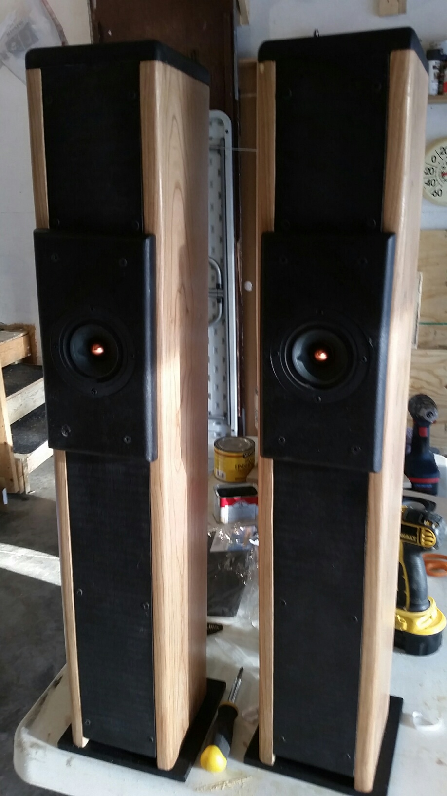

I built the cabinets, but with a removable baffle so I could try different drivers. I've been playing with the Dayton Audio PS95-8 and the AuraSound NS3-193-8A. They both sound great as long as I have them against a wall, more so with PS95. If I include a BSC filter, I'm thinking it won't be as critical to have them against the wall.
Am I thinking correctly?

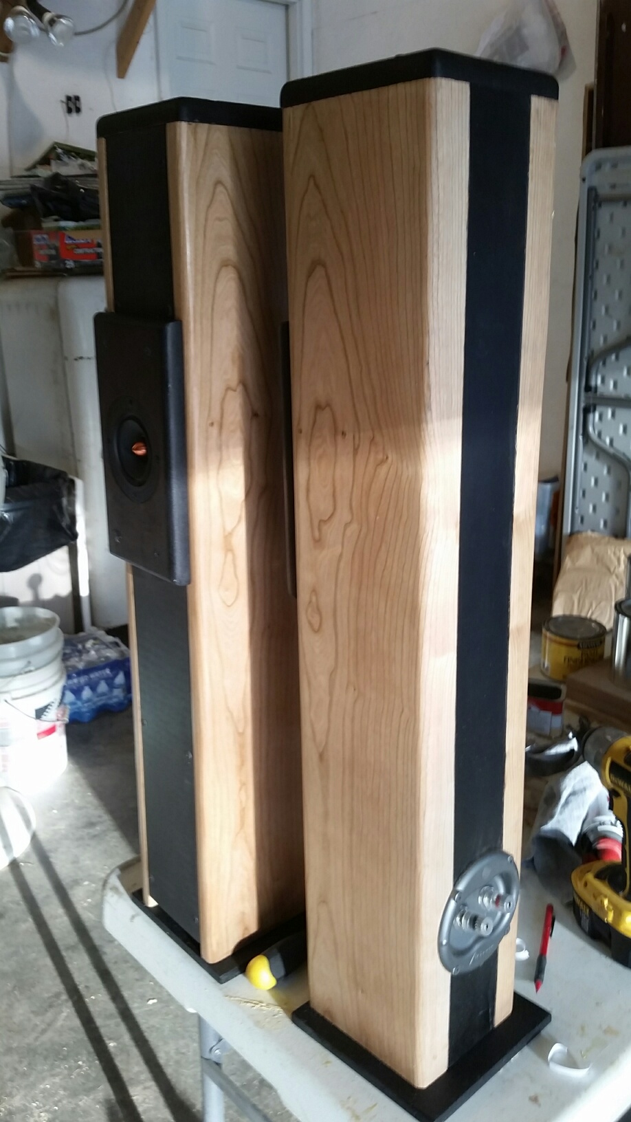

I just completed a pair of these with the Dayton Audio PS95-8. Saying I'm impressed is a vast understatement! Thanks for sharing Bjorn!!!
Now... as an compulsively addicted DIY'er, I have an idea, which comes with a question. I don't know if this is even reasonable or feasible, but here goes. Would it be possible to make a "double TABAQ" in a vertical fashion? I know I've seen something about making a "double TABAQ" with the same vertical dimension, but I'm curious about changing the height, since I think it might be critical. I think a tall TABAQ might look impressive. Plus I wouldn't mind bringing up the sensitivity a little since I might gift a pair of these along with a small T-amp or class D amp.
Just wondering about options... and gifts.

As regards a taller Tabaq, and a more sensitive one, it's difficult.... The Dayton driver isn't insensitive. It's also small enough to produce a reasonable top end. You could go to something like a FaitalPro driver 3FE22? But you'd need to prop up the bottom end of the frequency response with a woofer (or 2). Possibly you could insert a couple of 4" woofers firing sideways out of each enclosure?
