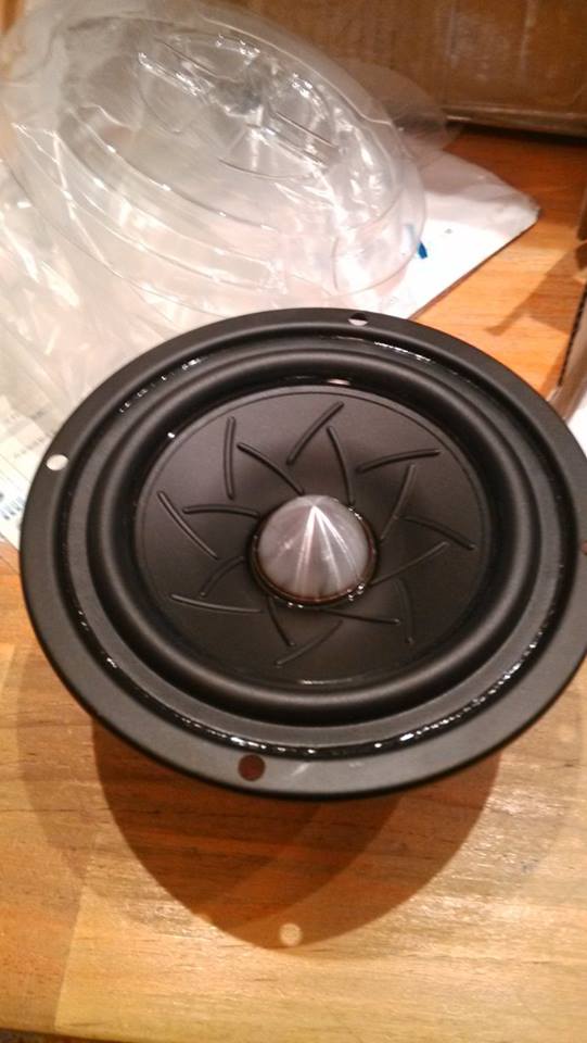

Interesting stuff you all... I'm following the discussion.
On another note, I just received the TB W4-1052SDF today and it looks awesome.
I placed it in my TABAQ test box, and all the ingredients seem to be there.
I will do a frequency sweep soon to see if I need BSC.

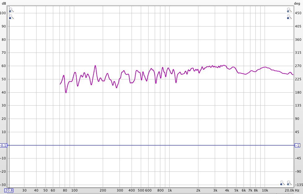

Here's what the W4-1052SDF looks like in the TABAQs.
This is taken at a lower spl because I am still breaking in the drivers. Also, TABAQ was away from the back wall, so, would not need a BSC if placed closer to the back wall.
Not too bad.
Not too bad.

Personally, I would hate having to deal with two peaks so close to the "telephone" frequencies around 1k.
Separating the peaks looks like a good idea to me.
Thanks!
I plan to put them as close to the wall as possible.
Those W4-1052SDF are very tight and punchy. Pleasantly surprised from this polypropylene cone.
