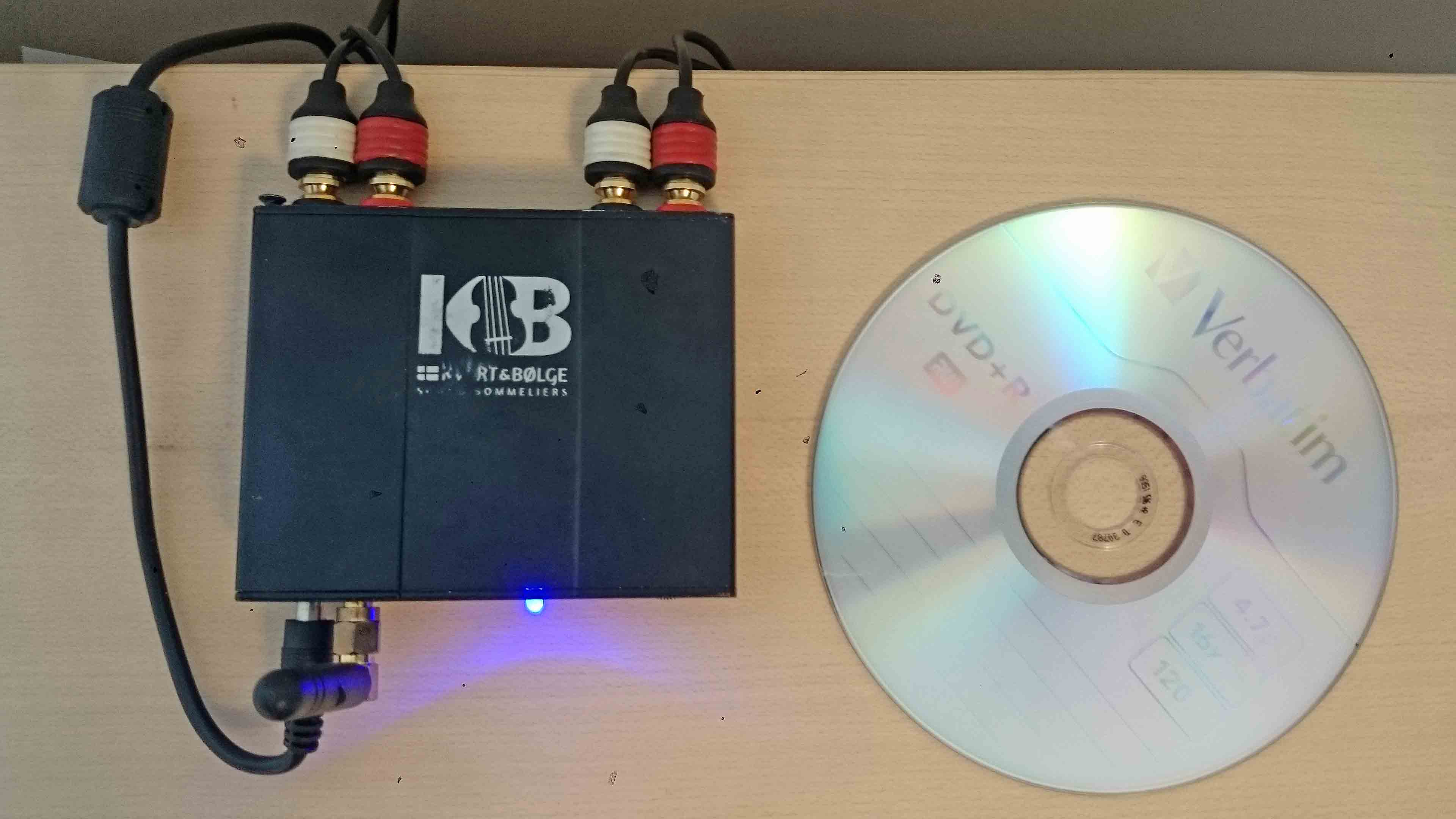

Active TABAQ
An easy way is to use this tiny BT AMP and just hide it anywhere - or put it in one of the cabinets.
My amp is just laying on the floor behind a book shelf :)
The Ultimate Bluetooth Audio Receiver/Amplifier - Model 300
PS: For streaming I use VLC with EQ on - but Flat - and "2 runs" set.
Hi
Bjørn
