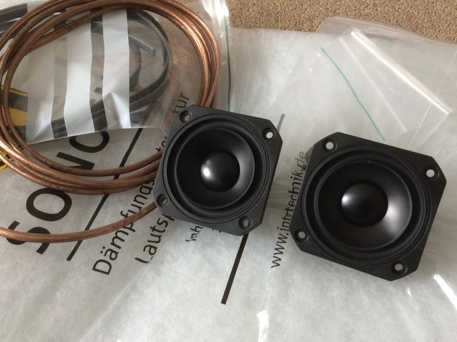

Update:
After two weeks of reading (studying 🙂) this thread I finally decided which "budget" driver I am going to use in my first Tabaq build the Peerless 830987
Yesterday I received the drivers, filling etc so now it is time for the next step, ordering and sawing MDF
Kind regards

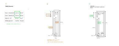

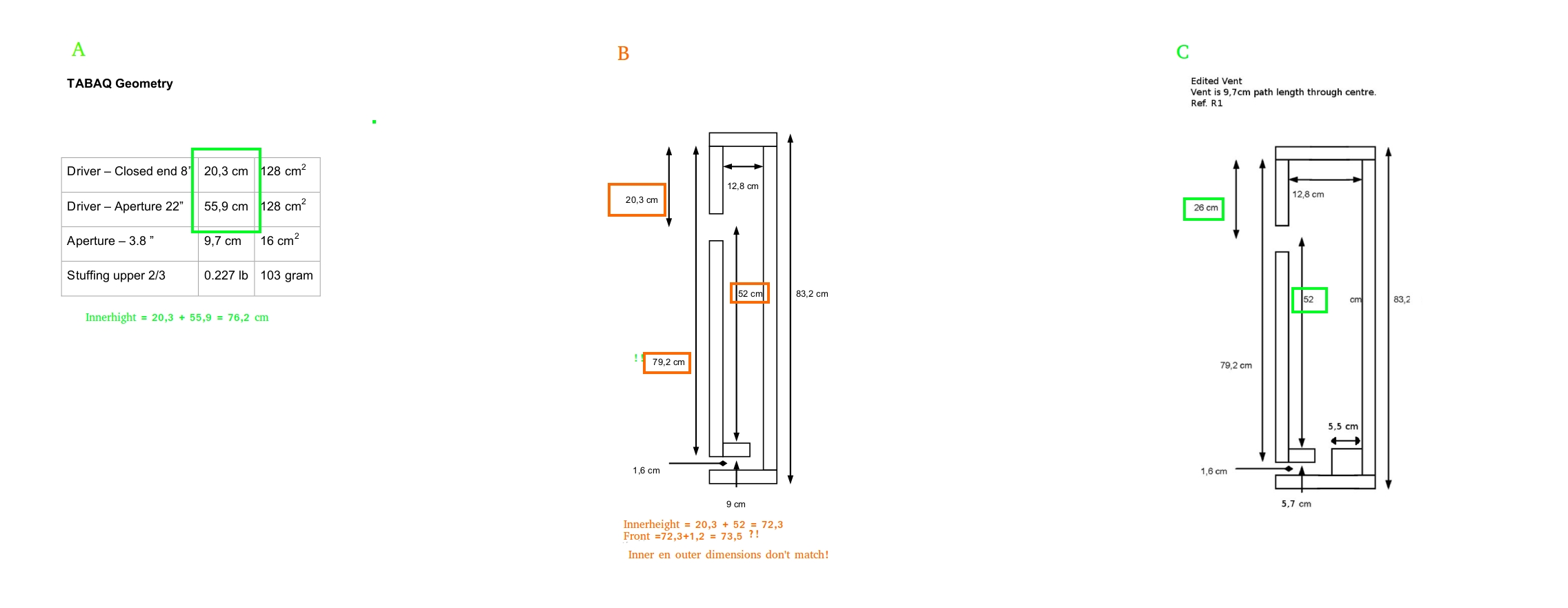

Mr Bjørn ,
I am trying to make a saw-plan for my cabinets but the information in your doc "Tabaq update" isn't correct!
According to the drawing "TABAQ Original" the front panel is 79,2 cm so the innerheight is 78 cm, but according to the table "TABAQ Geometry" the innerheight is 20,3 + 55,9 = 76,2?!
In the drawing by robskillz the inner en outer heights are all corresponding but it is based on a innerheight of 78 cm!
Could you clear this up?!
THNX

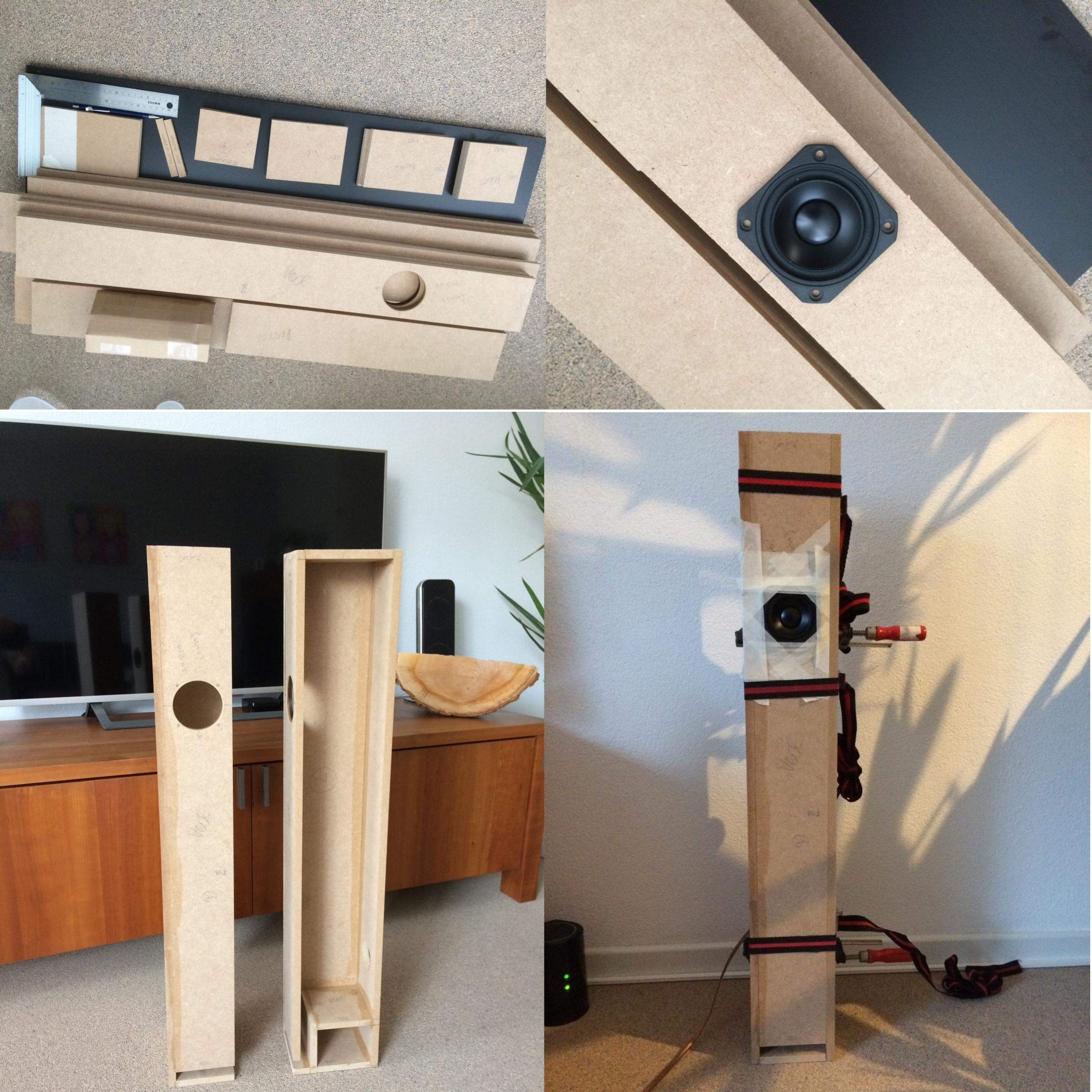

Pavel,
I really like your model B the "Tabaq Extended"
I was planning to make a Tabaq with a "feet" filled with sand to put the driver a bit higher. With your desgin the "feet" is integrated with the port which is much easier to build 🙂
Have you already finished your speakers?
THNX
Harry
Hi Harry,
I'm afraid it will be a long time. Today I sawn material, but only for the OSB – for test of sound and quantity of wool. Final loudspeakers considering combination of wood and concrete (only estetic reasons). Then will be followed by attempts to casting (concrete must be quite a long time to mature) and bonding of concrete with the wood. If it will be going to lead by my wish, I will add here some pictures, but I´m afraid it will be a long time unfortunatelly.
Bye Pavel

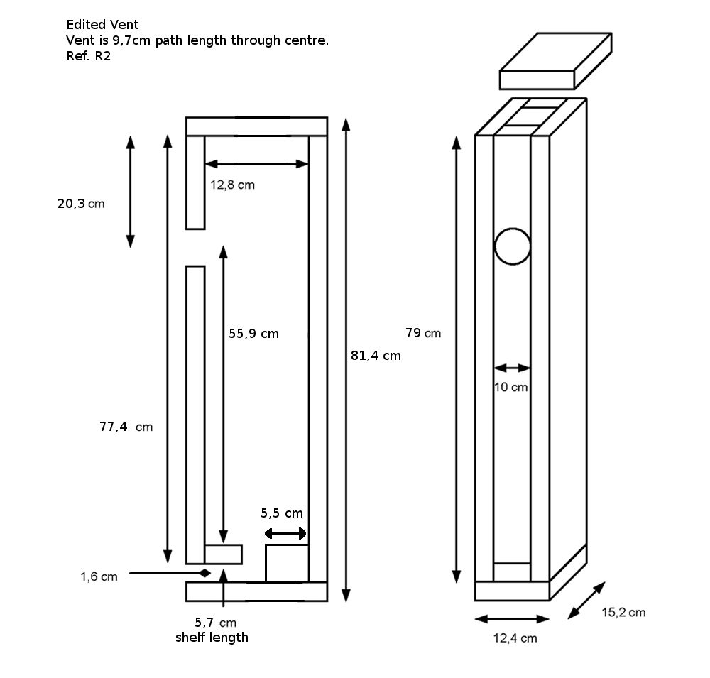

Hi Mr Bjørn
I think your document "Tabaq update" (page 2) doesnt contains the "final" drawing by robskillz:
- Post #1364 ref R1
- Post #1369 ref R2
The ref R2 -drawing is based on 30 inch innerheight and the port of 9.7cm!
So this shoud be the correct and latest revision of a plan for a Tabaq with a 3 inch driver!
Correct?
Thanx
Harry
TABAQ Drawing - the original
Hi Harry
Post 1369 is showing the correct port dimensions for a 3 inch build, so you are right.
The original, which I have enclosed, has a slightly longer port which is lowering the tuning a little compared to the sim. For 4 inch drivers this is not an issue.
In real life I am not sure there is a big difference. It was a shortcut I made to make the construction easier, and I lived happily for years with the 3 inch driver 😀

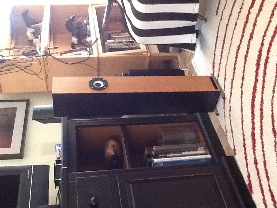

Bjorn, your design is amazing!
I am rather new to the speaker building scene. I have done a whack of research even before I attempted my first build. I actually stumbled across the TABAQ design while doing a website search. I am so glad that that happened! My first build was the 3” version, and I did the original BCS. The speakers sit about 400mm away from the wall. The sound is amazing and the sound stage is unbelievable! I have had nothing but astonished comments. I used the the TB W3-315E driver as it was on sale at Parts Express. I run my music for now through IQaudiO’s Pi-DAC+ and then a small T amp. But I am going to soon upgrade the amp to IQaudio’s Pi-AMP+. I use the MoOde app.
All very happy with the outcome.
But I had so much fun with the build, I really want to try a 4’ build. I have chosen the TB W4-1337SD as a possible candidate. But I question this as the QTS is lower than the W3 I used originally. The specs for the driver are as follows;
FS 70Hz
QMS 1.51
RE 6.8 ohms
QES 0.49
QTS 0.37
VAS 0.17ft3
CMS 1.05mm/N
BL 5.37 Tm
Mms 4.61g
Xmax 3mm
Sd 57cm2
Another couple of questions are; the stuffing can be lowered to 70g? And if I place the speaker the same distance from the wall should I use a BCS? I have no way of figuring this out software wise right now.
