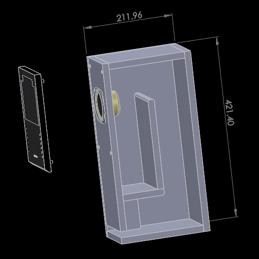

Bjorn has kindly provided a sim for a slightly modified version of the TABAQ, and I have done some drawing and made a folded version. One question I have so far is: have I measured the line length correctly? See the attached pdf, I measured along the dotted line, with sharp corners, is this correct?
Any thoughts from anyone on this? I will post more details of my plans soon.

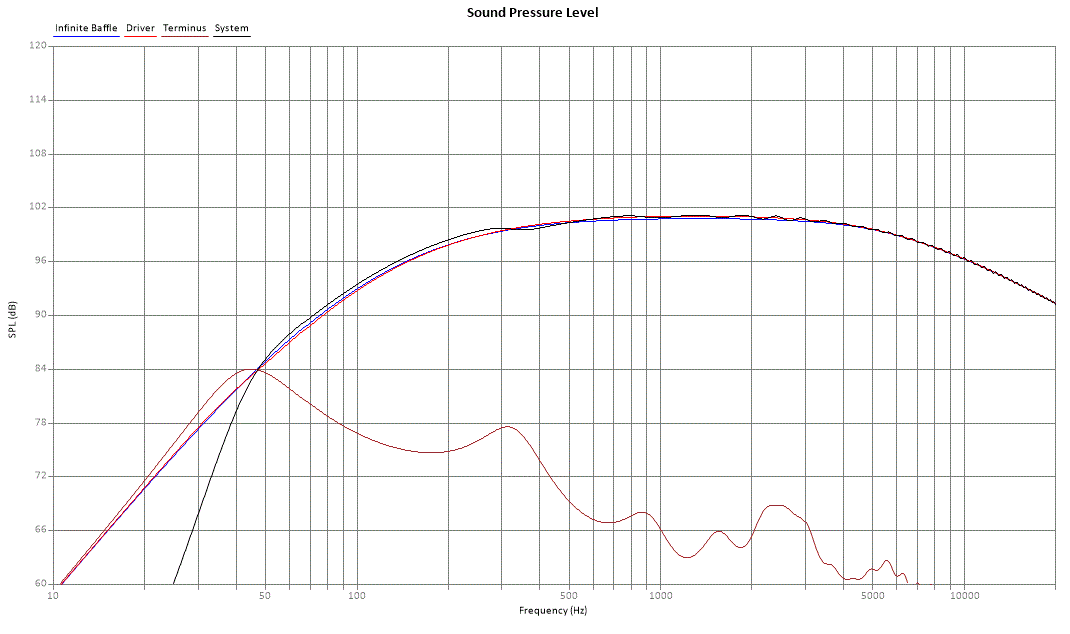

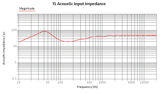

Sorry, I didn't have time when I first posted to get together the rest of my bits. Here is the sim Bjorn made for the 3FE22, and a more detailed drawing.

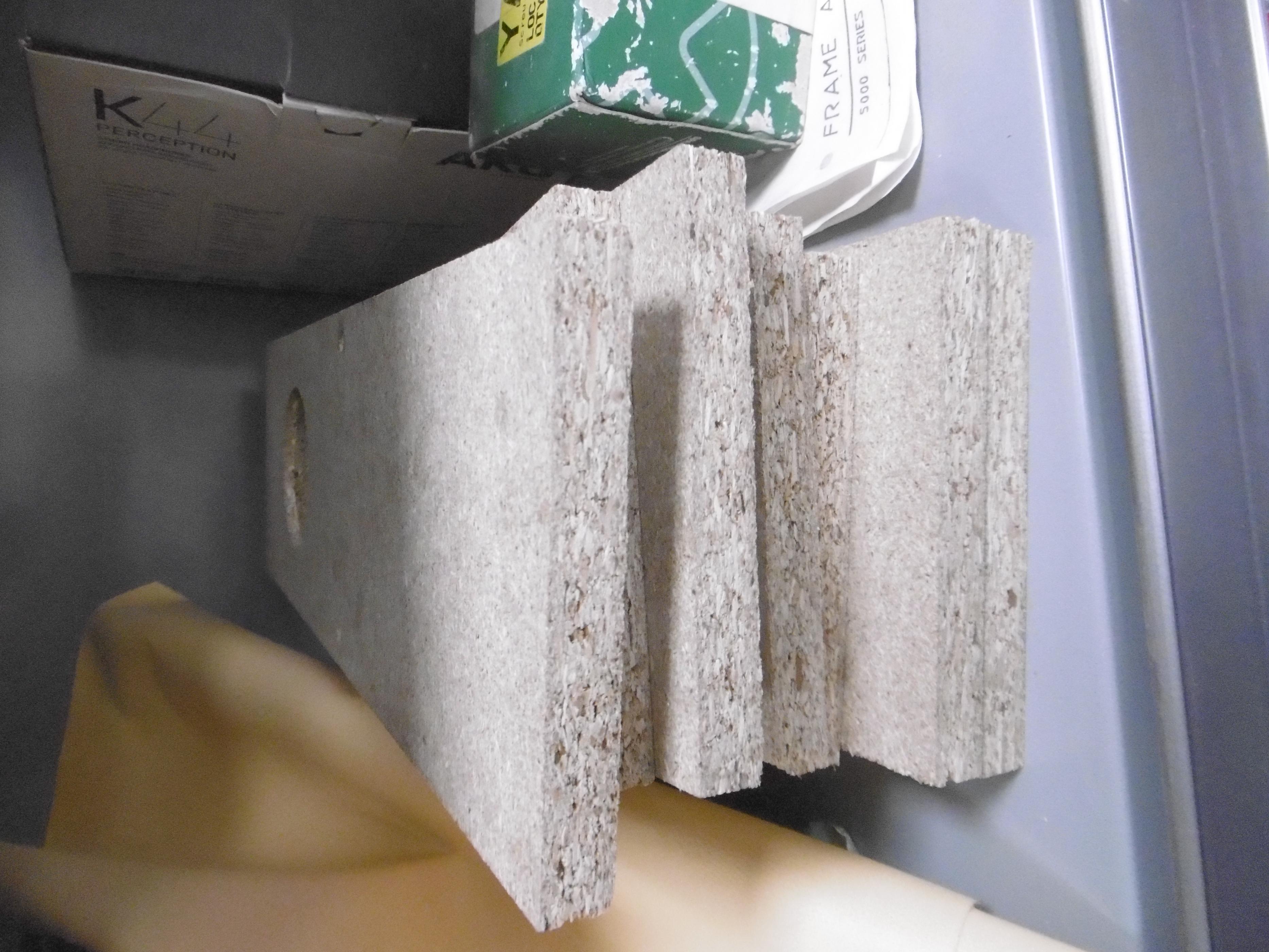

The material will be 15 mm particle board that I can get any amount of from pallet cover sheets at work. This stuff seems perfect for speaker cabinets, very dense. Of course, once I get a design I am happy with, I will make the sides out of ply, or glue on a veneer, or find some way the make them look nice, since my goal is to achieve a low cost (less than £100 including the free wood, hopefully) but fairly good sounding set of speakers, possibly with a good amp board built in, that I can replicate for friends who enjoy good sound without filling up their living rooms with massive boxes. As far as I can tell, the 3FE22 is a perfect driver for this, since it's price/performance ratio is very good. Has anyone found a better driver in this range? I haven't ruled out going to a 4 in. full range driver for a little more bass, but using a 5 in. one will just make the cabinet too big, I think.
One thing I didn't put on the drawing is that the width of the cabinet is 145 mm, with 15 mm wood and 5 mm dadoes the inside width is 115 mm. This is purely because I have a pair of front grilles from a set of cheap Sony speakers that I want to put on them, so I matched the width. Will it make much difference what I make the width (obviously it needs to fit the diameter if the driver)? I also am wondering if I measured the line length correctly, maybe with these additional drawings someone will be ably to tell me.

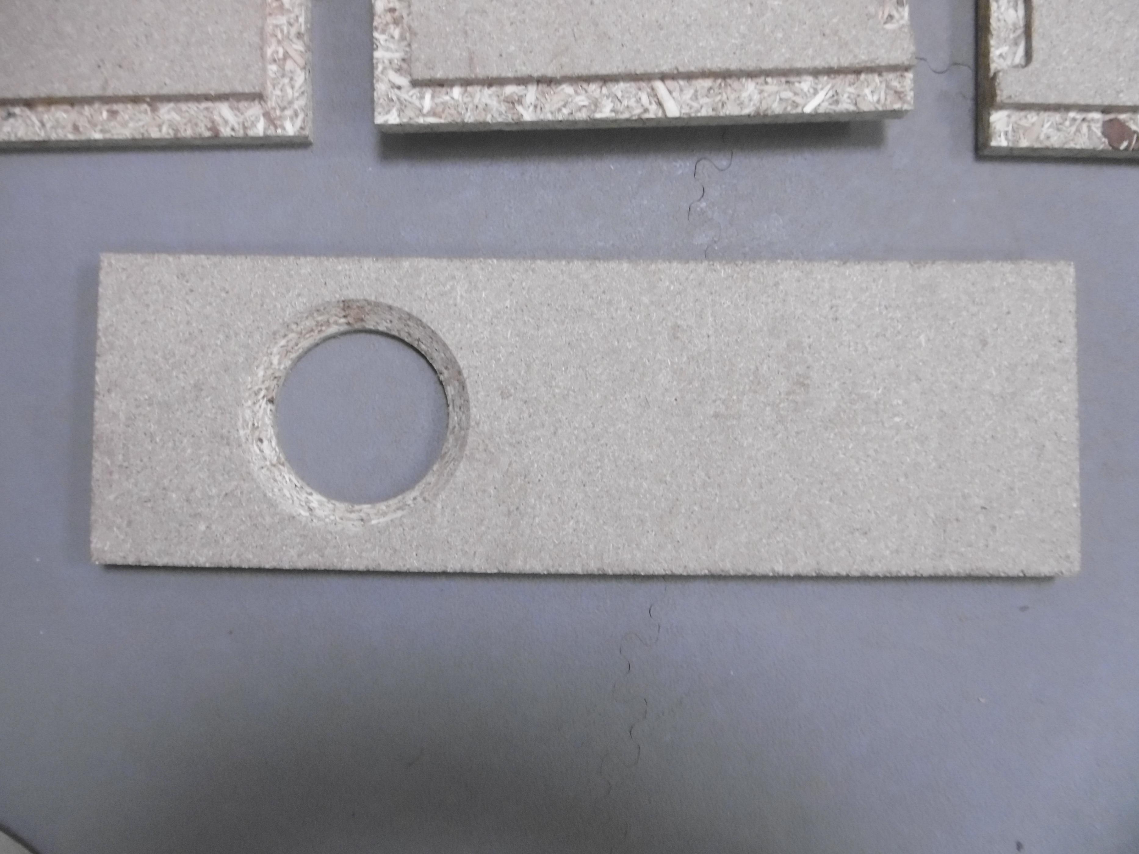

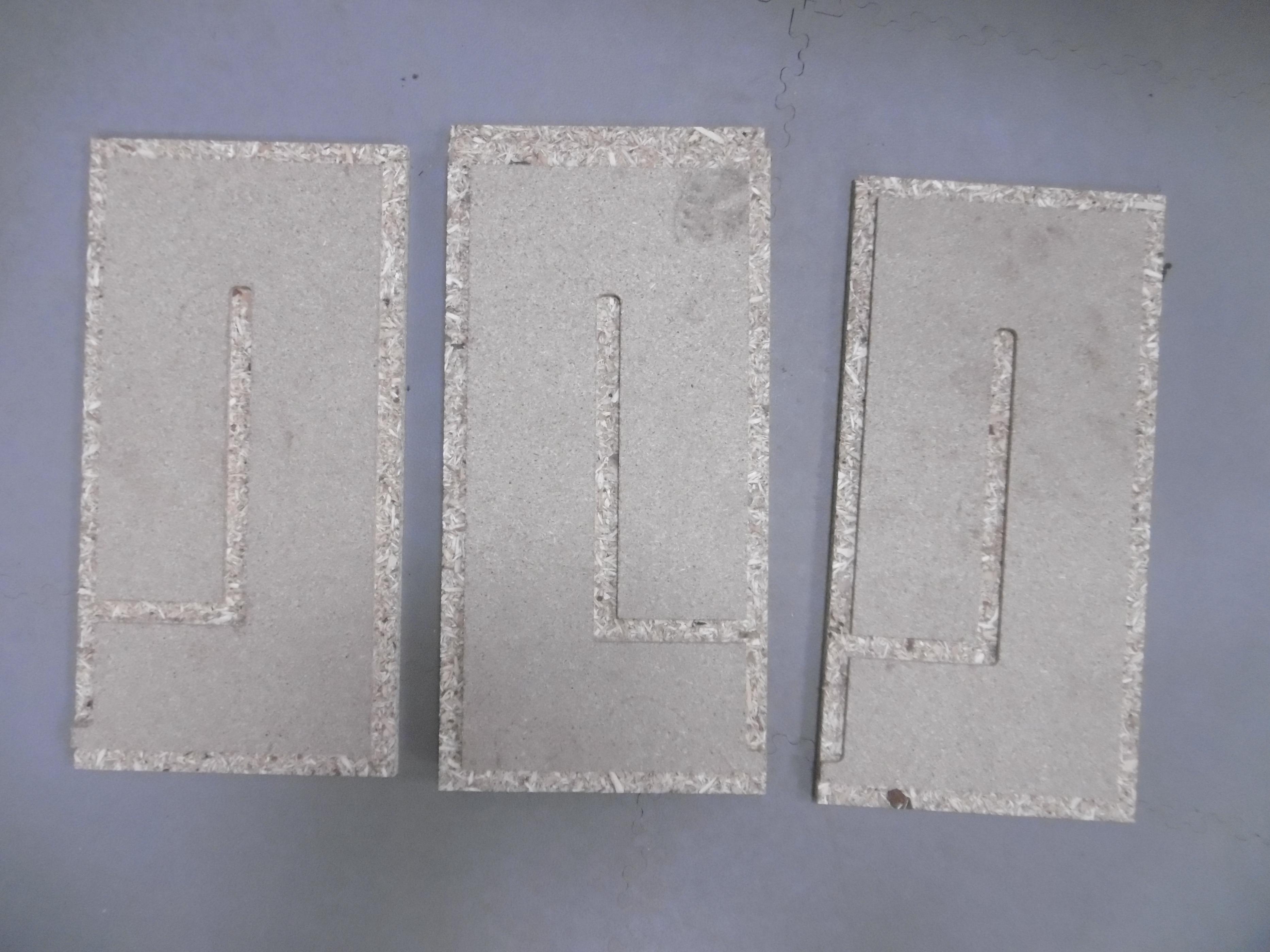

Some pics of the parts, since I had them near a camera

I have gotten around to putting Bjorn's sim in the Leonard Audio software, and I am puzzled by the differences between the graphs from LA and the graphs in the sim. I have attached some screenshots, why does the enclosure seem to peak much lower, below 50Hz, in the LA plot? And why is the response much more curved? I was hoping I could get LA to match what comes out of the MJK worksheets, so I could trust it, since it is so simple to use, but this isn't helping. What am I doing wrong?

I am also hoping that someone can set my mind at ease about the question I asked in my first post: in my folded design, have I measured the line length correctly? See the drawing that I re-attached to this post.

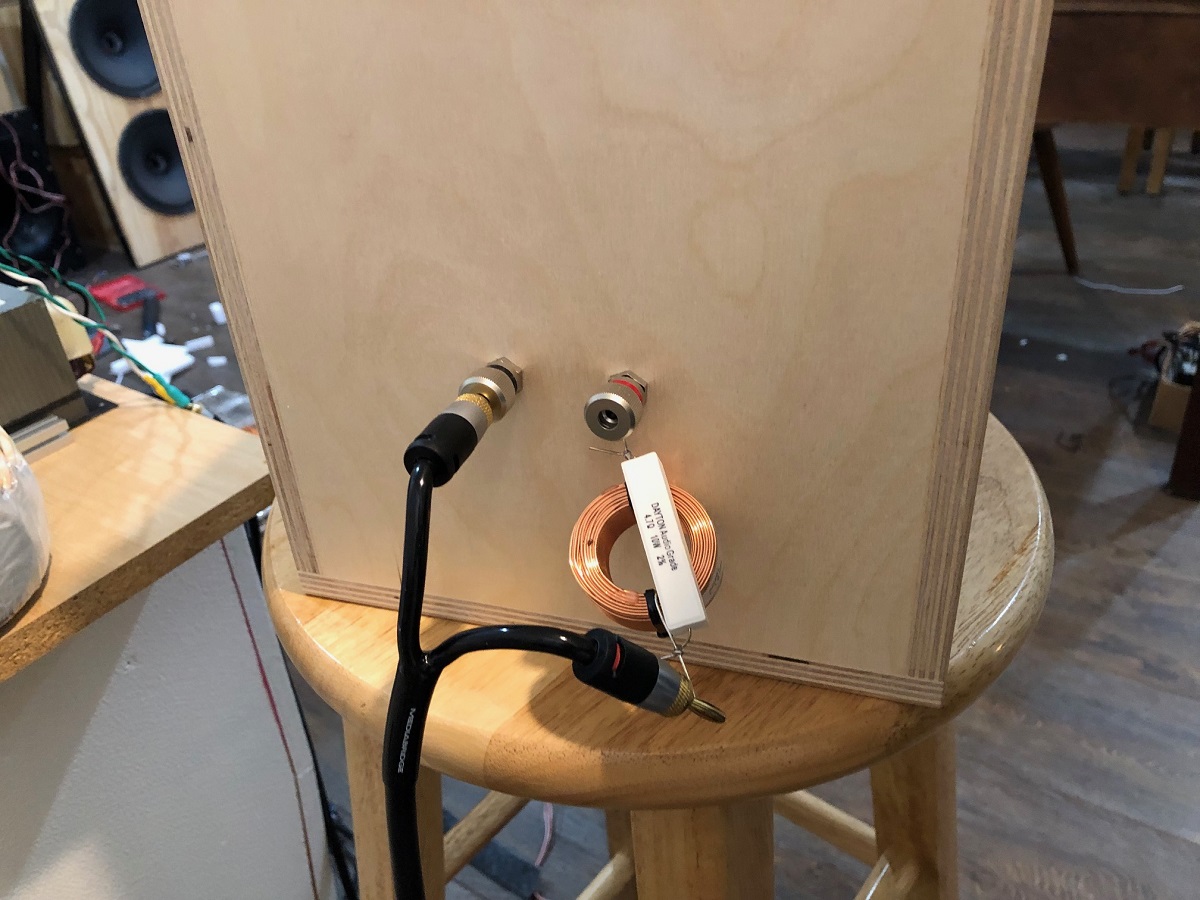

For an 8ohm TABAQ use 1mH and adjust resistor anywhere from 2ohm to 10ohms to taste. Get several resistors in 2ohm, 4.7ohm, 6.7ohm, 10ohm, 1ohm and use alligator clips to adjust BSC externally until you like the balance of the sound. Then solder it and install internally. The 1mH 20ga aircore works well. In a pinch, a cheap ($2 a bag of 20) 10mm x 8mm ferrite core radial lead inductor rated for 2A will work fine. I have used one for years and can’t really tell difference when switched to $10 air core copper coil.

As an example, here is me adjusting BSC externally on my W5-2143 XKi until I liked what I heard.
