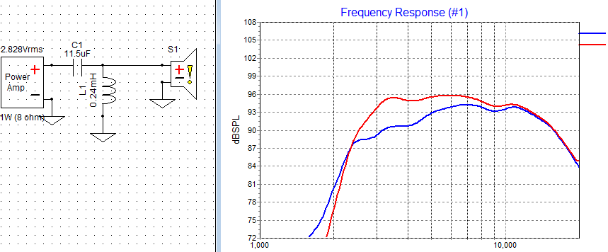

Example. Notch filter most appropriate?
jbl_resp-png.1010543
One could try crossing at a point where the driver response can be integrated into the desired target response. For this tweeter it looks like a 4-5kHz crossover point would be a decent halfway, if you can stretch that far. Or a wideband notch if you need to cross at the usual 3KHz or so.

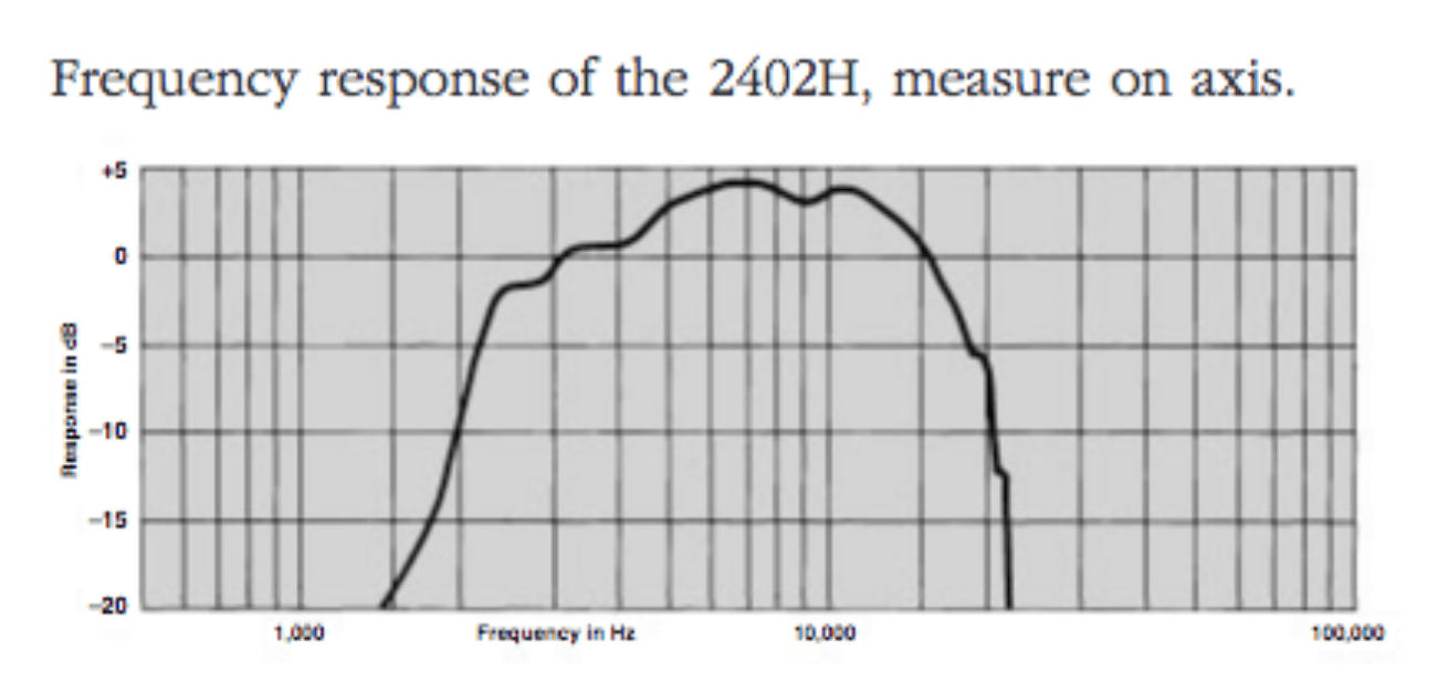

It is all too common to find the JBL 2402 Bullet tweeter needing attenuation when used in a domestic speaker system . It is efficient and directional and if it is not correctly matched in sensitivity to a midrange plus bass speaker combination it can be an uncomfortable listening experience. A 4-5 kHz crossover freq. is a very good suggestion for this horn tweeter.
The 2402 H was commonly used in JBL systems in conjunction with compression drivers such as the 2441 in combination with a short horn such as the 2311, for example. Since there is a strong resonance at around 2.2kHz approx. (Fs) for the bullet tweeter, the higher that the xover freq. is set, the less likely that the resonance will intrude. By memory 7.5kHz was my preferred number. I have no idea at all about the speaker system that mashaffer is intending to put together or to what purpose he intends to use it for. Perhaps he could supply more information.
Thanks for the responses. The tweets I actually have are the classic 075s. This plot is the closest match I could find. I had thought about a three way using something like these high efficiency midranges...
https://www.parts-express.com/speak...ofers-midrange-speakers/nominaldiameter/6-x-9
...and 15" woofers but I am beginning to think in terms of a two way with a pair of 10" high efficiency mid woofers (Like Eminence Betas or similar) and use a sub. Since the intent is to drive them with a SET there is not a need to drive them at high power. Likely the highest the woofers can be pushed is around 3.5K. The graphs for the new China Dayton pro 10s look like they can go higher but I am skeptical.
So in any case the tweets will need to be brought down by at least 6dB to match the woofs. If I can get the tweets fairly flat from 3.5k to 15k that will be good enough. While I save up money for the woofs and the wood I thought it would be good to see what I can get out of the bullets.
The goal is to get as close to 100dB/W system as possible.
That's about as perfect a tweeter frequency plot 3kHz to 20kHz+, as anybody could ask for.
