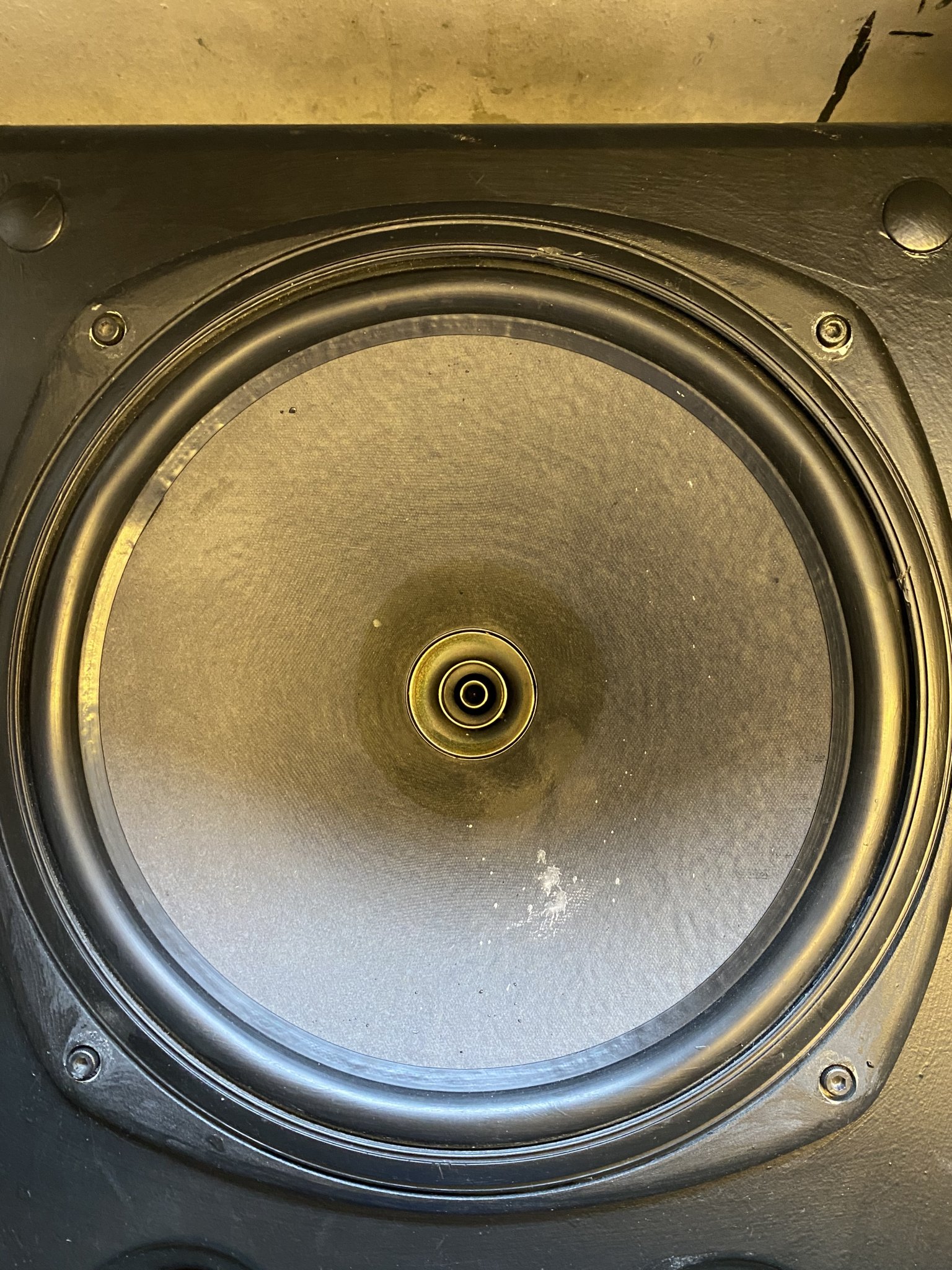

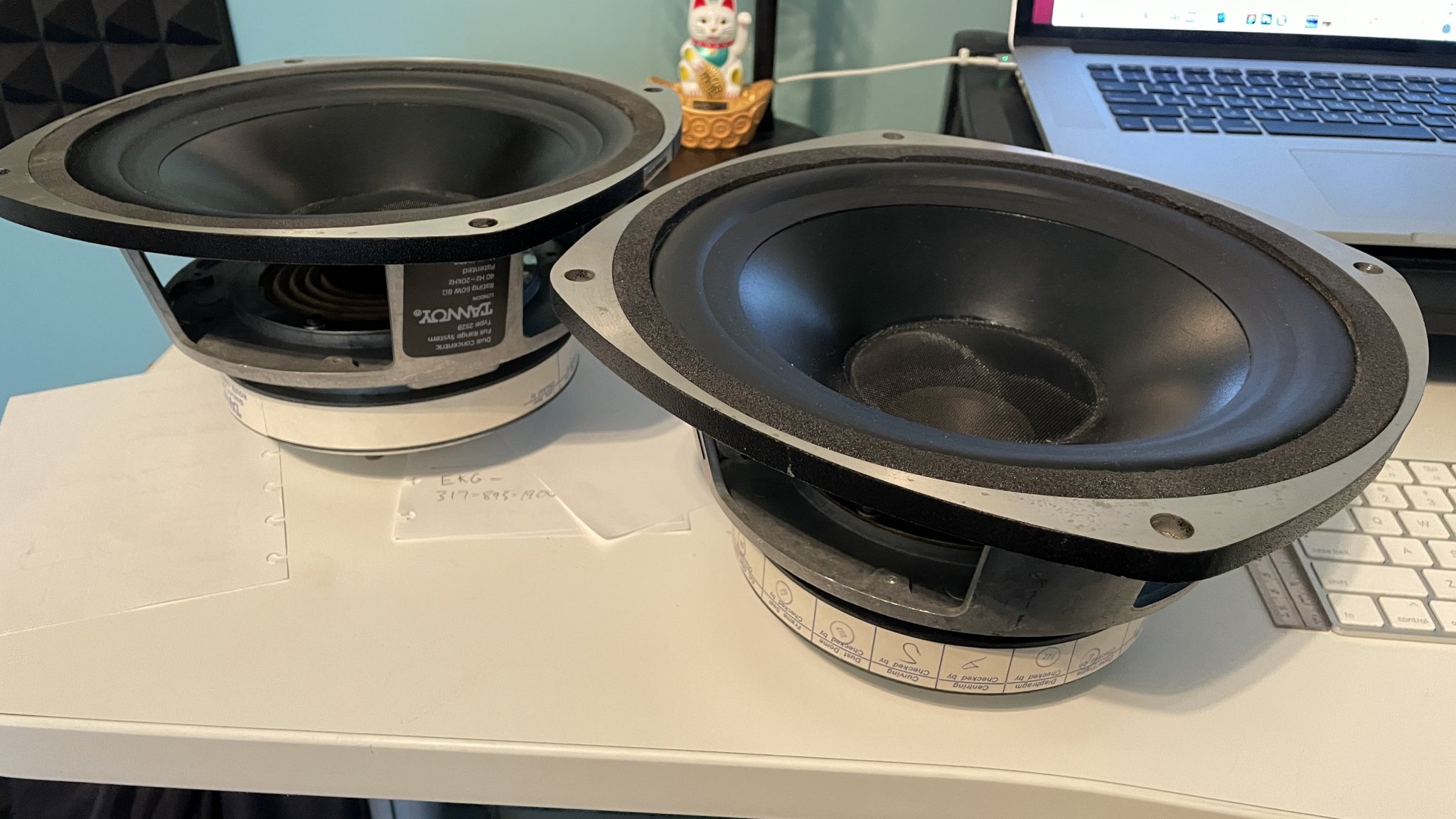

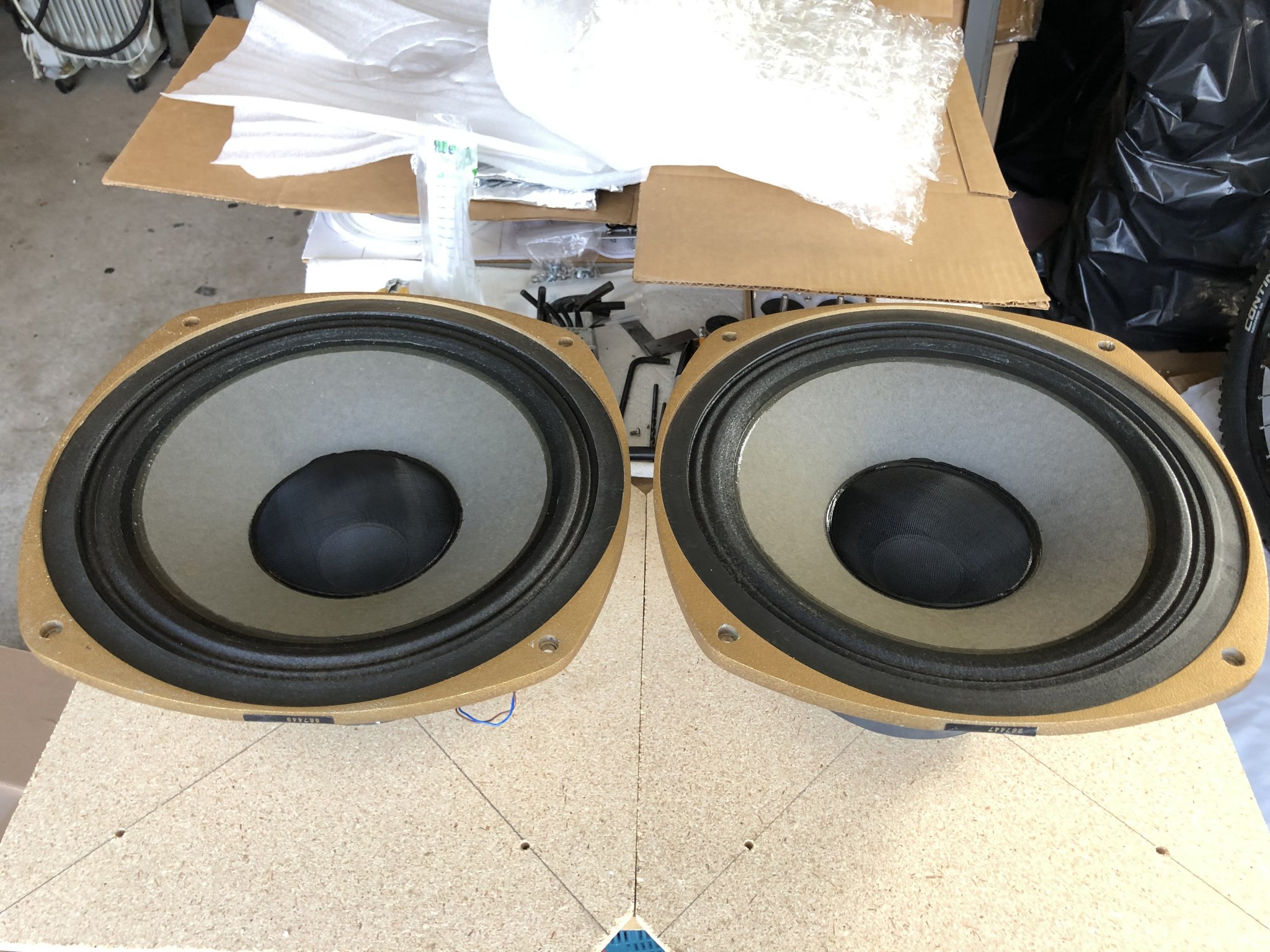

So, sometime in January I bought these classic 30 year old Tannoy CPA12’s after MZM identified the hidden treasures within: Dual Concentric 12-inch 3134’s. To top it all off, MZM has a ML box for these fitting my living room perfectly. And the price was unbeatable @ 500 dollars including an extra tweeter.
But, surprises kept coming. These pics show the drivers upon arrival at my house. Notice the baskets have been painted, and this had been spilled onto the surrounds and in some places also onto the cones.
One of the drivers have had a party with a lit candle. So, these are just to share with you my first impressions.
After a quick listening test I determined these drivers needed more attention. MZM has been my teacher all along, and I his padawan.
Later I plan to post pics and descriptions of my work. I can allready say that a cracked magnet and off centred throat/top magnet assembly had to be dealt with
Sharing to help others and perhaps motivate to buy these robust classic drivers and fix them up properly. All it takes is time. Nearly finished, but at least 40-50 hours have been spent allready.
These sensitive drivers sing well with First Watt power specs, and Papa loves Tannoy’s too. So for that reason this is posted in the PL section, where the greediest of boyz reside.

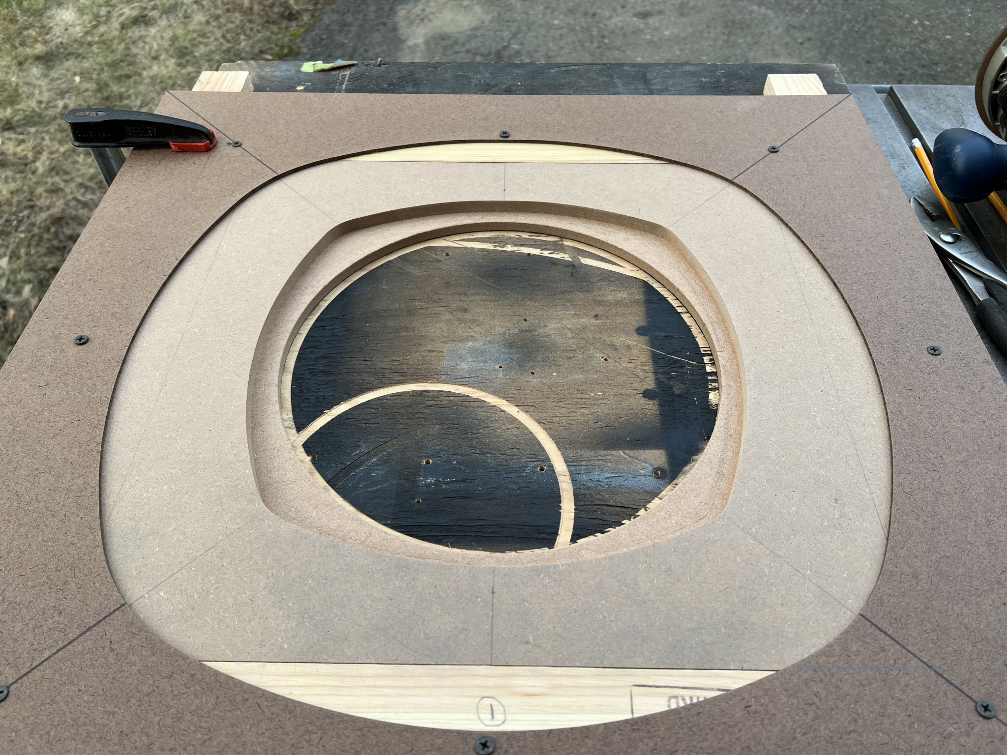

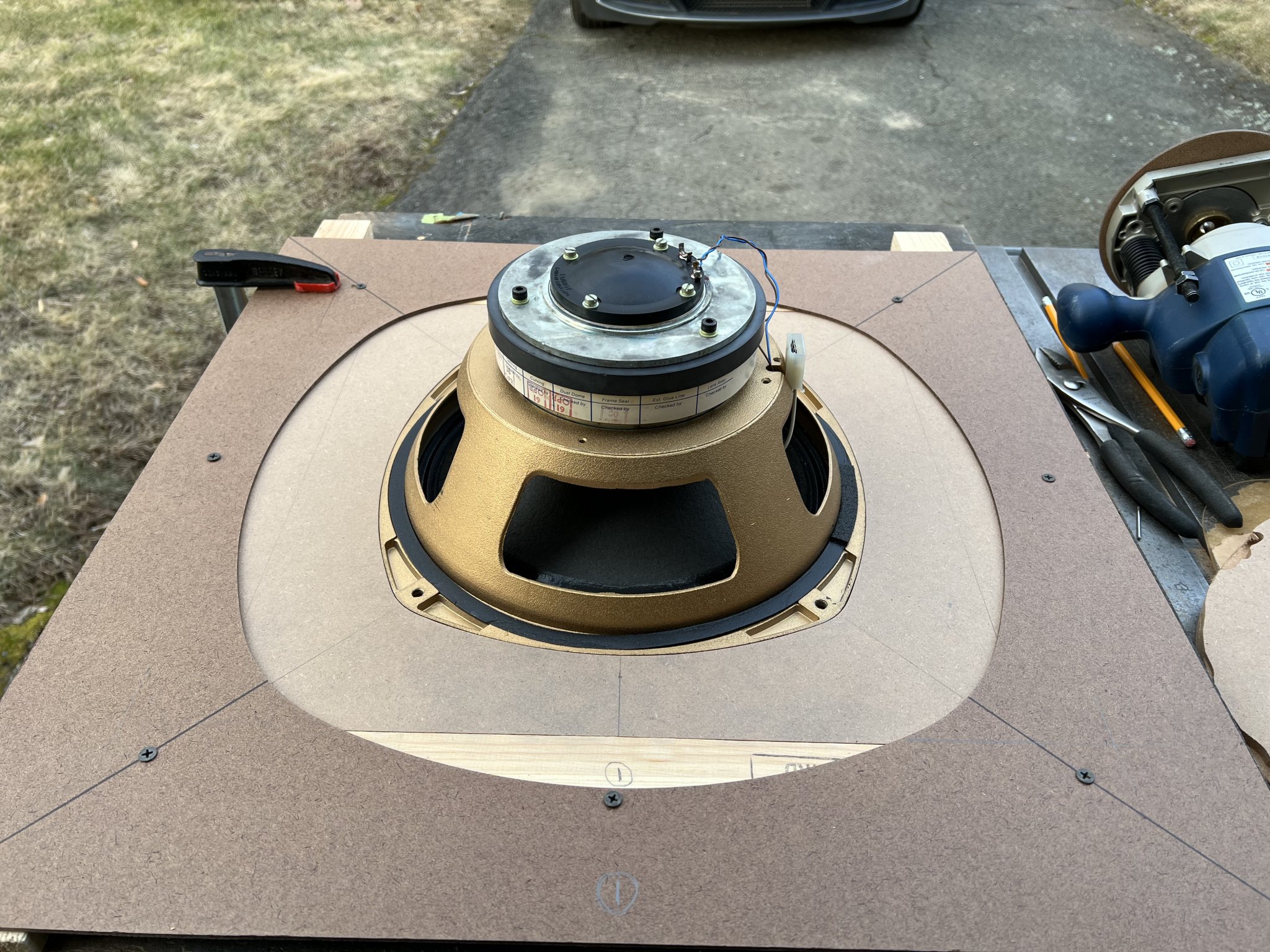

MLTL is hopeful future plan…I was a little reluctant to tear apart the System 15 DMTii I scored as I was enjoying them so much.
Instead I found some K3149 from LGM that were serviced and
surrounds replaced.
Currently working on baffles for them as first stop will be open baffle with AE 15 Dipole below to break them in and afterwards take measurements with DATS to see where they are at.
I’m hoping to build the MLTL with a removable baffle and in a way that it can be retuned to either driver.
Eventually I will want to go through the DMTs thoroughly and try them.

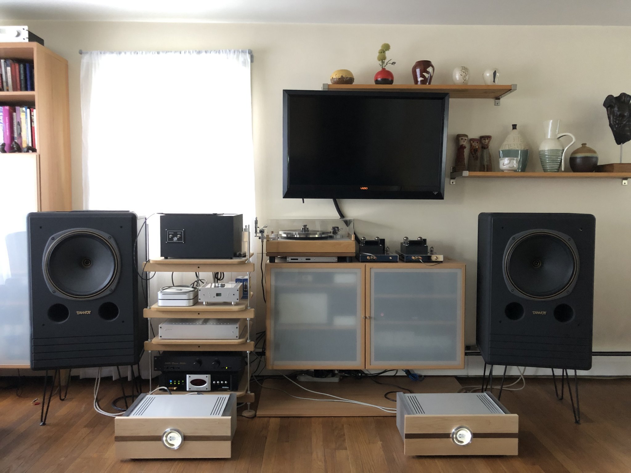

If it helps they went to a good home, they're in pride of place in the main system I've built this year when I changed countries to the UAE. They sound great in some interim Tannoy Chatsworth cabs and at some point I'll do some custom ones for them.

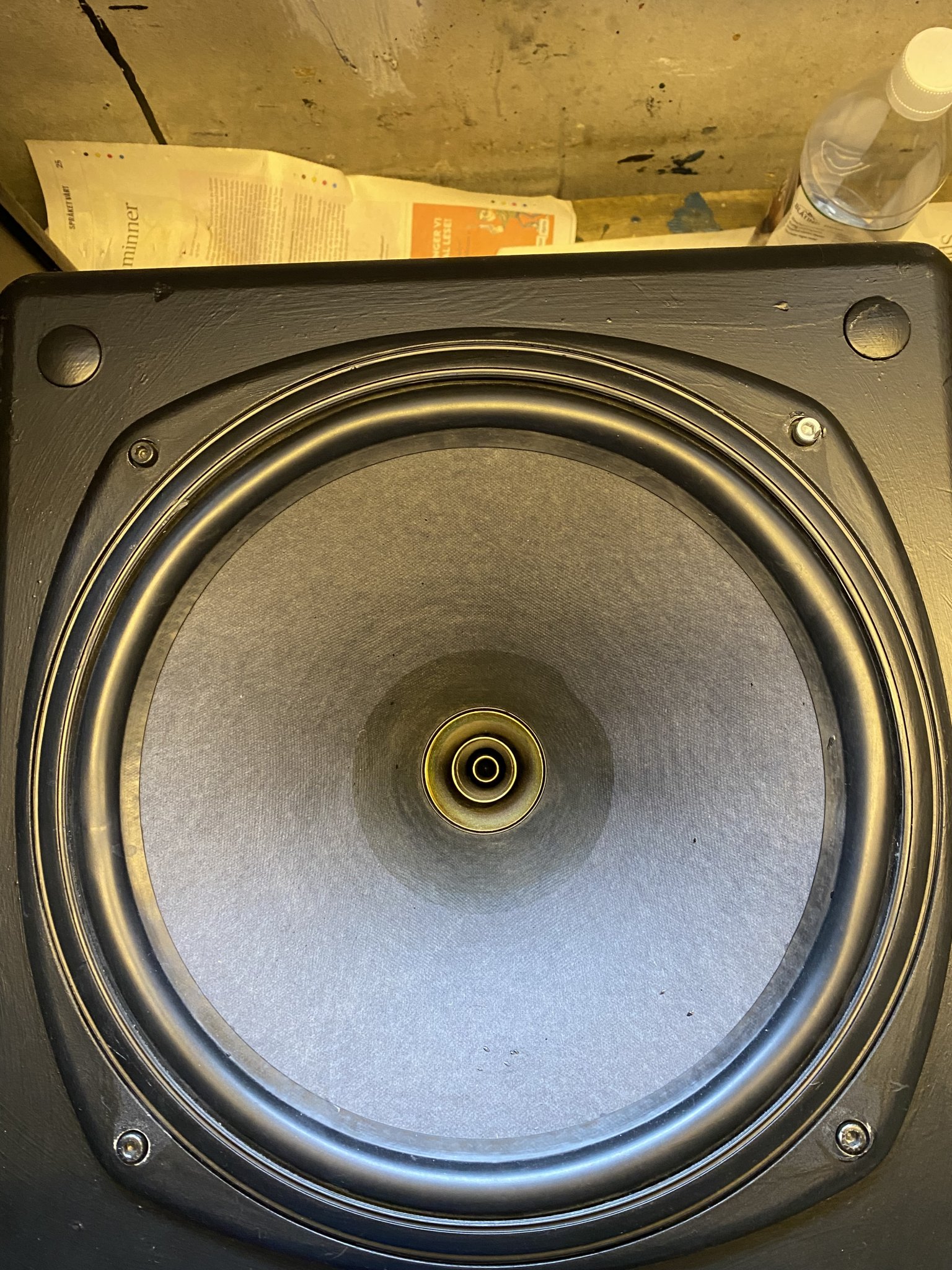

Continuing in the name of the thread: part of aim with thread is to motivate amp builders to get some of these old drivers, and refurbish them on your own. Nothing is impossible, and we will later see some examples where I almost gave up.

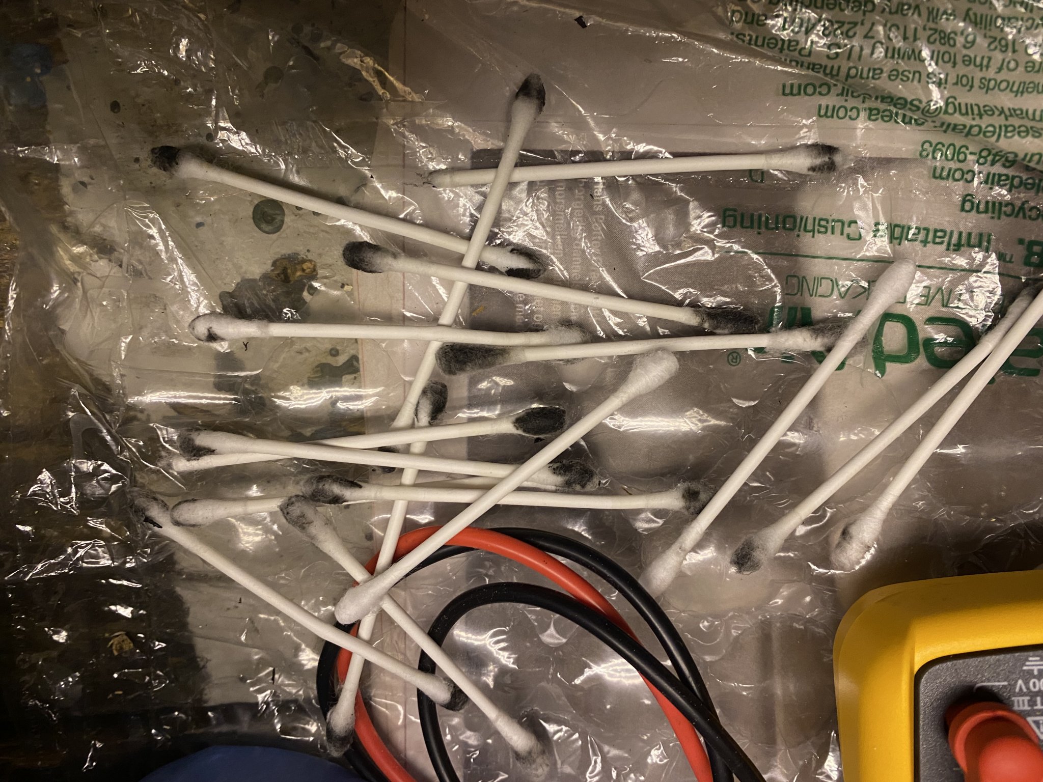

Attached is a before and after pic of the cone of driver A (called as such from now on). How was it achieved?
Well, four days of carefully scraping and then rinsing candle light reaidue with q-tips and isoprop. Carefully avoiding oversoaking of the paper in the cone.
Then, once removed, I continued with the surrounds. They were pretty soaked in paint, making them stiff and hence likely affecting Fs (stock 37hz). Did not measure Fs before cleaning, but after cleaning Fs measurements around 30hz blank showed these rubber surrounds are still good to play These were cleaned with isoprop, q-tips and cotton swabs, for a long time
The paint residue on the cone was scraped off, damaging the top of the paper surface just a tiiiiiny bit, but no matter: three coats of Dammar made an even and nice surface again. Two coats are for sissies.
Tweeter replaced too, with original part since I myself managed to damage the VC of the stock diaphragm. No matter, will fix it later.
Remaining work on this driver is spraypainting the basket top and basket plastic protection ring.
Woofer impedance 5R, tweeter 3R8.
This was the really easy driver, it turned out.
