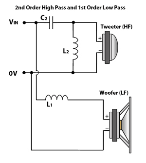

So, we have C2 = 6.8 uF; L2 = 0.42 mH; L1 = 2.85 mH
Putting those values into a simple Butterworth crossover simulator gives a crossover frequency of 2,750 Hz, so the measured inductor values would appear to be reasonable.

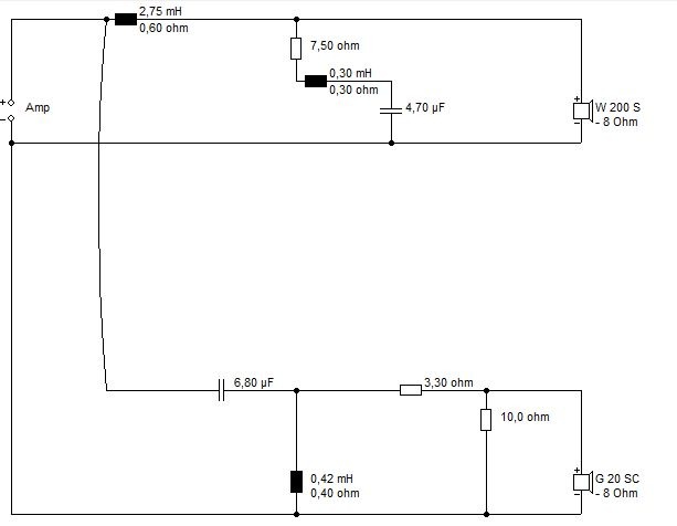

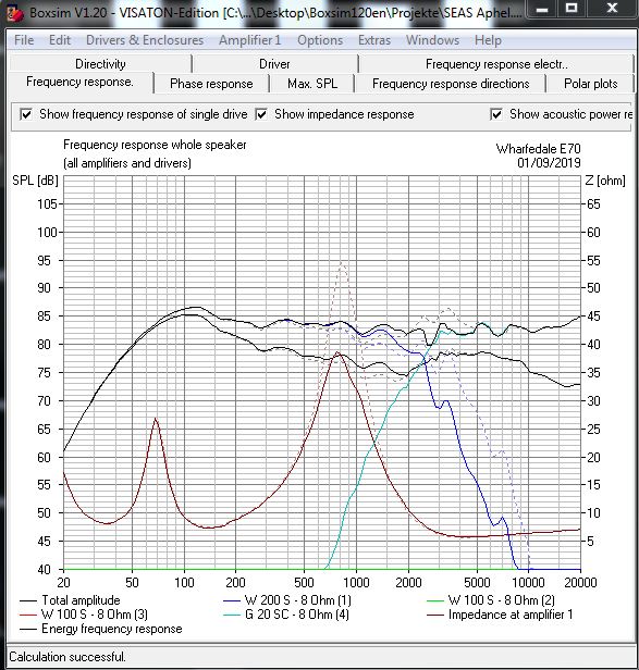

I was simming this in a rough sort of way:
I still like the idea of a shunt LCR or even just shunt 7.5R and 4.7uF as impedance correction. I tried the Tannoy circuit (dotted) and the one with some extra.
Shunts on the bass surprise by lifting the midrange.

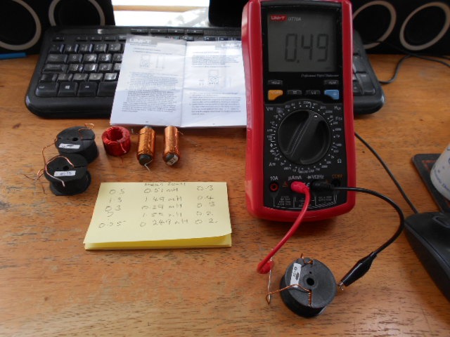

Air core: 0.42 mH; 1.4 ohm; 0.3 mm wire
Iron core: 2.85 mH; 0.7 ohm; 0.7 mm wire.
That air core is abysmal, but you probably won't hear it. My Wilmslow Audio ones never go above 0.4R for aircore or ferrites. Ferrite multiplies inductance by about X4 for a given coil.
This 0.5mH measures 0.49mH and 0.3R. Probably 0.7mm. Always good to calibrate with a known reference first.
Interestingly it works quite well for speaker drivers too.
I measured an Elac 6" midbass at 5.5R and 0.418mH which makes it lowish inductance. A Visaton W200S came out at about 6R and 1.5mH, which agrees with it being a high-inductance woofer.
You tend to treat woofers differently depending on inductance. Think of inductance as bafflestep and rolloff naturally built in.
A Morel CAT278 1" tweeter came out at 5.2R and 0.174mH, and you can hear the 1kHz test tone when you do this.

I have already done it in the previous post. The dotted lines!
I know I'm going dotty, but I find it difficult to separate the signal from the noise!
P.S. The reason I asked is because in your sim you used made up values for the DCRs, not the measured ones we now have - does that make a difference?
@Galu. Just to indulge you I reran the sim. The coil resistances made very little difference. The tweeter coil at 1.4R let a tiny bit more low frequency in, but hardly worth losing sleep over.
