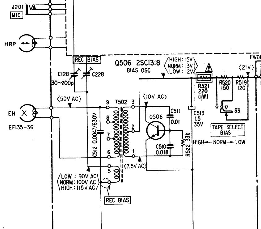

Have a look at few service manuals for older cassette decks to see some simple circuits. Many used a special (purpose built) transformer such as here. If you got an old scrap deck you could find the circuit and copy the oscillator.
At the risk of sounding totally nutz
and depending on quality you want there is also DC bias... doesn't come any simpler than that. If you are only experimenting and want to get something up and running and are just trying stuff out... well it might be an option.
Nice to see you again mooley, thats extremely similar to the marantz PMD 222 that I have, I just struggle to understand it (and then the whole proprietary transformer thing).
I would like this to be high quality, but I may look into DC bias just to mess around with for now.
I forgot to mention, I want to build this unit to run standard cassette tapes (if that makes any difference to the complexity of the circuit).
The centre-tapped primary of the transformer inverts 180 degrees at its resonant frequency, the transistor in common emitter also inverts, so a total 360 degree phase shift leads to positive feedback - the base resistor limits the power to set the level I think.
The supply is varied in this application to vary the bias level for different tape formulations. I'm not 100% sure what oscillator type this is... some variation of a Hartley oscillator possibly. I'm really not sure though.

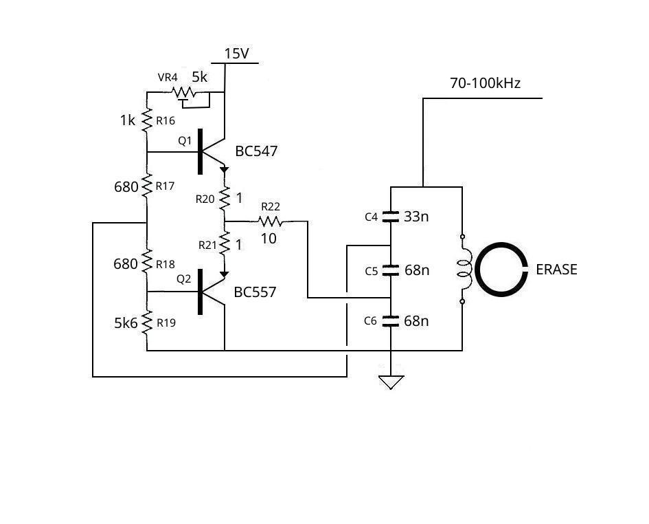

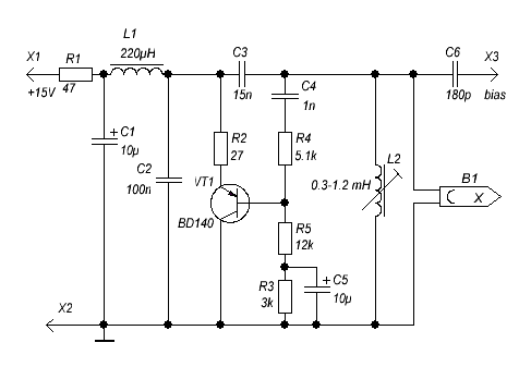

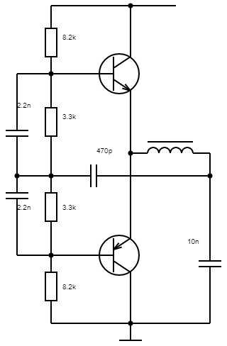

Hello! I used to work with a couple of simple BJT based generators for tape heads.
To offer something I have to know a bit more:
1. What about erasing head? Does it exists in your project and if yes - where it is powered from?
2. What is your supply voltage and how stable it is?
Hi Mas, so to be honest i am in the very early stages of this project. I really am trying to design a general purpose cassette tape delay that will work in any studio setting.
I would like the supply voltage to be 9v but if I will get better fidelity at 12v or even 24v I have no issues changing that. Lets assume I am building a general purpose echo unit running on the best voltage needed for a full transistor unit. I am ok with op amps and such but I would prefer to not hit vacuum tube voltages.
Should work with any head but you might need to trim the capacitors to get the correct frequency. For erase duties, signal also has to be strong, something like 30Vp. I can't tell if low distortion is a requirement here.Then the same signal can be used for bias but it has to be attenuated to a specific level for each tape type, so it should pass through resistors and caps hopefully filtering some noise. Then it goes straight to the recording head. The signal to be recorded on the other hand, is not sent directly to the head. It should pass through a so called "bias trap", an LC circuit that works like a notch filter and it's tuned right on the bias frequency so it won't allow it to modulate the audio circuit. The bias trap is not very sharp, it should filter a few harmonics. The principal of operation is that the bias frequency is significantly higher than the audio signal.
