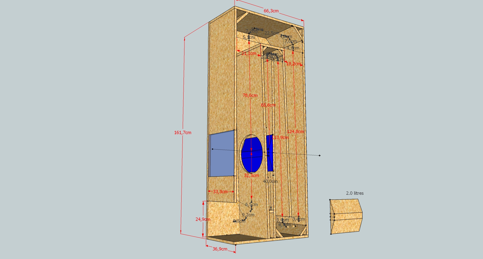

First off, here's the plans for my 'th-spud' clone, using a pair of Alpine SWR-843D car subs. This is the sub I've been listening to for a few days, which sounds great. The outside dimensions are 4' x 2' x 9.25". Six cubic feet.
Here's Volvotreter's clone of the TH-Spud. Mine copies the folding, except mine is mirrored, and mine is tuned higher.

![th-spud%2520w-alpine.jpg](https://lh3.googleusercontent.com/-W6MQqU_VPf8/UJafPuQikAI/AAAAAAAAEmg/qoK6wLtZWgM/s800/th-spud%2520w-alpine.jpg)
![TH-SPUD-0004.jpg](https://lh4.googleusercontent.com/-xaOo4wh7M6M/UJagNKvNRiI/AAAAAAAAEmw/LEQYslTeYxI/s800/TH-SPUD-0004.jpg)
