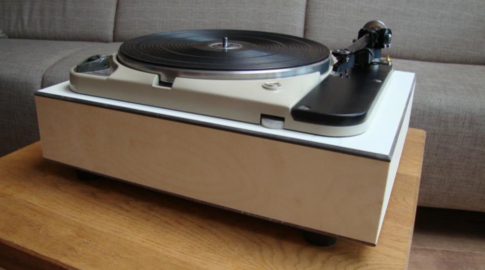

Welcome to the fraternity. I'm running a Schick 12" arm with ZU Denon DL-103-1 on my restored TD-124/II - I'm pretty pleased with the performance. Slate plinth should finish it soon.
looks cool a slate plinth.
A bit of perfection.
Is that yours Telemann.
No, it's from OMA's site, but I really like this setup, and have been in touch with OMA about the plinth. They ship worldwide, with no breakage. Kevin has that tonearm ... it's superb. OMA's solution, with the tonearm mount separated from the chassis of the TD124, ensures a serious reduction in mechanical noise transmitted to the arm. I've seen measurements of 15dB reduction.

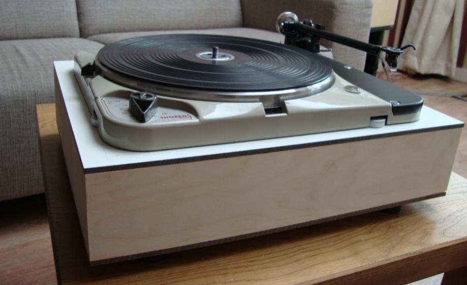

This one is mine, I had it painted in British Racing Green:
The turn table seems to be stored a lot and not used a lot. So I do not aspect much wear of parts.
Cleaning and oiling things will do until other wise is proven.
Well that is what I thought about mine too, disassembling my unit which had probably less than even 100 hrs of use showed that there was a lot of congealed lubricant in the motor bearings - and no amount of oil is going to fix that. The old bearings can be cleaned and reused if not worn, and the result long term is worth it. I'm by no means the originator of this pearl of wisdom, but I have found the truth in it - five motors so far. The motor should run much quieter and cooler with a proper service even if you replace no parts.
That arm goes along with the beogram 3000? Looks great minimalistic.

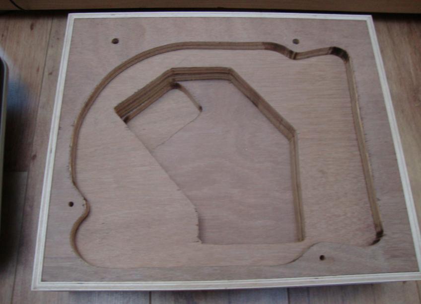

Here a picture of the massive bankirai inside. I will ad ventilation holes under the motor.

"Plinth" in English.. Looks very nice, assuming that you are definitely going with a 12" arm since I see no cut-out under the rear of the arm board.

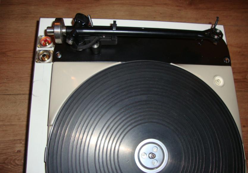

I will fit neutrick cinch bushes direct behind the tone arm on the top-plate to increase high end feel to it. And the hole for that have to be drilled soon.

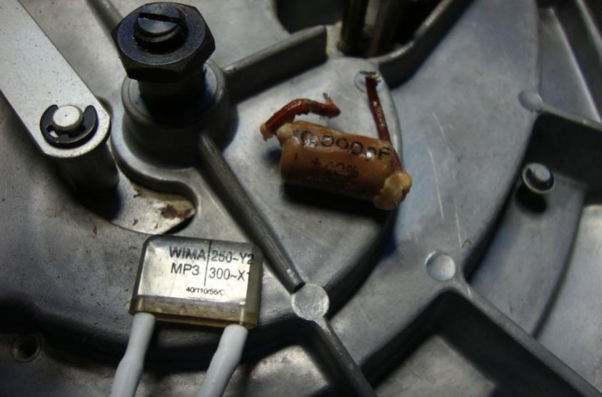

The main switch has a capacitor to filter of disturbance.
It is 10nF the one in the TT was blow I replaced it. The official capacitor to be placed between line and neutral is a X capacitor. The capacitors who are official tested for this function have a UL or CSA label and X capacitor text.
On the photo the defective capacitor is easy to recognize. The capacitors are often the cause for fire in electronics!

Also made the cut out for the cinch bushes near the arm to have the wires without extra connection direct to the bushes.
Van den Hul: MCS - 150 M
It enhances the high-end looks and funtioning.

Hello Helmuth
The picture of the capacitor seems to indicate that its value is 10 pF. It looks like the "p" is mangeled to appear like an "n". Correct me if I'm wrong.
Sincerely,
Ralf
On the capacitor I read 10.000pF =10nF. But the exact value isn't that important in this application. It will cause a bit leakage-current and it is placed over the switch.
