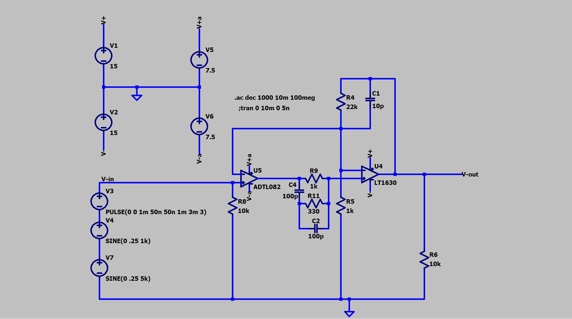

It will be interesting an amplifier made with separate op-amp and VAS-stage and two-three TDA7293 parallels output stages and a G-class power supply.
I made years ago an amplifier with 2 output stages and a G-class power supply and was interesting but I wanted more speed (8.4V/µsec was too slow for me) and I preferred full transistors amplifiers.
The questions is if is not become too complicated an amplifier like this.

Hello WLA what you have done seems to be a very different thing from what is being done here.
Of course nothing will increase the slew rate as long as the input-circuitry of the TDA is involved in anything but if the TDA is used in a composite amp it is the op-amp and its precision and low noise figure that become dominant as the TDA becomes "a tool" of said op-amp which is a lot faster and more precise . Plus you do not apply any more corrections in the ffedback at all since both the op-amp and the TDA are within the same feedback-loop.
On the other hand if we can use the op-amp followed by a fast VAS-stage and we only use the output buffer of the TDA ( the complete input and voltage amplification of the TDA are not used anymore ) then the only limitation of the slew-rate of the whole circuit is due to the output-buffer from the TDA which is probably higher than the rest of it , and the used op-amp so it could be a lot faster than the TDA itself . There are indications that the slew-rate of the TDA is limited by the ability of its internal current-source and sink driving the output-buffer ( pin 11 of the chip )

I got the idea!
You want to eliminate the slow voltage amplifier of TDA7293 and run the current amplifier by an op amp in composite circuit.
Is that right?
Is that right?
Yes that is the idea . I only want to use the output buffer of one or more TDA7293 , as they provide a complete output-stage with protection circuitry , and use a good op-amp as input and feedback stage , and a fast voltage-amplifier in between both , and then see what I get . In any case it would /will be a hybrid between a discreete amp and a chip-amp but combining the advantages of both worlds . That is more or less what my idea boils down to.
Imagine an op-amp , three transistors , 1xBC560 and a pair of BF469/BF470 , and three TDA , on a PCB of 100x50mm , Enough to drive a good subwoofer or a large 3-way box ......as with 3 of them in parallel one can use 48volt rails

I am still working on my circuit and do not know what WLA was working on , but anyway here goes . Just take a good op-amp input-stage using LM 49720 for example , followed by a long tail pair of BC560 with an emitter-degeneration and a current-mirror , about 220 ohm-resistors , to transfer the op-amps output to the negative railvoltage , then follow that with a complementary VAS-stage using any good pair of complementary transistors with 100V max , a gain of 50 or higher , like BF469/BF470 see datasheet , where the upper transistor is configured as a constant current source set to about 10...15mA , and inject the output into the pin 11 of a slave-configured TDA7293. Experiment along these lines , you can , if you want , take the vas of a well known and well performing discreete amp and copy it . Feedback from output of TDA to inverting input of the opamp . The closed loop gain can be unit provided the vas is compensated for high frequency so you atre not limited by the gain of the TDA , normally 20x minimum. this is aprox what I am working on.
What I am trying out now is a second feedback from the output of the vas to the long-tailed pair to linearize these two stages to the max. Then the over-all feedback , due to the extremely high open loop gain of the op-amp, should get me vanishingly low distortion as long as the TDA´s output-buffer functions correctly with rising frequency so it will help me to find out what the frequency-bandwith of this buffer without the rest of the TDA is , because both the op-amp and the vas will not be the limiting factor .
Hello Mike,
do you have news for us? Do your circuit work as expected?

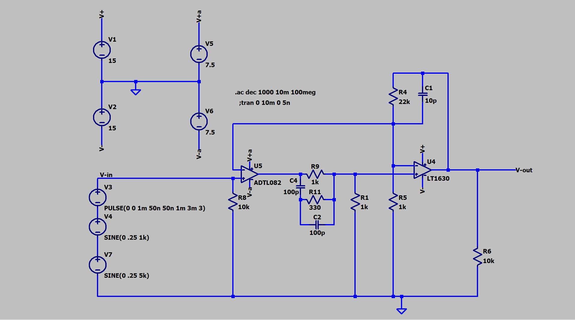

Otherwise here is some news from me, another circuit topology that does fine in simulation and needs a prototype to see if this works also in reality. This time i had an eye especially on the risetime of the ICs envolved. (Again this are only ICs that are similar in characteristic to the ones to get used in the real circuit!)
