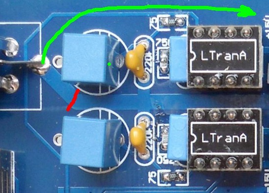

Taking a look at the layout there could be a common-mode noise problem in that there are a couple of 220pF caps feeding directly into the opamps' +ve inputs from a dirty ground (the output ground). So first things first, I shall cut the thick track along the red line and route the output ground back to the trafo (indicated by the green arrow).

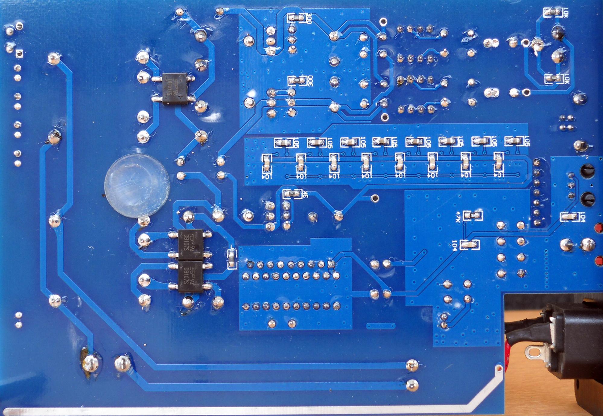

Over on the reverse side, the 10k loads are unnecessarily low (I take it they're to charge the output caps up) so I'll increase them to 1meg.

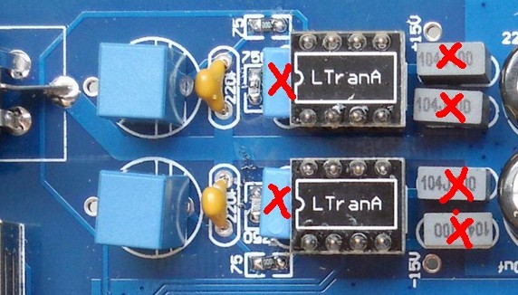

I've marked the caps to remove with a red X - the 2n2s are the blue ones. To the right are the supply decouplers (grey coloured).
I've lowered the supply voltage primarily to be able to get more capacitance out of the X7R ceramics - they lose a substantial proportion of their capacitance under higher bias. It also allows use of physically smaller electrolytics (10V rather than 16V) so its possible to get more capacitance in closer to the ICs. I also would like to experiment with biassing the opamps into classA - this will raise the dissipation so I prefer to minimize that by reducing the rails to what's really necessary, no more.
I think the purpose of having the 2n2s across the feedback resistors is two-fold. First to limit the slewrate and secondly to provide a bit of low-pass filtering. There's a considerable downside in SQ to having them though, which isn't expected under the normal ways of understanding opamp behaviour. I suspect it has something to do with putting glitches on the supply rails when they're present.
