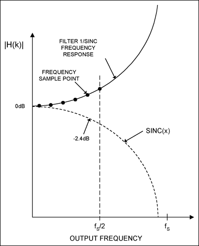

Go NOS, compensate for the sin c roll off:
[Best of both worlds, low f and flat FreqResp]

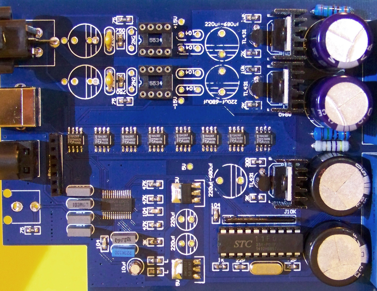

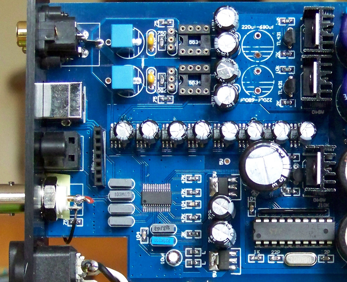

Here is my PCB, ready for some caps upgrade.
Matt, I can tell you the board is easy to work with.
I'll fit in what I have, Rubycon ZLG/ZLH, Nichicon HV, 10µF/35V X7R (will stack 2) and 75R BNC, OPA602 and LM6171 opamps. I had to buy the advised 15.000µF caps wich I don't have at home nor office. Cheap enough BTW. Opamps may need better choice of surrounding parts than the one really on the PCB.
Some questions still;
The analog supply for the CS8416 is pointed as critical for jitter in the datasheet, so that 10µF cap is worth being upgraded with something like an OsCon?

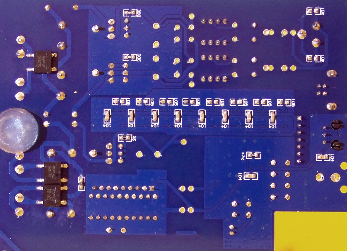

Each TDA1387 chip seems to have a 100nF cap on its 4/5 pins, under the PCB and still on mine, +5v supply, again something to be gained like the use of BG without such 100nF at each chip supply pins? That was done in the hot days of CDPs...
What about the sound of the output caps? Worth upgrading or decent enough (knowing the Epcos MKT in my Tripath amps I think they are good!), BTW I'll increase them up to 4.7µF as my preamplifier input Z is 10K...wich leads to a new question, what is the output impendence of this DAC? Are the opamps to be chosen with that in mind? Or with caps in minds? Do your bias at output (prior to output caps?) with DC is doing the magic on the caps (DC biased caps to avoid polarity change hysteresis?).
Will report after mods and opamp swap (including OEM LT1028).

I'm still excited to order and actually receive this board.
I think I read somewhere that the tda1387 takes i2s input... Have you guys identified if there's easily accessible i2s pins? I have an Amanero on order, wonder if I could hack that into this DAC?
Back in the days when I was modding DAC-AHs, I did all kinds of things to the digital part around the receiver chip. I so far haven't noticed any audible effects from jitter or improvements in jitter. They may be there, just to my ears they're not the lowest hanging fruit. For example I don't notice a difference going between being fed from my CD player over S/PDIF and other DACs where I feed direct I2S from my QA550. By all means do it and report back - maybe I'll become a jitter freak in future 🙂
Since I noticed adding lots more capacitance (I'm up to 105,000uF now) makes a difference to the bass, I don't much care where I stick the extra caps. At LF, series inductance is having a negligible effect on the supply impedance so caps can be a bit remote from the chips they're decoupling.
My active speakers are AC coupled so I deleted the caps when I added the LC output filter. There was a distinct improvement but I assumed it was caused by the presence of the filter not the removal of the caps 🙂 As your pre is so low impedance you'll probably get an improvement by biassing your output opamps into classA.
In stock form its 220ohms - there's a series resistor on the opamp output of this value. I think that's a bit high myself - since I now have an LC filter after the opamp its gone down to around 10ohms at LF (the DCR of the 10mH inductor).
All opamps I've come across have very low output impedance (due to lots of feedback) so I don't think any differences in Zout are significant in this circuit. No I haven't bothered with biassing caps.

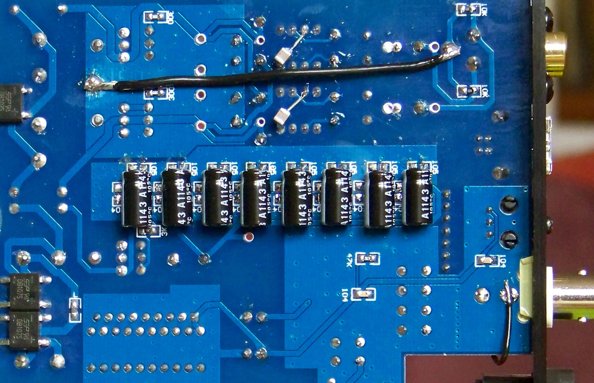

Here is mine today, now burining in (as we seen that terrific change within hours), will play my music on it later. I can say that OPA602 works in flawlessly and I've put IC socket parts in the 2.2nF holes in case I need them back.
So far so good!

That's a pretty high recommendation for a sub-$100 DAC. I've looked at your picture - the electrolytics across the 1387s look to be between pin4 and 5 - across the supply. Have you added electrolytics to pin7? To me that's a much bigger improvement than more C on the supply.
So far so good!
<edit> Ah I hadn't looked at your second pic - looks like you put the pin7 caps on the bottom. But there's hardly any height available underneath - what values are you using?
