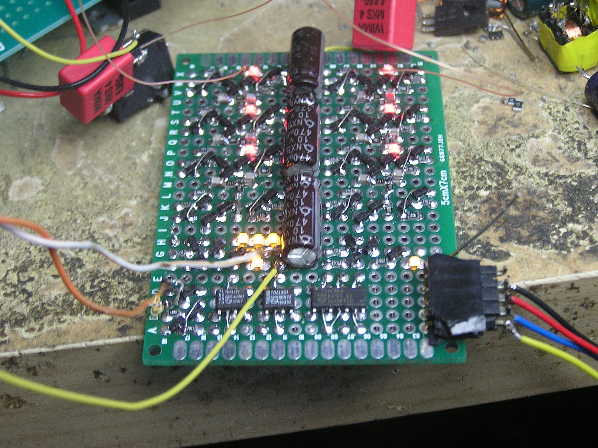

Here's a pic of my most compact DAC to date - on the 5*7cm board is a pair of TDA1387s (differentially driven), discrete CFB I/V stages and a 6th order anti-imaging filter with built-in droop correction. I had a first listen yesterday and its promising enough to build a second 5*7cm board with two more channels of I/V and filtering so I can run fully balanced with transformer outputs. The transformers I'm planning to wind are based on EP17 cores because those are the smallest I figure I can get the full bandwidth through - still experimenting with smaller wire gauges on those.

This is an insane job...

Schematic?
Can't really comment based on a "pretty picture".
A schematic, even hand-drawn, would be useful.Here's a pic of my most compact DAC to date .
