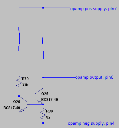

For the next-up mods, I'd suggest current sources on the opamp outputs as with an array of 8 DACs the opamps have to source or sink up to 8mA, well beyond classA operation of the output stage. I use the traditional two transistor current source and it goes between the opamp output pin (pin6) and the -ve supply rail.
If you still think that's the next best step, can you elaborate a bit? Keep in mind I'm at the "paint by numbers" skill level.

Elaboration is in the schematic shown in post 126 - the two transistors at the bottom of the diagram (Q25, 26) are the suggested current source. Q25's collector is the output - this needs to go to the opamp's output, pin6. The bottom rail is the negative supply for the opamp, the top rail is the positive supply (no connection to 0V here). You don't need the emitter follower (that's inside the opamp for your application) Q35 or its base resistor or the two ferrite beads.

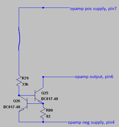

In post 126, you said, "here's the schematic for the classA buffer I'm using (four off) in the latest DAC mods." I added the emphasis - what do you mean by "four off" (of?)? I would assume only two of these circuits are needed, one for each opamp?
And is the attached picture the correct interpretation of what you're saying? Looks like opamp V+ and output basically become jumpered?
You're right, in your version of the DAC you're still (for now) using the opamps, so there's only a need for two current sources, one per opamp. However I got rid of the opamps entirely in the last round of modding, when I went over to balanced (4+4). With balanced operation there are twice as many channels, hence the need for four current sources.
No - you replaced the transistor you've (correctly) removed with a wire link whereas I intended it to be left open circuit. The opamp completes the circuit that the transistor was implementing.
I had a strong feeling that I messed something up. Now I've posted two inaccurate pictures in this thread.
Sorry, one more question: do these resistors and transistors have any particular requirements? Looks like BC817-40 is a generic name... OK to go with the cheapest, or should it be a certain manufacturer or spec?

BC817-40 isn't a generic name in this instance, its the precise part I am using and fortunately its got a model in LTSpice. But you're right its not particularly critical - a lower gain (the -40 indicates the highest gain grouping) may indeed perform slightly better.
Not all transistors will perform as well here - I look for a couple of parameters. First is 'hoe' the output impedance, indicated in Spice models by the parameter 'VAF' - we want a high number as ideally a CS has infinite output impedance. Second we don't want the transistor to have a much lower 'hoe' close to its saturation region - this can be seen on the traditional transistor curve tracer plots. I'll post up some pics later to demonstrate what's important. I don't know about Digikey's pricing but the BC817 (its a SOT23, there are leaded equivalents) is one of the cheapest going - I got a reel of them (3k) and the price was under $30 so less than a cent each.
As for resistors - almost anything will do, I'm using 0805 thick film without noticeable problems. I wouldn't advise 0603 as they do get rather noisy at higher values (like 33k). Leaded metal film will likely have better performance but as for whether you'd notice it, I can't say.
