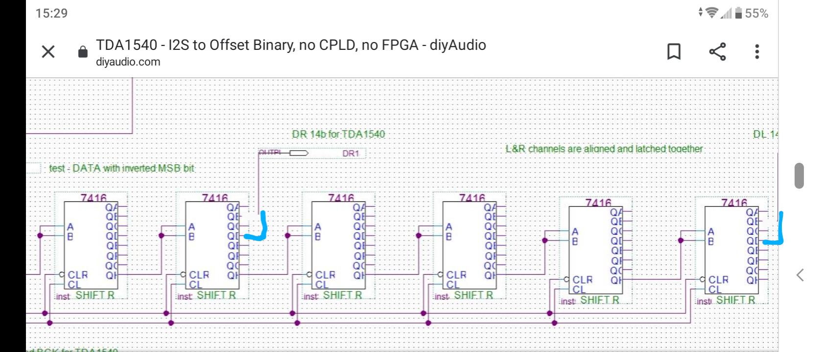

Here is what I did different from the original schematic from Miro's original post (two ligt blue markings). Sorry about the picture quality...made from my phone being at home with the family.
It was testet with a CS8416 input receiver from a cheap small-form-factor China DAC, feeding this circuit which then fed the decoder PCB from a Bang&Olufsen CDX ( similar to Philips CD104 decoder PCB)

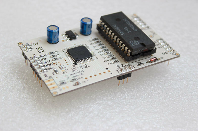

I have also purchased the CDES converter PCB with a Xilinx processor and tried that, and actually Miro's circuit works better. The CDES needs a delayed powerup of the spdif receiver, otherwise it locks up with no sound.

Hi Zoran

Hi Zoran
You are not rude because you are putting a lot of good arguments to support your stand.
I am now more excited to check the square waves from the circuit.
However I do think the circuit is doing really well, since it performs without major problems, even when I
A: deliberately left out the supply caps
B: used through hole components
C: didn't care too much about length of signal paths and allowed ' messy' wiring underneath the x-or and nand gates.

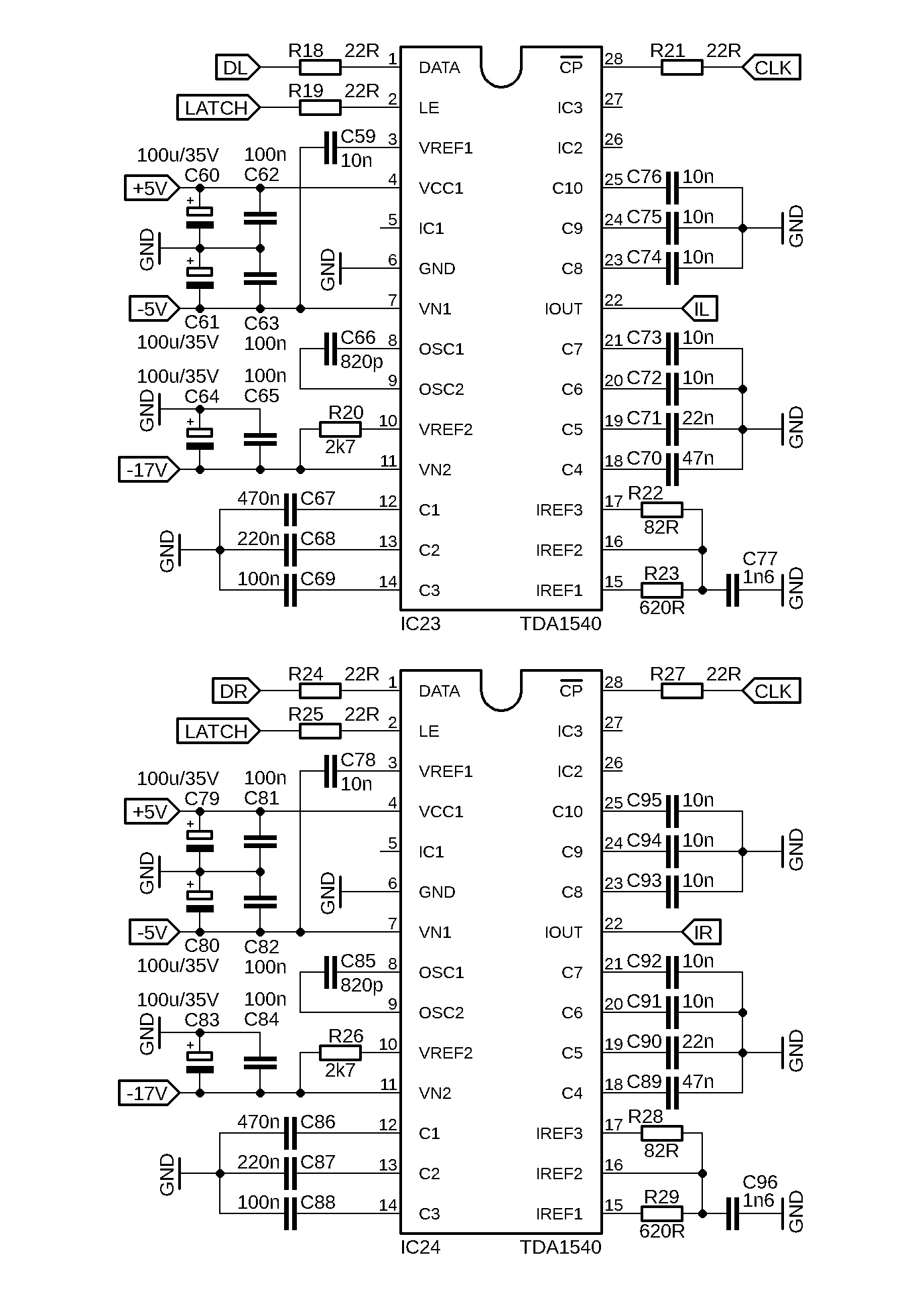

What sort of general value of resistors are you using? Maybe even different values in various positions?

use 220ohm multiturn small pot. Set to midlle. The goal is to bare in mind informations of recognizing "1" stae value that is lower than +Vb. And "0" that is little before than GND (0) V. This infos are in the PDF for the logic chips. So we dont need any "straight" square and in any case we dont need ringing at the edges. The square should be rounded a bit. Yes the values could be different, from my findings, that is why i suggest to trim. But they are not so different from 68 ohms to 120 ohms. You will see at first time You check it.

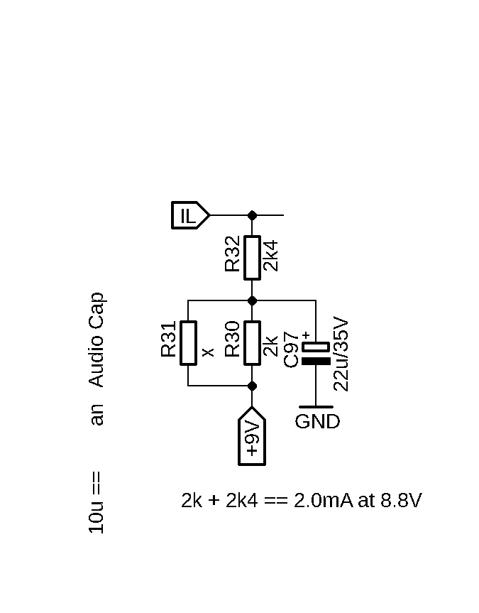

One additional info that may be overlooked: 10mV is max allowed DC offset at the Iout. (Not 25mV as TDA1541A) so the some ma
And current injection of 2mA to the Iout is a must.

This is the CDES PCB I have tested ( and it has written TDA1540 on the PCB)

Also: do you have recommendations regarding the supply voltage of TDA1540? (Beside the-18V)?
The data sheet says typically +/-5V and maximum +/-12 V.
I would like to keep the heat low for longer life so I would prefer +/-5V unless you have some performance arguments for +/-12V?

Any JFET (pref. low noise) with Idss larger than 2mA. Say Idss=4-6mA or more.
From +5V power to Io dac pin.
I tried BF245B, 2SK170 etc.
But simple R could be used offcourse. Like in some Revox models.

In almost all of the models using TDA1540 -V is -18V. I tried and there is no overheating. I measure all consumption currenta in working condition and without the digital bus sum of the power stay inside recommended values.
