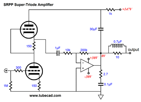

i'm not a big fan of srpp tube/valve topologies, but it occurred to me that their weaknesses (intolerant of capacitive loads, intolerant of varied impedance loads) and their strengths (high PSRR, low distortion if designed to fit a known low-z output load, decent gain) creates an opportunity to build an integrated amp with an inverting TDA7293 (or LM3886). an inverting 7293 can presents the low-ish capacitance (if it has a series input R) and a known fixed impedance load (by virtue of the FBshuntR, the inputR and an input shuntR. so an integrated amp with a quiet medium mu srpp stage (6922, for example) driving an inverting 7293, looks good at least on paper. bonus: the result is phase-correct. i may try this unless someone sees a reason that it's not as good as it looks. comments anyone? (the cause of srpp capacitive load issues is current handling asymmetry -- the srpp stage can source current pretty well but doesn't sink current well).
it turns out that J. Broskie worked out something quite like this a couple of years ago (for LM3886). the tube controls the sonic signature by virtue of the 30uF cap. The result is phase correct because both the bottom triode and the chipamp invert the signal (the top triode is just an active load).
he went on to say that CCDA and Akido versions would probably make better use of the second triode (or second, third and fourth in the case of Akido).
That is indeed better use of a triode.. . . Akido versions would probably make better use of the second triode (or second, third and fourth in the case of Akido).
a properly designed mu-follower would also work wonderfully here, if given a really good tube like 6922: it offers plenty of current, plenty of PSRR, preserves a real triode sound signature (it's not push-pull) and shows remarkably low distortion. also a budget version with only one valve triode, replacing the upper triode, with cascoded DN MOSFETS, taking the output from the mu point (lower MOSFET), could actually do even better on the other fronts (by virtue of presenting a virtually infinite plate load impedance) IF the PSU was good enough that the loss of PSRR wouldn't matter (shunt regulated, for example). by now i think i may have veered off topic. sorry about that.
