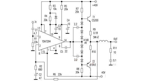

Its been a while, just want to report that the LM3886+5200/1943 amp at +-43.6V rails i doing just fine, good gain,good tone the chip is runnin just warm, the transistors a bit warmer-without the fan- sorry no pics, lost mycam.
the schem is the same gclone ptp with the 22k-1k-47uf fb string, 2x470uF at the chip, PS has single bridge rectifier then 2x2200uF parallel each polarity, then 3x1ohm parrallel each polarity then 2x2200uF parallel each pol. then +-V out and PS star ground.it sounds really good direct to rin or thru a 2.2 or 3.3 film cap.😎

+-40Vdc supply, if regulated, could support a peak output of ~37Vpk into your speaker load.
8 ohms gets to 85W and 4ohms gets to 170W.
If the +-40Vdc sags to +-36Vdc, the maximum peak output will be ~33Vpk.
With 8ohms you get 60W and 120W into 4ohms.
The single pair output stage tends to support the 60W into 8ohms as the only sensible expectation.
Whoever states 400W is lying.
