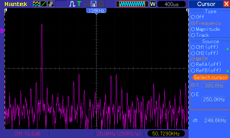

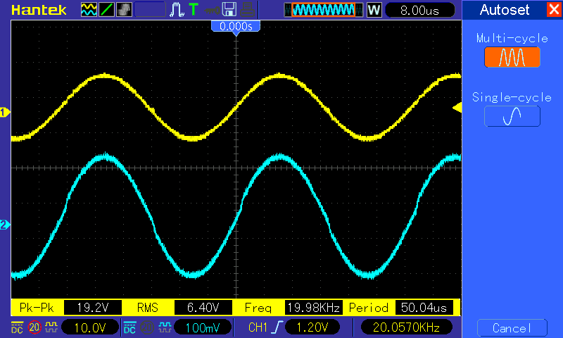

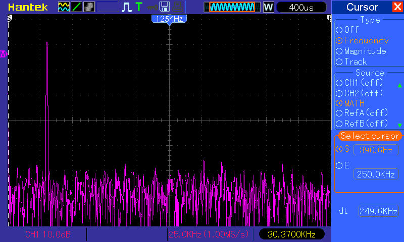

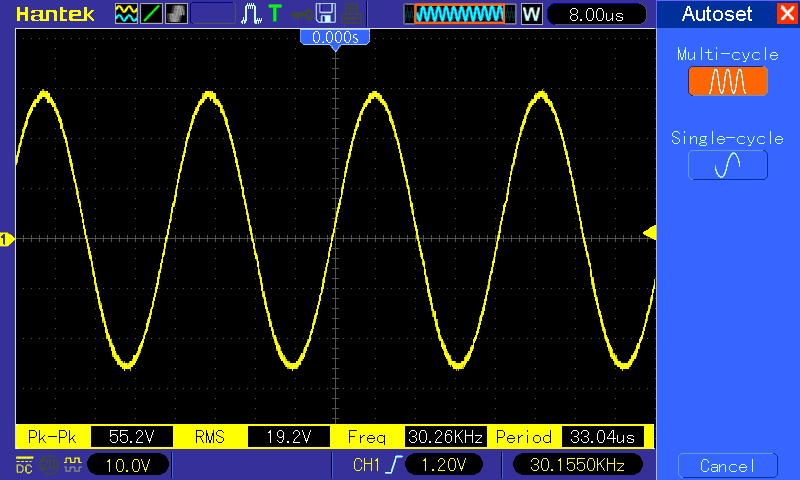

50000Hz:
You can see how harmonic distortion appears at this frequency.
In conclusion up to 30000Hz this amp delivers 216Wrms at a very good fidelity.
I tested just the upper half of the bridged amp, speaker connected to GND and the 680ohm resistor connected to GND by a 22uF/50V capacitor.
The peak current through load is 19.2 x 1.41 / 1.7 = 15.97Amps.
The bridged configuration theoretically should delver 216 x 4 = 864W / 1.7ohm but the current will double to about 30Amps which is almost the limit of the power transistors. But on 4ohm load (19,2 + 19,2)**2 / 4 = 368Wrms on a peak current of 13.53Amps which is very acceptable.

Well done!
Nevertheless you can even in the 20 kHz see some small tops in the frequency analyser (not in the sinus wave). This implies a distortion of more than 1% I guess. Pity, you let not see it at 1 kHz. I expect it will be far less and even completely invisible at that frequency.
Could you measure again with f = 1 kHz and than remeasure Rsync = 1 or 0,5 Ohm with f = 1, 20 and 40 kHz? I am very interested in the results.
Finally this thread comes to an end with hard measurements. Congratulations cmorariu, well done!!!!!! You earn a MSc!
Thank you! Trust me, the 20KHz is as clean as 1KHz, the small tops are present even in the absence of the signal due to FFT computation algorithm of this tool. I increased the input signal at 20000Hz to push the amp into clipping and the tops at harmonics are very clear visible and stable, bigger at odd harmonics. I also scoped the slope of the pin 14 of the TDA and measured its incline at different frequencyes. Incine still increases above 20000Hz till about 35000Hz when reaches the slew rate and remain steady (at crossover). Increasing more and more the frequency the slope becomes triangular at the top also.

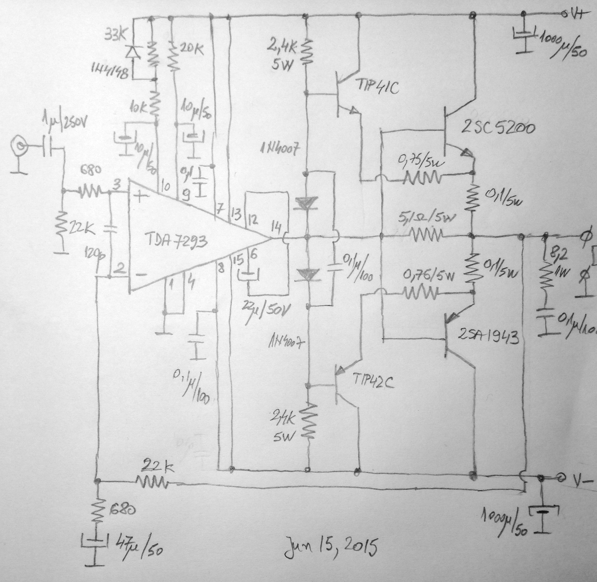

OK.
In the photo I see you still use 0,1 Ohm in the emitters. Why do not you skip them? With 16A they alone loose 1,6V! That is very much! They increase temperature of the TDA a little bit and decrease severely the clipping voltage. I.m.o. they are not necessary for security if you only use one pair of end transistors.
If only one transistor per polarity is used they can be skipped unless you want to implement a current limitation circuit (as I intend to do). But when more than one transistor per polarity are connected the 0.1ohm resistors are necessary and very important to balance the currents through this transistors, since in the real word no Ube twins are possible.

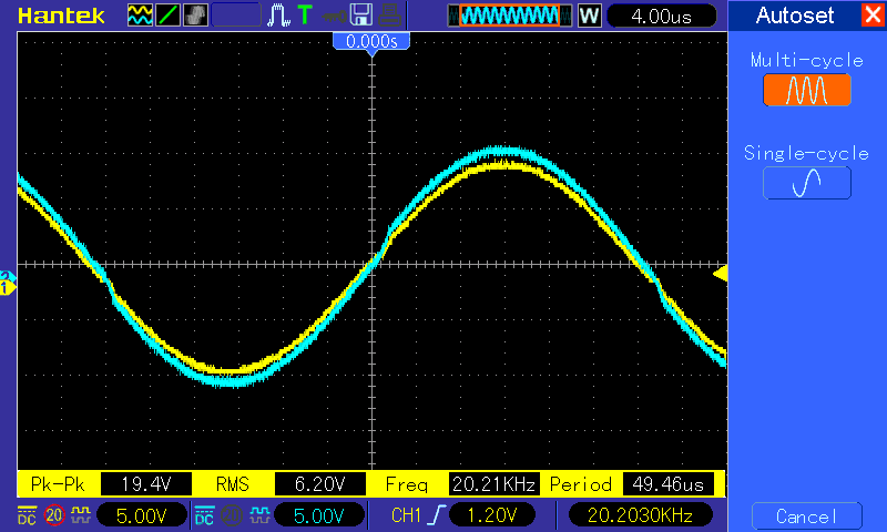

Out and transistor base signal
@zanden30 - I'm sure you will like this! I scoped the signal at pin 14 of TDA (down) and the output of amp at 20000Hz at a lower output level where small modifications of slope are more visible. You can see the "jump" of the base signal and the behavior of the output. This may explain a lot
Base and output overlapped
This picture is more relevant I think. The jump comes over 0.6V till about 2.6V, the reason is most probably what I wrote before. But the picture reveals another interesting thing, compare the crossover portion with the "jump". At 20000Hz is plenty of slew rate reserve at crossover, the jump portion is done in the quickest way to correct the step in of transistors, thus that is done at a greater slew rate. I zoomed on the scope, the jump is of about 2V in 1uS, i.e. one fifth of the max slew rate That confirms that the circuit has full capability to correct its output by the feedback loop even at this frequency.

Dr. Frost Amplifier, enhanced fidelity
Many built this amp proposed by Dr. Frost and were delighted by it's quality and easiness to build. The sound is great for such a simple circuit but as discussed in previous posts it has its pitfalls. As zanden30 mathematically predicted some distortion exists at crossover at high signal and high frequency, fixing it overheats the chip and is a matter of fine tuning to achieve that. Also, as I experimentally discovered a glitch is present at the moment of power transistors "step in" and I published a very clear oscillogram showing it. Of course all this exists in an acceptable low level of distortion and the circuit still remains a very great idea.
Being a perfectionist I wanted to fix all this pitfalls still sticking to Dr.Frost circuit and trying to keep the amp as simple as possible.
If you look at the attached schematic, the additional components are 2 transistors (TIP41C & TIP42C), 4 resistors (2 x 2.4K/5W and 2 x 0.75/5W), 2 diodes 1N4007 and 1 capacitor of 0.1uF.
They form a medium power class AB stage who's essential goal is to drive the load around crossover and at low output power. This stage contribute to total power even at high signal but it's contribution is "shadowed" and limited by the step in of power transistors. I dimensioned the emitter resistors of TIP transistors to limit the peak current at about 2 - 2.5Amps. The negative feedback loop of current realized on 0.1ohm emitter resistor improves the linearity of output at power transistor step in.
On 4ohm, at +/- 40V this amp delivers 170W at practically no distortion!
Bridging two, 340W can be delivered on 8ohm. (If you want 680W on 4 ohm add one more pair of 2SC5200/2SA1943 for each amp)
