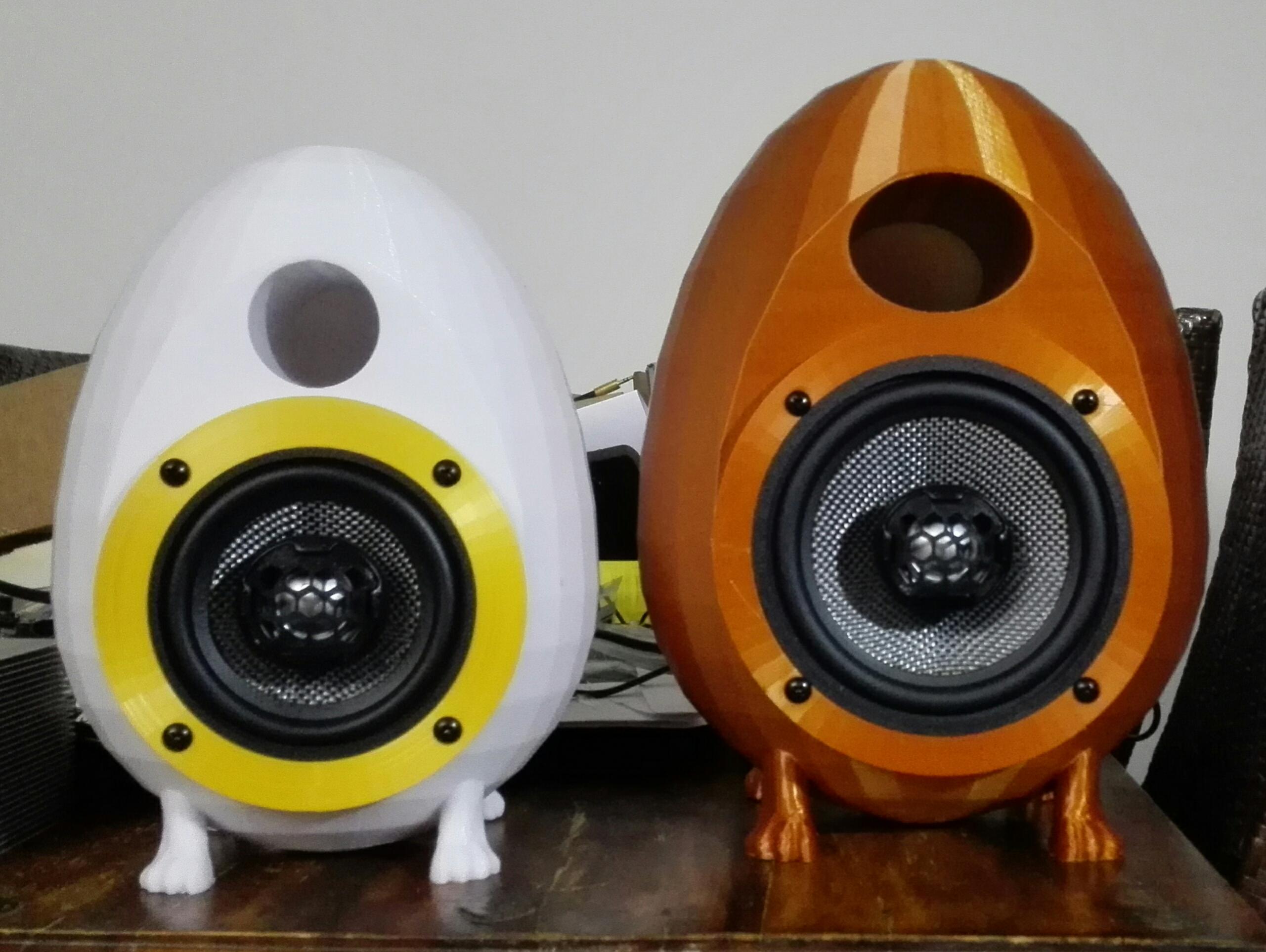

TDA7294 + Power Transistors AMP (TDA7293 to come also)
Here's the old version of 4" and 1' version of 5" (will have new design to hide screws under ring), 4" will also have oval port

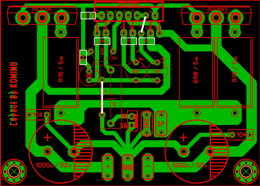

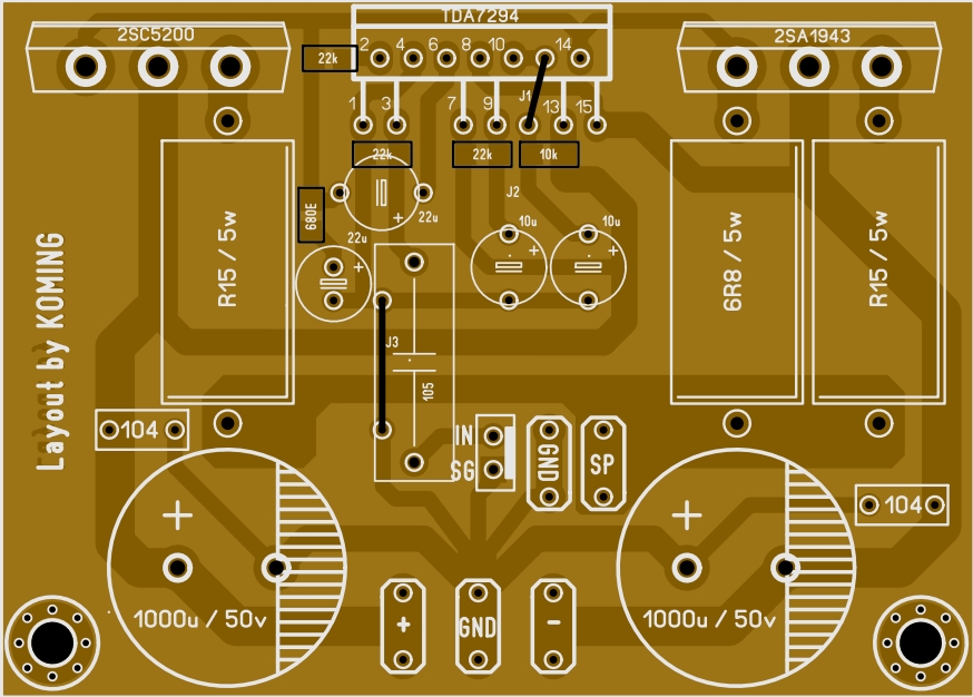

Hello dr frost & all diyers
I still lay about amplifiers. and I am so excited to make this amplifier. I plan to make dual mono. This layout I would use. Please be corrected.
View attachment 356400 View attachment 356401
if any body have schematic opamp stereo/bridge with selector mode, please share .
I want to pair it with this amplifier.
Sorry if my English to bad.
Hello,
can you help me please with bug in my circtuit, im trying to build something very similar as this amp in this topic. But all what i get is fully open Q3 in this circuit, and dc in speaker.
Shared album - Andris Drulle - Google Photos
Have a nice day.
did you get it to work?, cause you got no feedback in that circuit you posted, check the original i posted here
