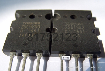

1x TDA7294 Chip AMP
1x 2SA1943 PNP Transistor
1x 2SC5200 NPN Transistor
