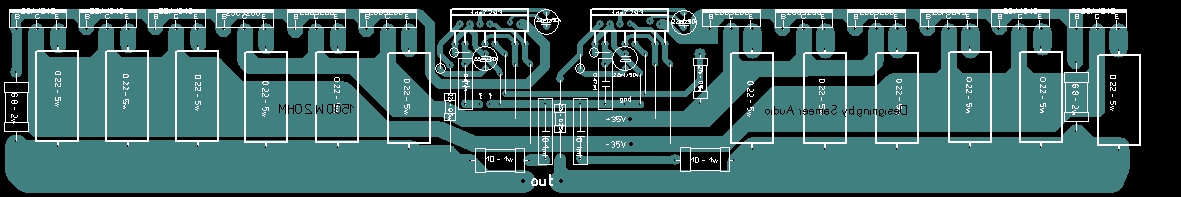

http://www.diyaudio.com/forums/members/martin-martinez.htmllooks good with the PCB, any plans to sell them?
i don't plan to sell it.. just for collection on my work space. because i'm glad to try something new. if there are relatives who want it, i will give it.

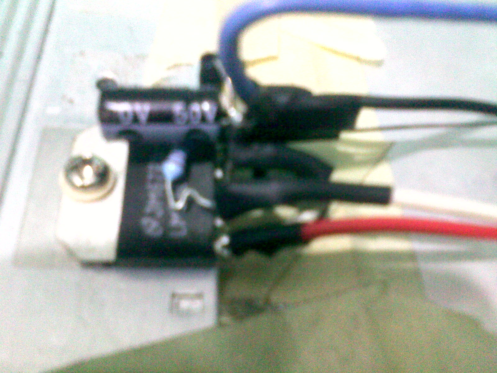

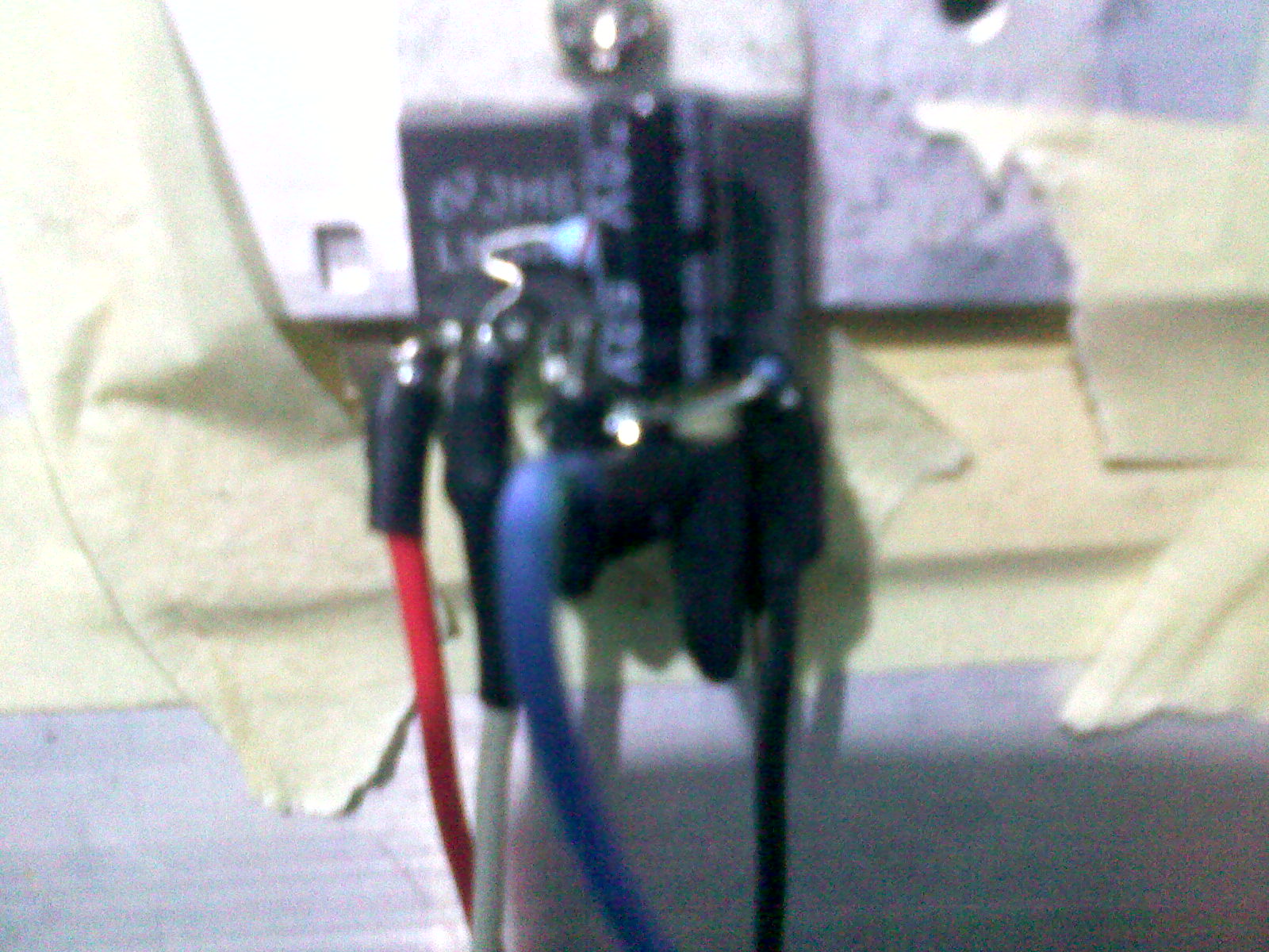

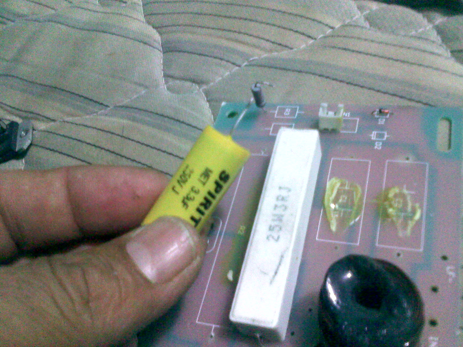

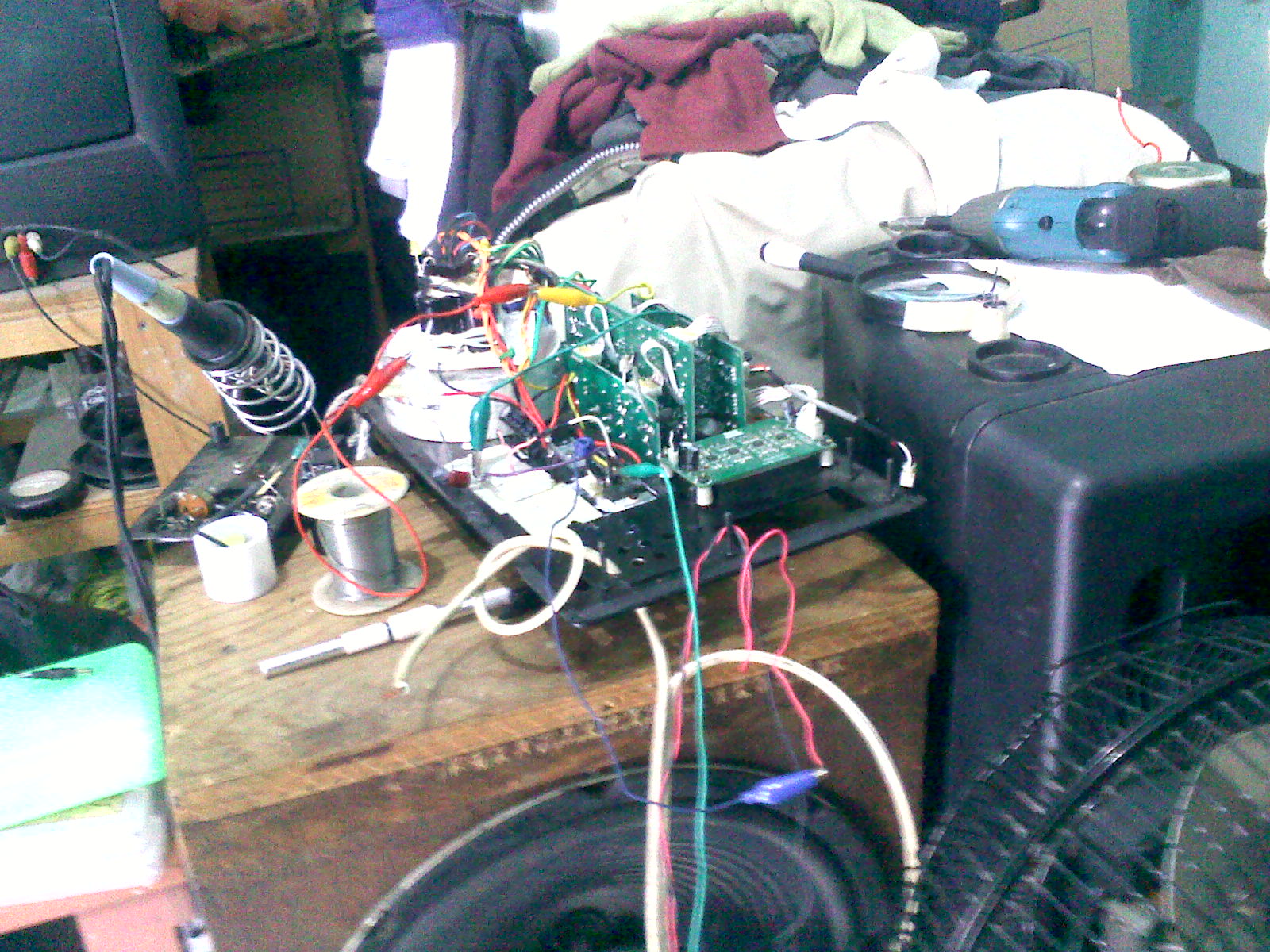

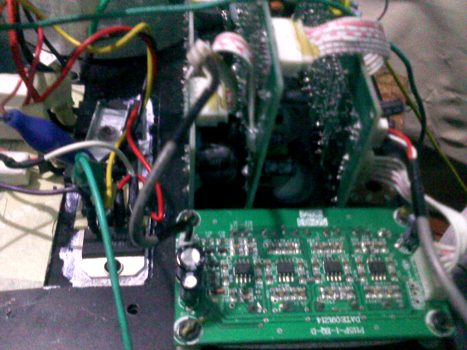

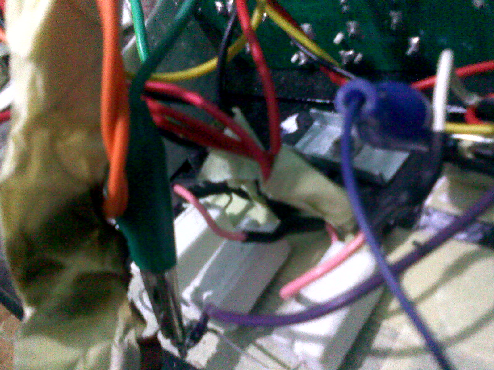

having a broken tda and another defunct (suspect) tda,
went for this: LM3886 +sc5200sa1943...
and its very nice sounding right now.
Getting better ...
followed the schematic by Mr Feuerbacher, and added 1k input r,
didnot use local C but the 4x4700uf from the PS just the NPelec 2uf
beetwen +and- at the bipolar-chip node
maybe later i´ll try some nf´s to snubber the xfrmer or th bridge.
ithink its kind of bright if something maybe alittle on the edge at both ends, but nice and certainly flatter than some.
have to make voltage reducer with res and zenners for the mic section and the eq. also for the mp3 reproducer need like 12V
first pic: amp left , right is eq and behind mic input line input..
2nd: amp
3rd: xover
4th: amp
5.: chip
6th: wheres my glasses??

there´s actually two 3886, and one is made with 22k-1k-47uf string,
the other, in use, is just 22k-1k no fbcap!
Used that before and less is more?
or else...
i´ll test drive vers 2. jejeje
letyou know later after all this mess is up and running.
Sorry, those two pics from my job!
