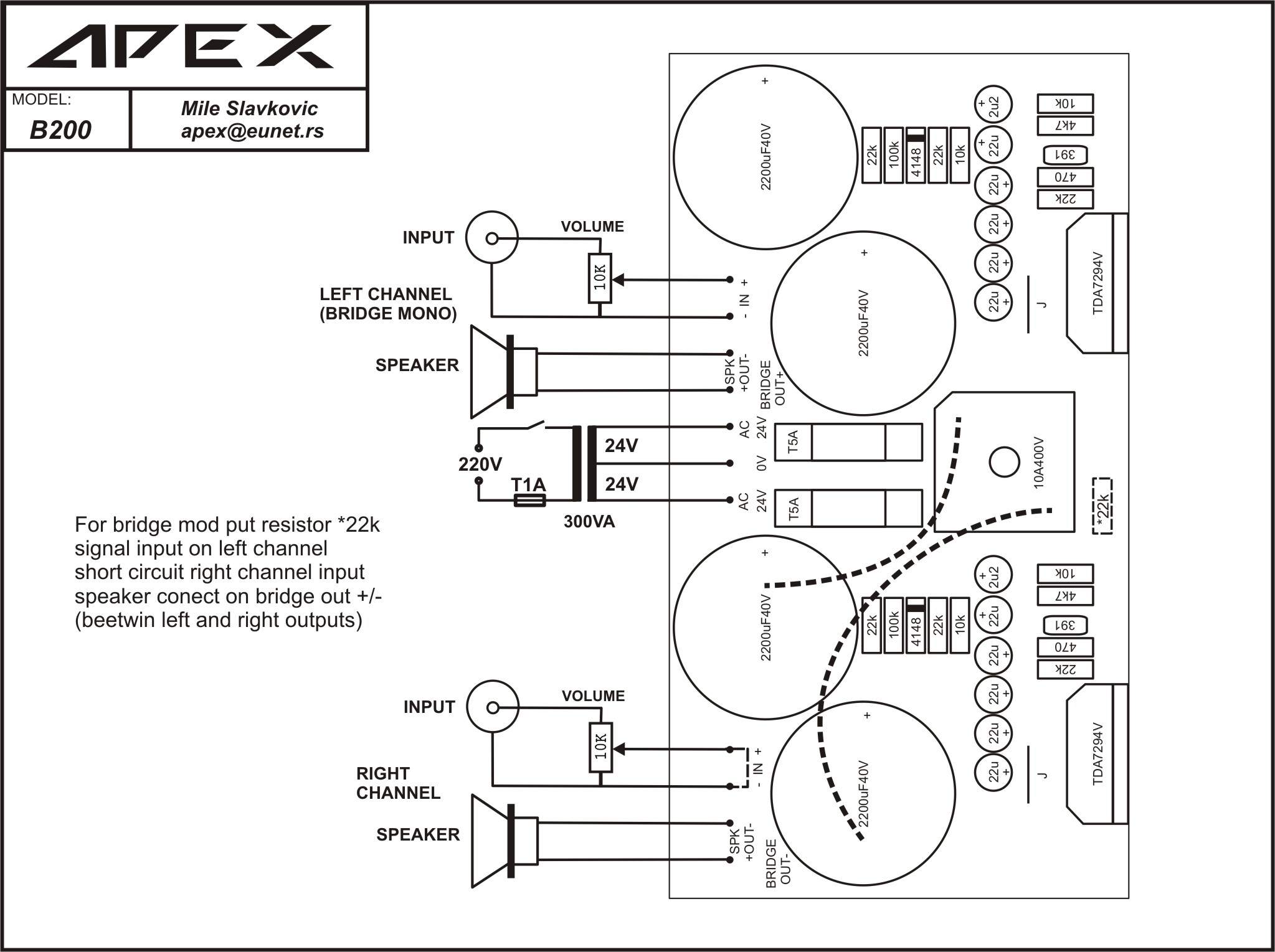

Yes this is the amp .. but site is in Portuguese and google translation of users comments are not working on my end..
So asking experts on DIYAUDIO to give some comments.
I want to build this btl amp , but i don't know where to buy the ic. I found this one on ebay : 2 Pcs TDA7294 DMOS Audio Amplifier Original from St ICS | eBay

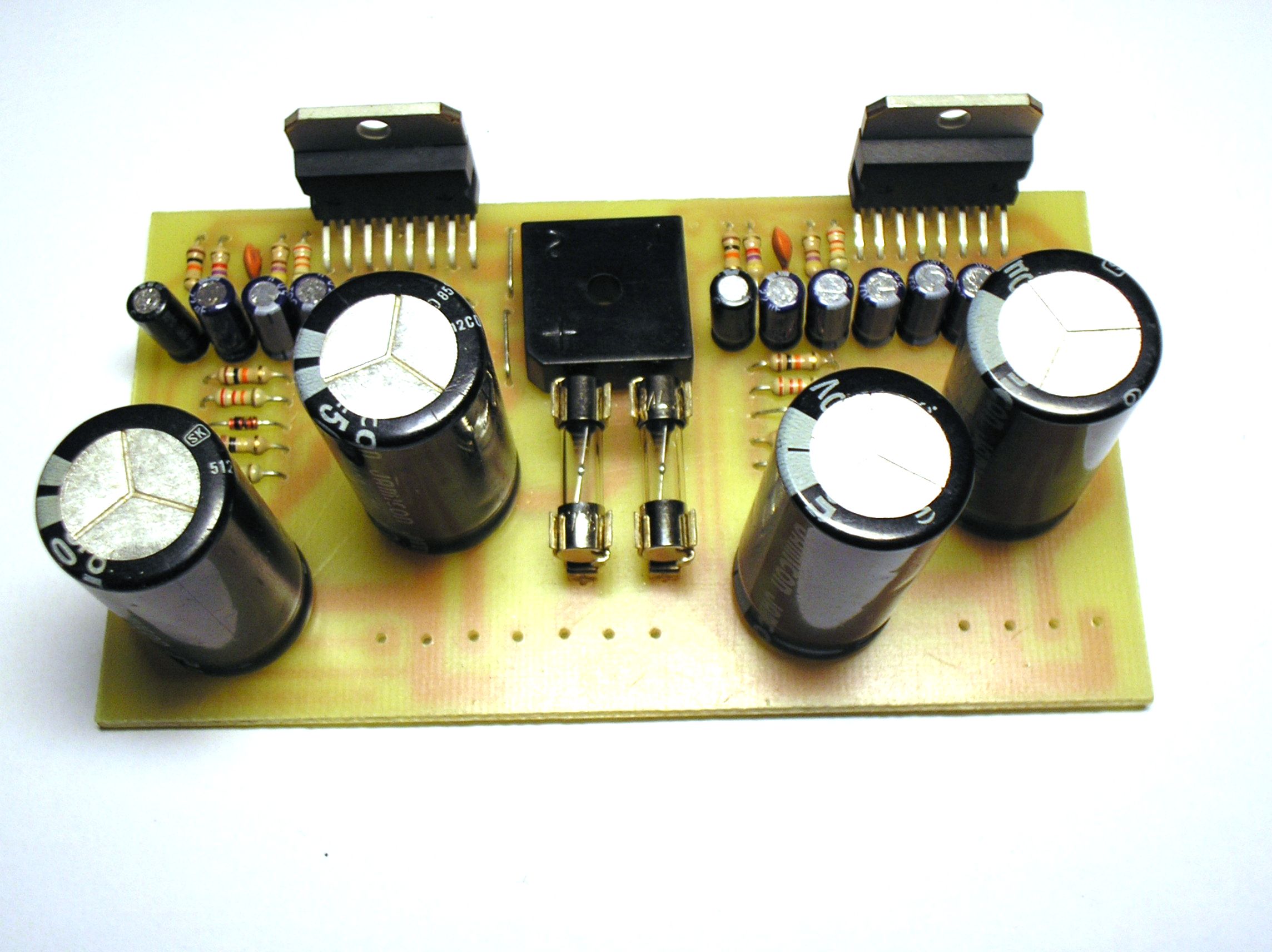

Hi this is my first message. Here are some pictures of my last TDA7294 Bridged. It was made in base to Saytronic design (user of other forum) but this one is mine. It works Well on my 2x12" + Piezo Speaker. In the component side it reads 75W RMS
. That's not true, I did it to mess with a friend of my school
. I add a 12v fan for cooling. and reinforce the thickest tracks with solder. The PCB is 90mm x 50mm in size. I use the Toner-Laminator method in bouth sides. The supply is an 24+24 VAC transformer from an old Sony sound system. Filtering caps are 3300uF/63v plus the 2200uf/50v on the main PCB. Big diodes. The design is all done in Corel Draw.

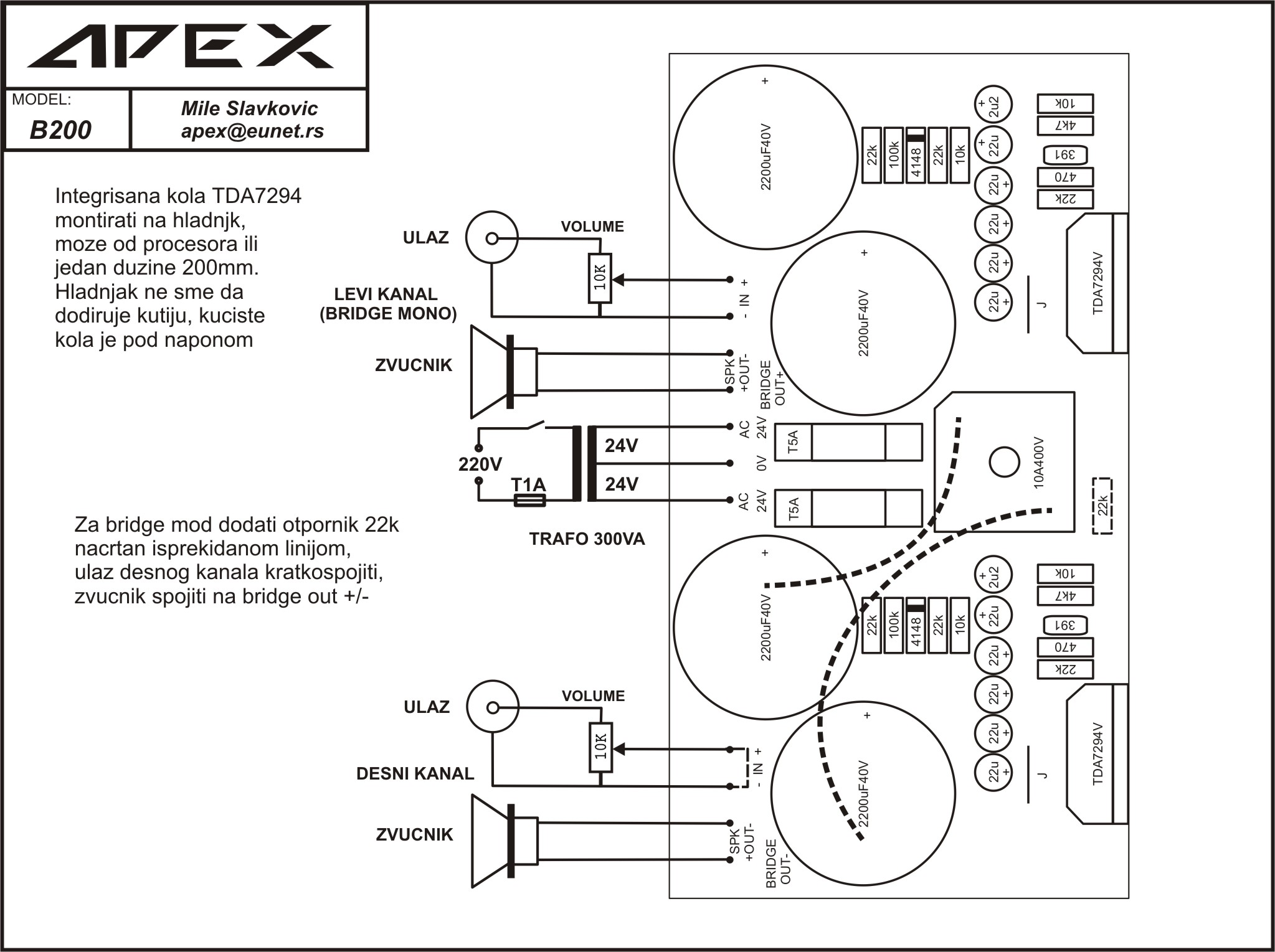

Hi rakesh_sharma23,I am looking forward to make a 7.1 amp using TDA7294 chip as according to the following circuit.
Please share if any one found any fault in layout or any suggestions for sound improvement.
