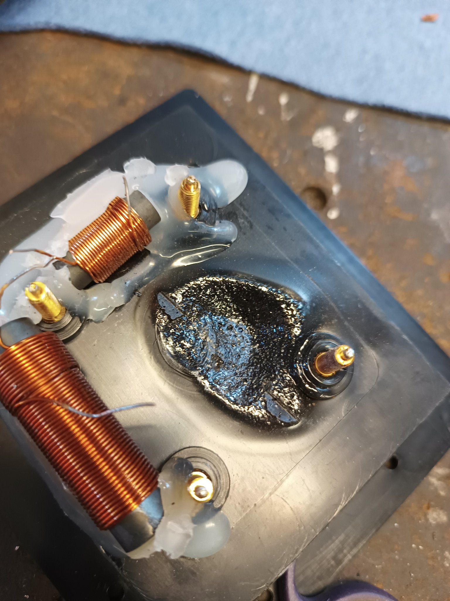

The existing resistor was 12ohms.
Attached is a photo of the heat damage it caused.

It's strange the resistor got this hot it melted the plastic! It must have seen some abuse for extended period of time!
Its not too strange when you think that a 10W resistor was resting on plastic as it was shunt to the woofers thus dissipating 12/4=1/3 the amplifier's power

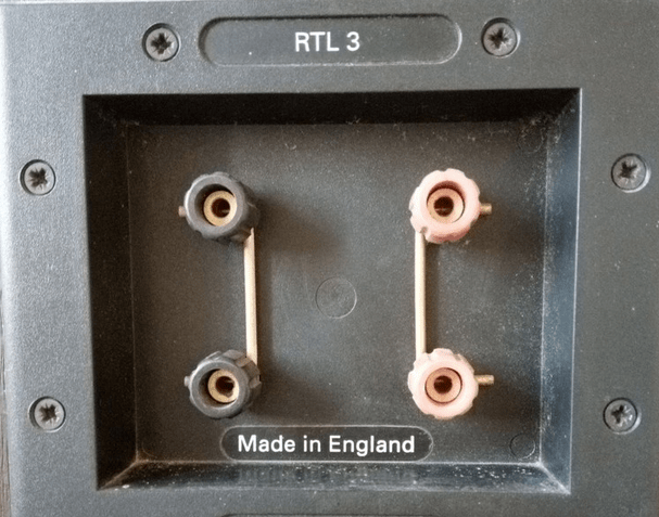

The top red and black posts pair. In other words the ones towards the RTL3 print at the back of the cup.Also, as this speaker has by wire terminals (2 x +ve & 2 x -ve) at rear, which of the 2 relate to the tweeter.
Their counterparts near the Made In England print are for the woofers.
Yes you are right about the resistor Salas.
I'm surprised it wasn't anticipated by designers and they didn't leave a gap or something to allow some passive cooling or at least not to put an heating part in contact to plastic.
Unfortunately they were doing many overlooks and afterthoughts back in the day. Usually some smaller specialist companies. Remember the beautiful sounding popular Musical Fidelity slim Class A integrated amps and their thermal design "margins"?
