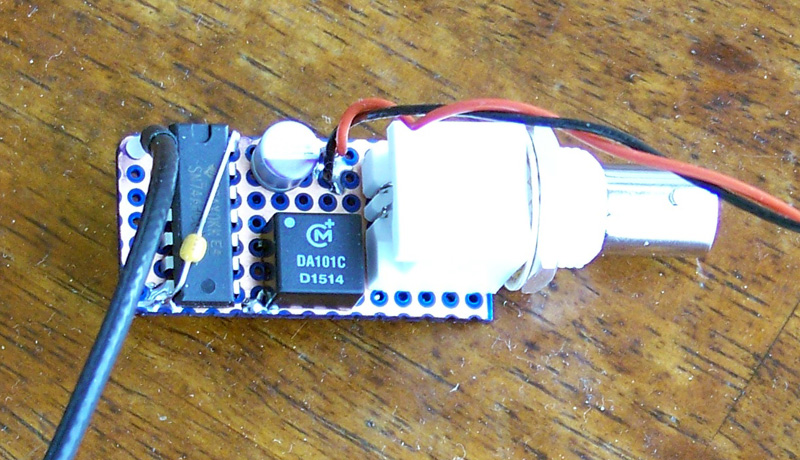

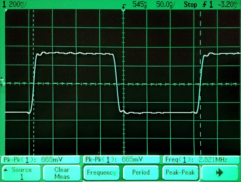

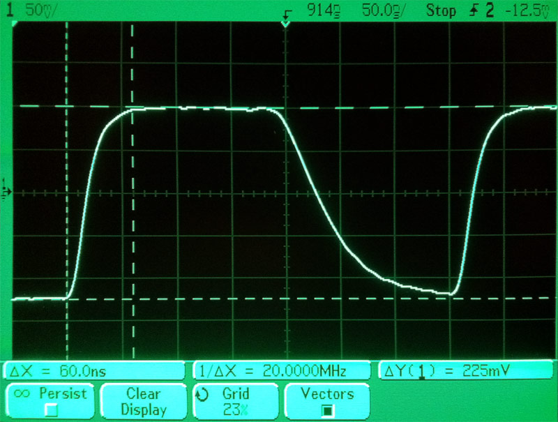

I've had a look at SPDIF signal as BII won't lock. Pic below, very ugly shape!
I wonder if it is faulty or just factory crap, a part failure or any problem, the 225mV PP being really out of specs. Anyone able to check on his own gear?
I plan to steal TTL out of the CXD2500, then 470R to a 74HC04, 100nF pulse cap (FKP from Wima), a Murata DA101 and then a voltage divider@75R. Sounds good to you guys?

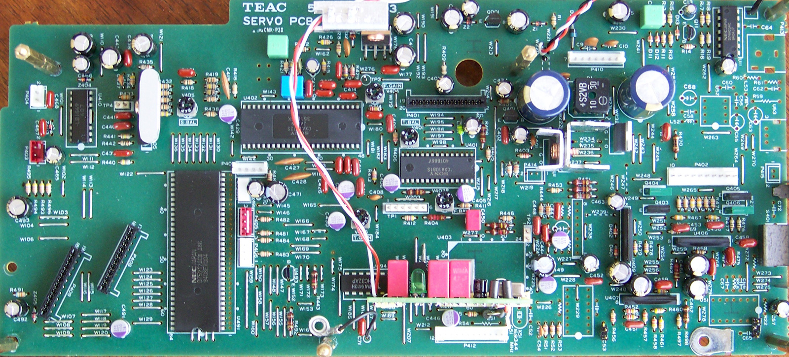

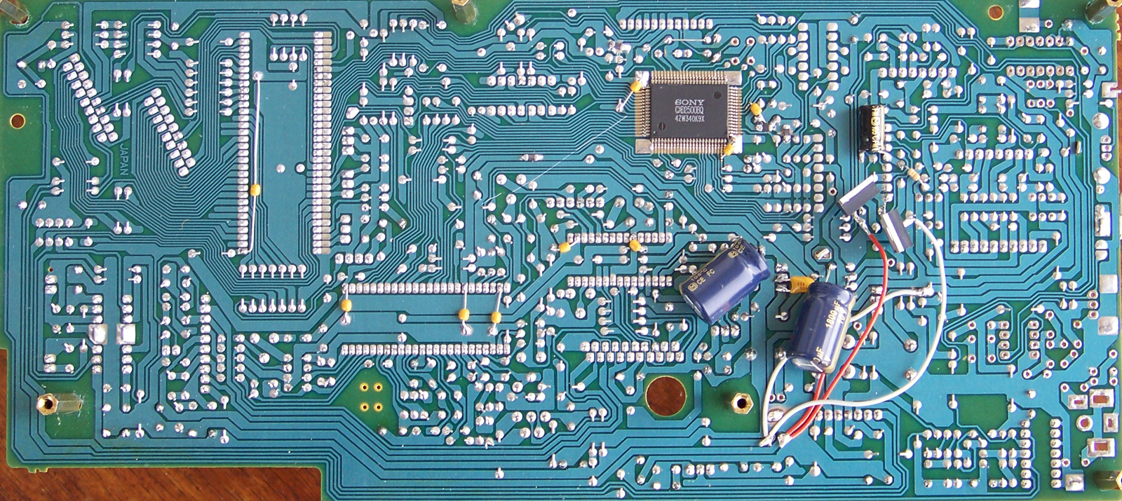

It's all done.
Hi readers (oh my! that echo...)
See pics for infos, but: gone ferrite beads à la Tent, added IC local decoupling, fitted a regulated PSU dedicated to servos (and local 7805/7905 for a +/-5V servo's IC), maybe an overkill one but got it in drawers so... A simple logic IC, a transformer then a T network @75R and the 75R BNC for my SPDIF picked at the CXD2500. Looks like normal digital signal now.
Adjusted the laser mech and closed the lid for ever. It works like a charm, fast and quiet. As for sound, there is a clear increase in bass, wonder how it is possible with only the transport modded but it is here for real, been heard on the first second by friend when visiting.

Wiring mistake!
Warning!
In case someone want to do it, my picture of PCB, track side, is the wrong pin for clock input. Yes, I do feed the clock to the XTA-O(ut) pin, not the XTA-I👎 pin. And odd enough it works! Hope I did not fried anything in the CXD2500BQ, will change that ASAP. Will I sleep at night now I've seen this? Not sure... ='(
