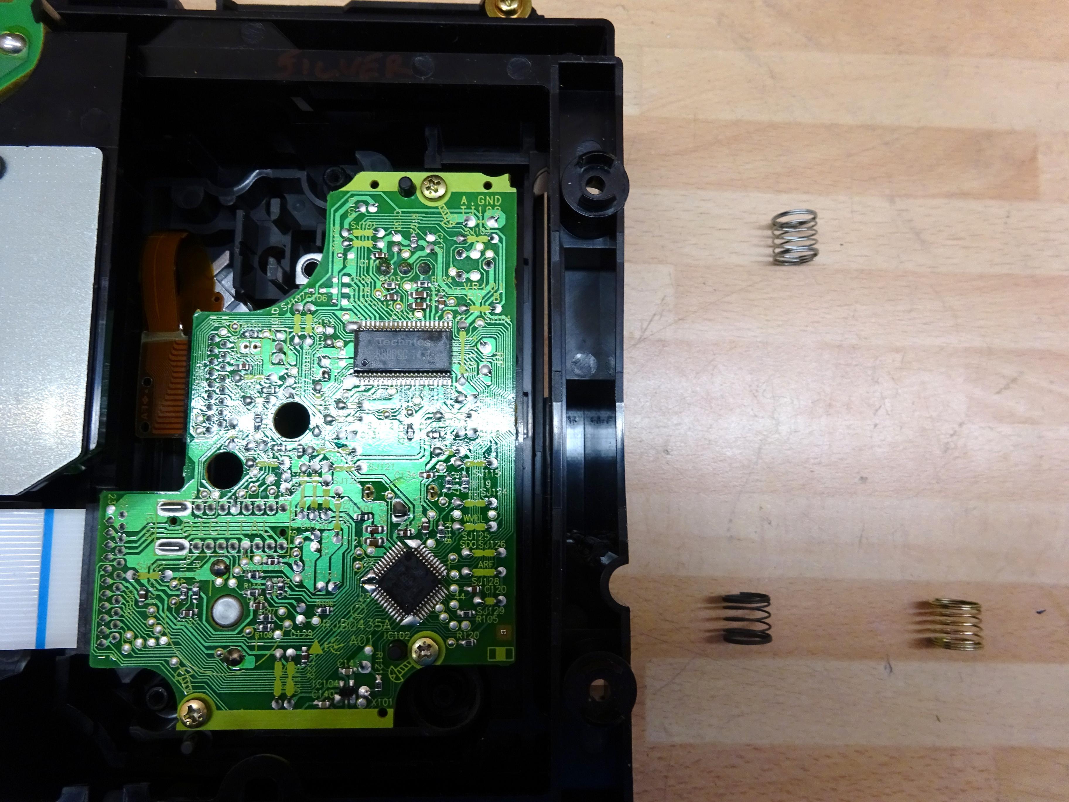

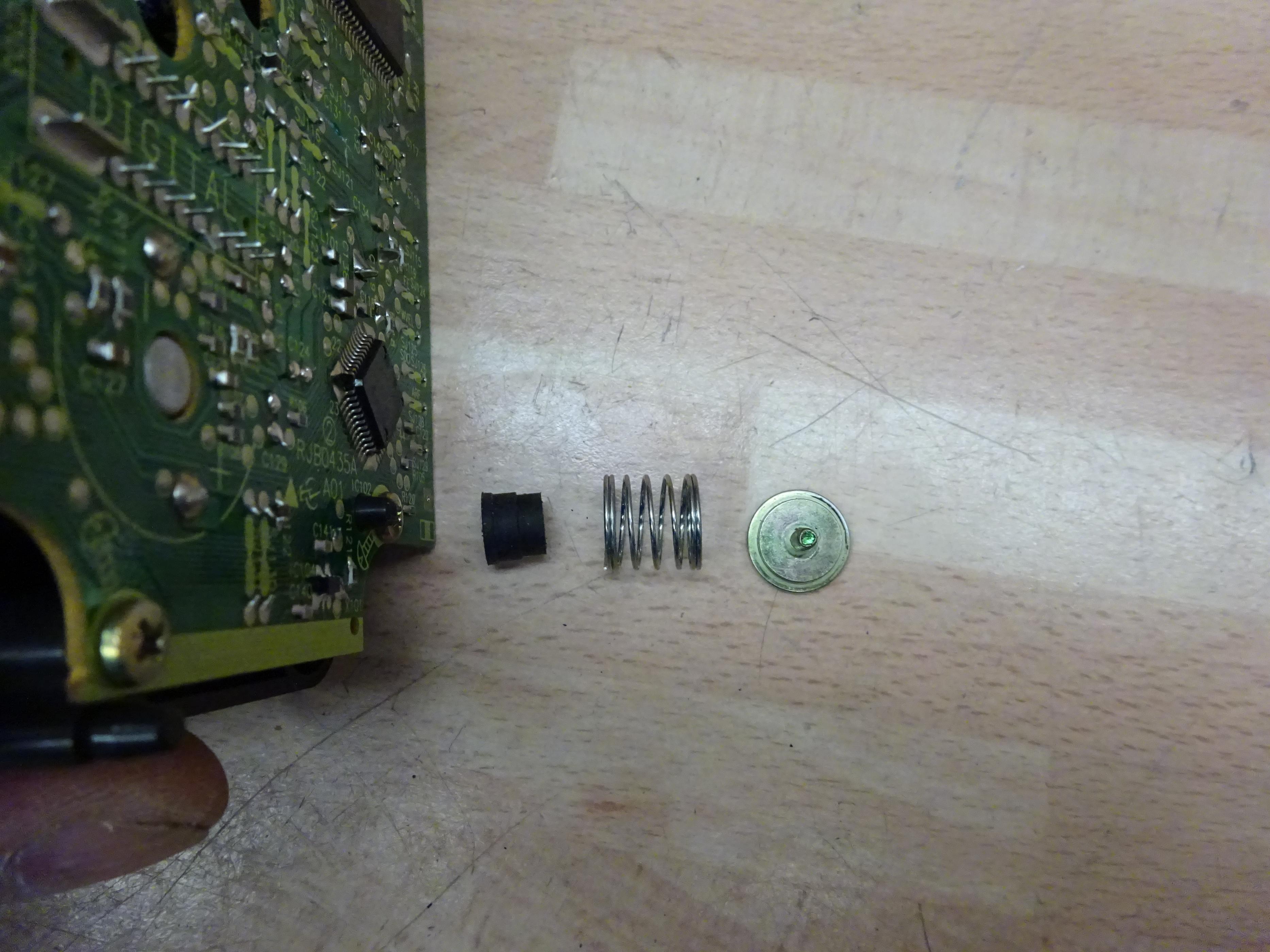

Hi Iomis, and Dacen,

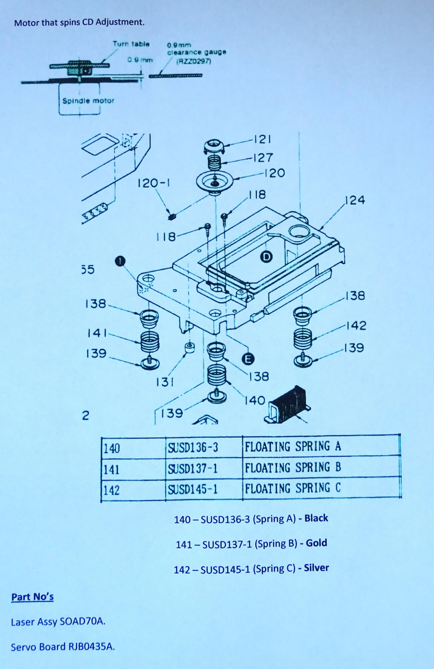

I've been having a play before I got back on here and read your posts, and saw that the Service Manual has been posted to me - I will take a look at that later tonight/tomorrow.

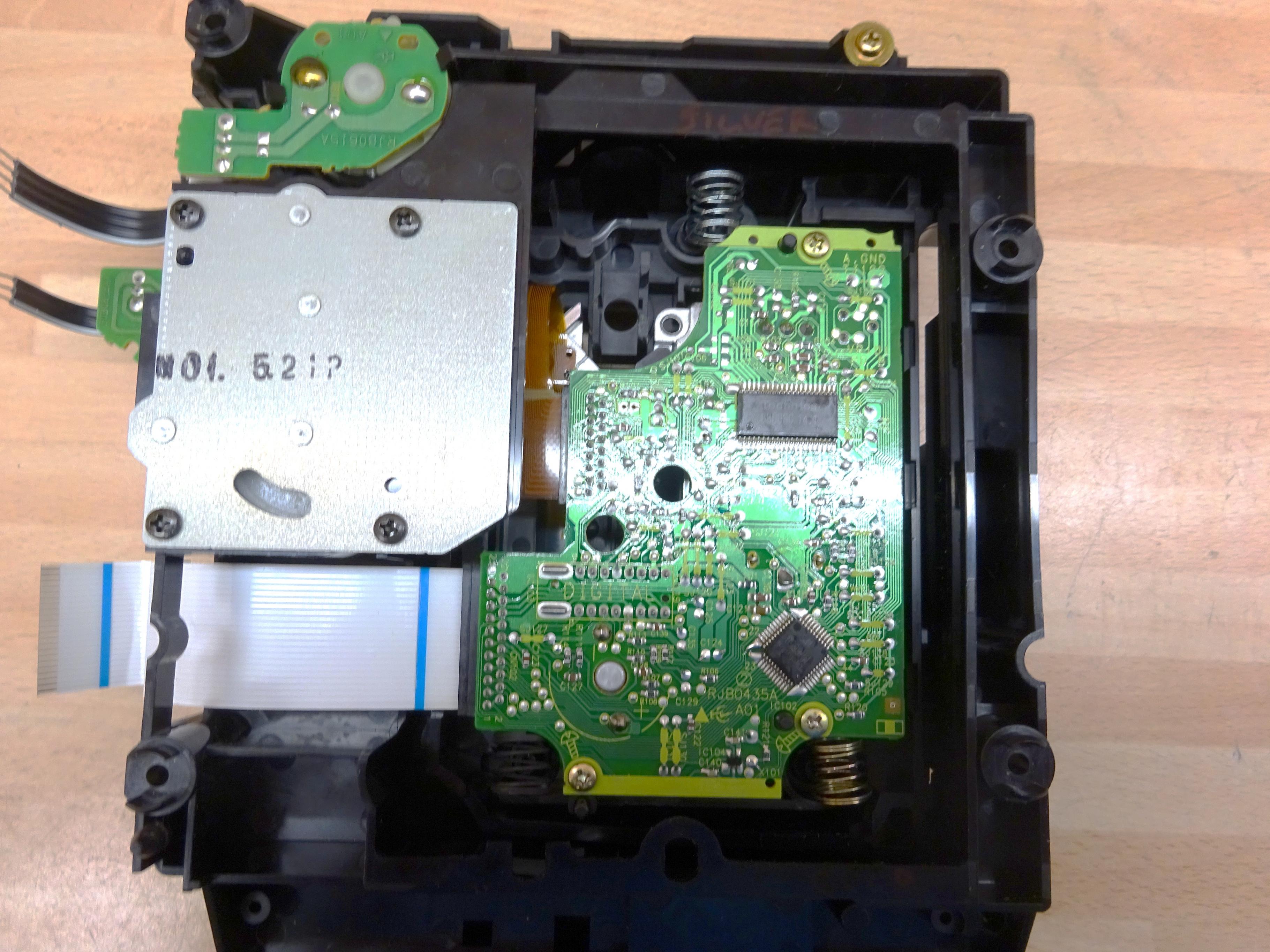

There are indeed three different coloured springs (dark grey, silver, and gold), and some rubber grommets that fit inside them. Wouldn't it have been lovely if I'd spotted they were different and where they went, also which way round the grommets go, "before" having them in my hand. I suspect/hope it will be mentioned in the manual, so should be recoverable.

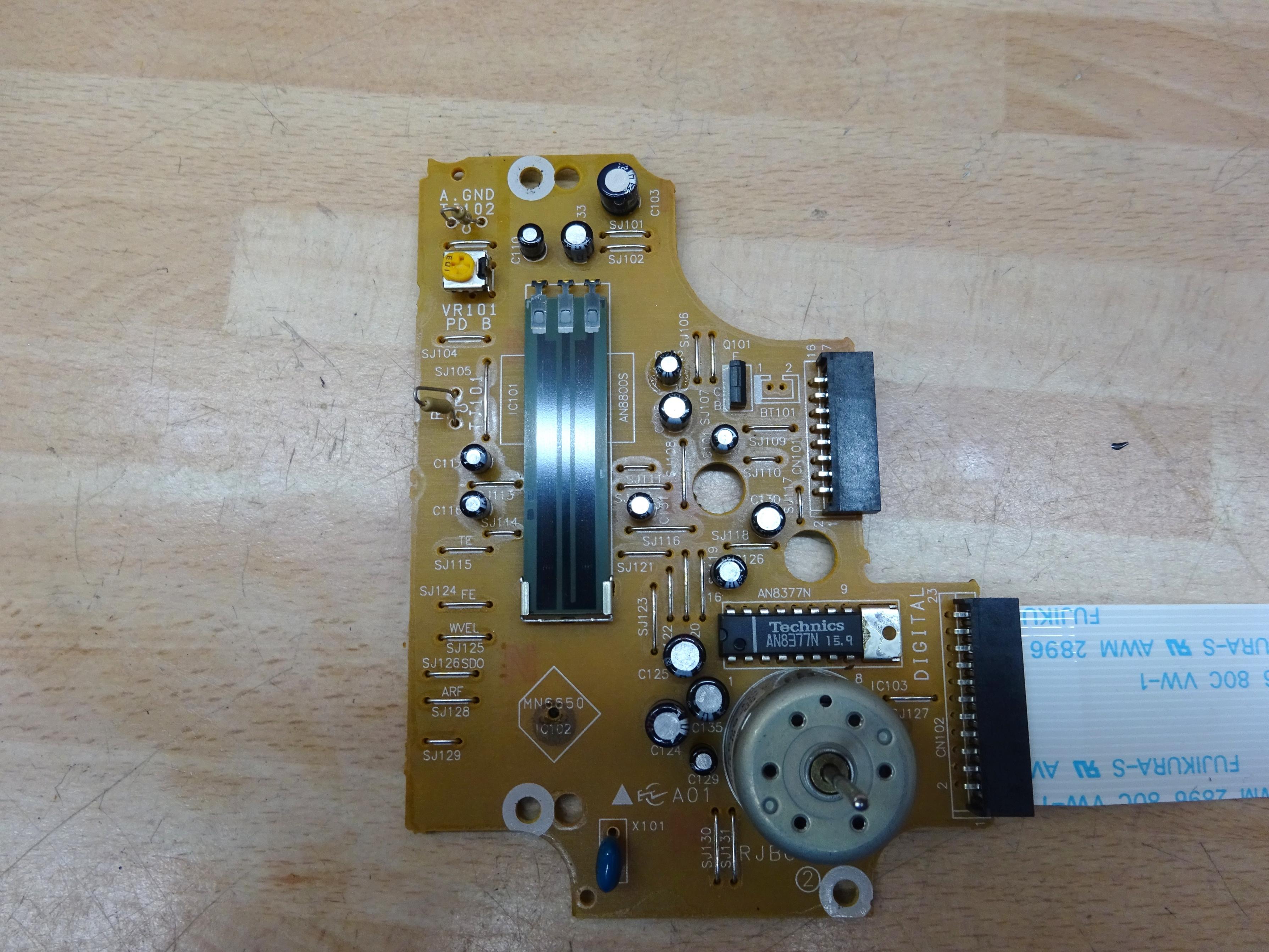

I cleaned the shaft (and bearings) and jockey wheel that laser rides on with some clean tissue, and have applied a thin layer of ATF fluid (I hadn't read the post saying not to do this at that time), and the problem seems the same as it was originally. So at least no damage done. I've also cleaned up all the cable ends that come from the drive, but that hasn't helped.
To get to the shaft you need to take a board off, and to take the board off you need to remove the pulley on top of the motor that drives the disk. At first I had this set a bit low when I reassembled it, so it wouldn't spin the disk up and gave a "No Disk" message. This was due to it rubbing on the laser assy. I've highered it a bit now so it clears the laser assy, and I'm still back to the same fault condition. I think the cleaning and oil I've put on the shaft is okay (maybe not perfect, but okay), as once it picks up a disks tracks okay it will happily skip from one track to the next with no issues.
It's an odd fault as I've put a disk that looks perfect in there and it won't pick up the number of tracks when first inserted, but some others it will. Also if you press different track buttons it sometimes picks up and seems to play fine after that.
I think it's best if I read the manual now and see if it mentions how to set the height of the motor pulley (in relation to the laser/disk), where the different colour springs (they must be different strengths), and which way the grommets go in. Once I have them set as per the manual I'll have a base to work further from.
Thanks, Rob

I've now set the gap between the plastic chassis, and the bottom of the motor pulley to 0.9mm as per the manual (see pic below). You can do some further adjustment using a test disk and oscilloscope according to the manual, but I have neither and I'm pretty happy that isn't my issue.
Having read the posts I was sent links too, I've now put the coloured springs in what I think are the correct places (see pics below), and also the rubber grommets in correctly - I think you just drop them over the plastic spigot before you put the spring and screw on, and they just take up the slack. At one time I thought you might have pressed them through the hole in the plastic (from the side the CD sits) and they sat in there on the small shoulder, but that doesn't seem to be correct from the schematic and previous posts. Also I seem to remember mine falling out when I took it apart, and they wouldn't have done this if pressed in.
I'm still back to my original fault, and I think this fault condition improves when the player is left on, but never gets perfect.
I think the Servo board is part No RJB0435A. Does anyone know if the Technics SL-PS620A is also fitted with this board, and maybe this drive?
I purchased a Marantz CD6006 (UK Version) a few days ago, and am waiting for this to arrive. If I cant get this Technics SL-PS900 to work correctly I will start using that, but I'd really like to get this one working well, even if I do end up sticking with the Marantz one.
Rob

Replacing ALL the caps is asking for trouble.
Because then it's required to do a complete and proper re-alignment of the servo system - with a scope, etc.
In my experience, I've found that the control chip AGC connection uses a 1uF cap that may be low, causing corruption, erratic operation.
However, it's simply impossible for me to diagnose such a thing across the internet.

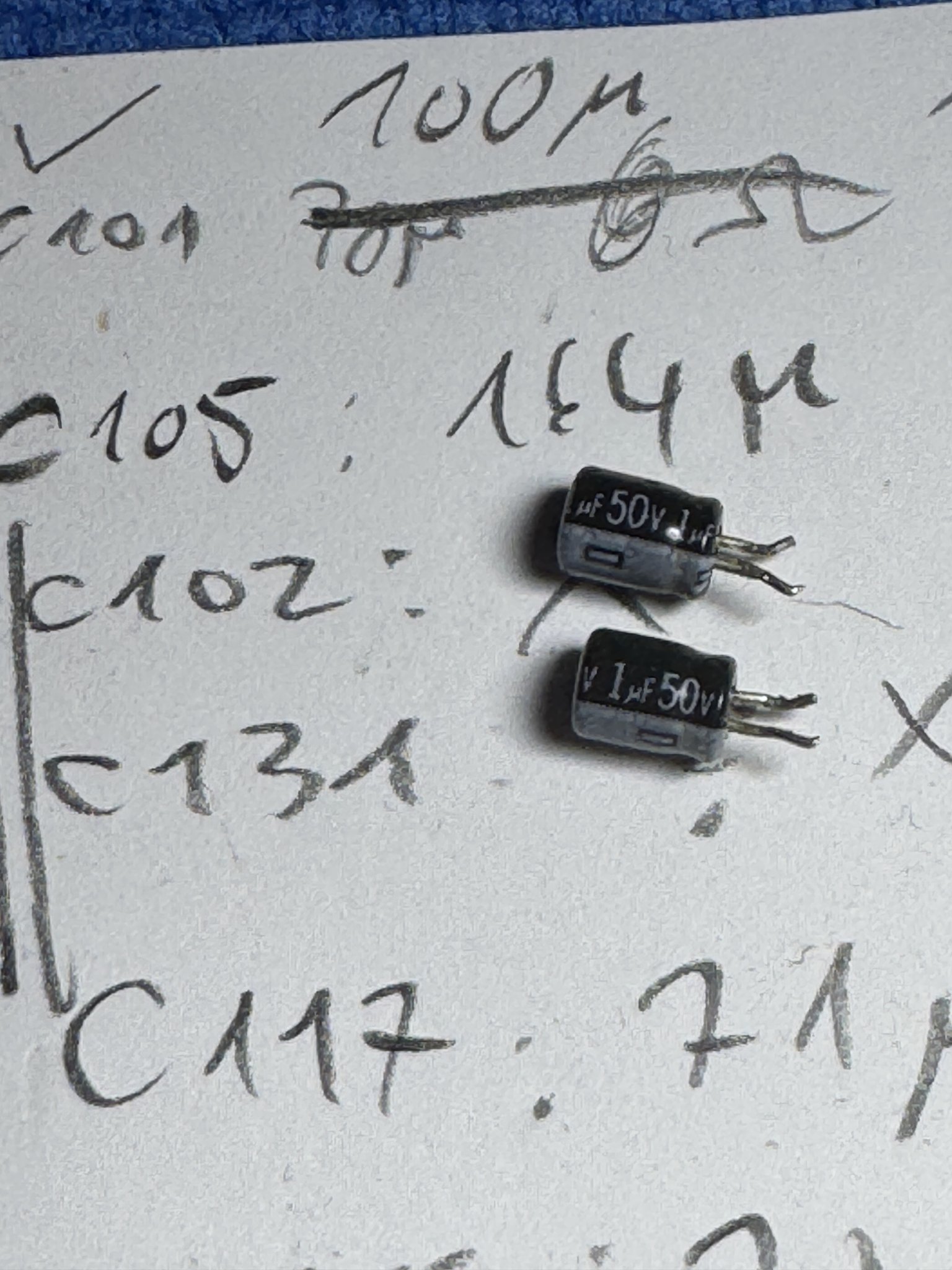

Perhaps it's worth taking a punt on just replacing the one you think could be most likely? If not I'm likely to sell it with the existing problem (for parts or repair) which would be a shame.
Is it C131 in the attached documents, and if so I gather that is a 50 Volt 1uF Cap. Do you know what type of capacitor that is for me to order, as I don't have it in bits at the moment - wife wanted the room tidy!

It's a tiny electrolytic, and the 50V rating is high compared to the actual volts in that circuit. (approx 4v)
A 25 or 35V cap would suffice.

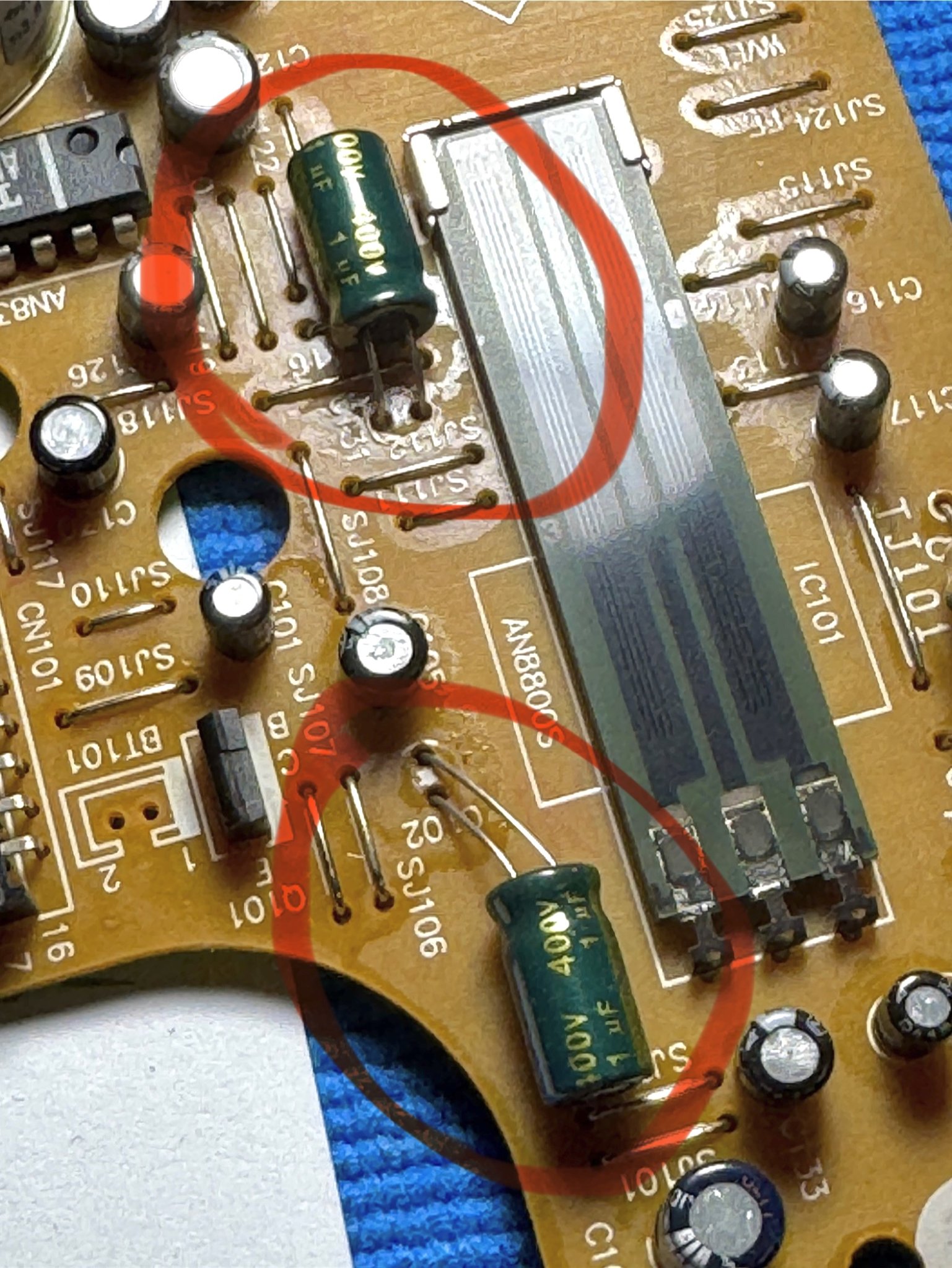

hi there, I realise this is an old post. Same problem with reading disks, but laser moves and works. Technics SL PS900 service / Repair manual said the fault was was some IC or other. upon dismantling I saw there were several Electrolytic capacitors on the bottom of the cd/servo circuit board on the cd transport. I did an esr check on them using an ESR meter which can be done 'on board' ( EVB ESR meter available new from Portugal) The results showed capacitor C131 and C102, both 50V 1uF as high (18 ohm) or unreadable. these were swapped out simply with panasonic long life equivalents with an ESR of 2.6 ohm . Other capacitors C129. C130, and C110 are bipolar and had high ESR, which is usual for bi polar and they were left alone. No other capacitors changed. The Cd player began reading and playing correctly immediately.
Note that the capacitor numbers are screen printed onto the board so there is no need for a schematic. Use care when removing the circuit board mentioned from the botom of the CD transport as there are two ribbon cables, do not damage them.

Same issue!
Thanks for your help! C102 and C131 were defective!
Replaced it with Long life Capacitors in bigger Size..
I used the ESR meter (https://joy-it.net/de/products/JT-LCR-T7), it works really well!
