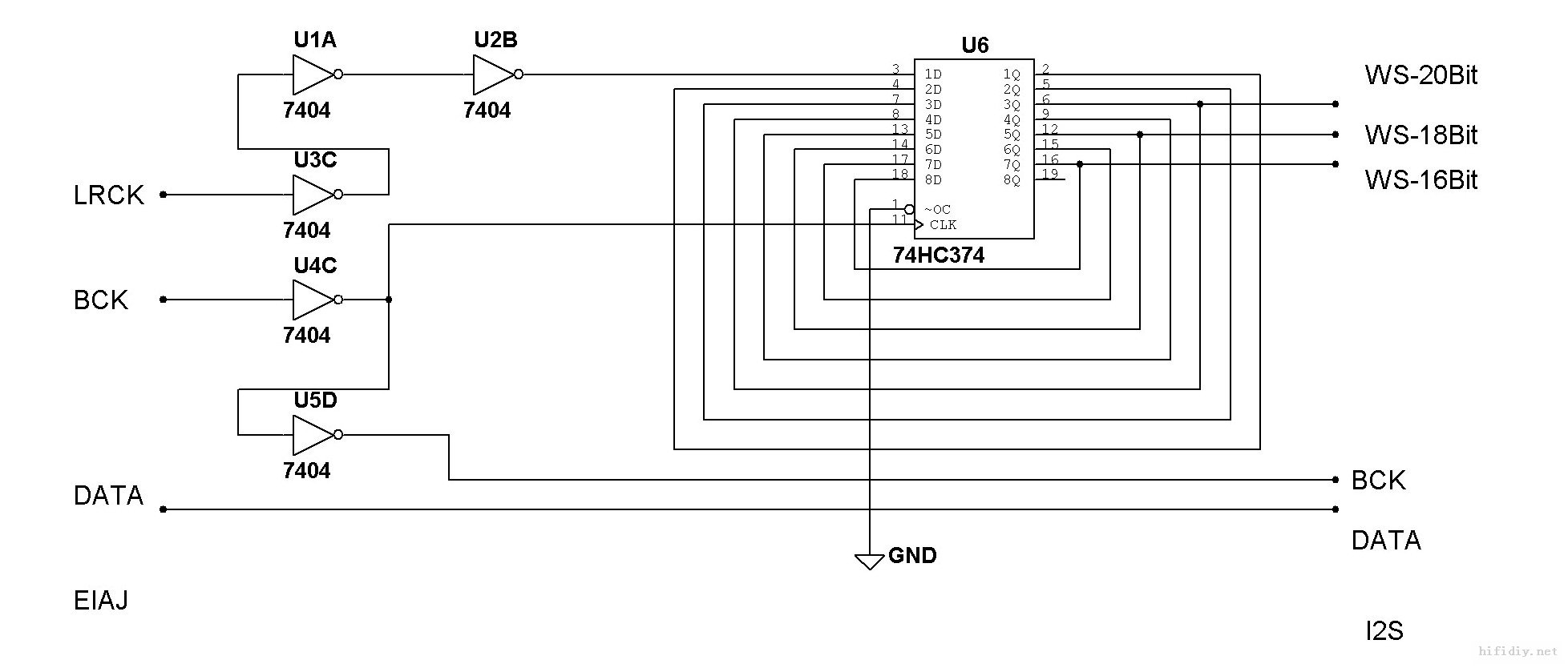

there is a high chance of wrong data format ... it seems that an EIAJ format is used in this player ... maybe you will end up with an additional converter from EIAJ to I2S (not opposite)
someone tried? idk if successful:

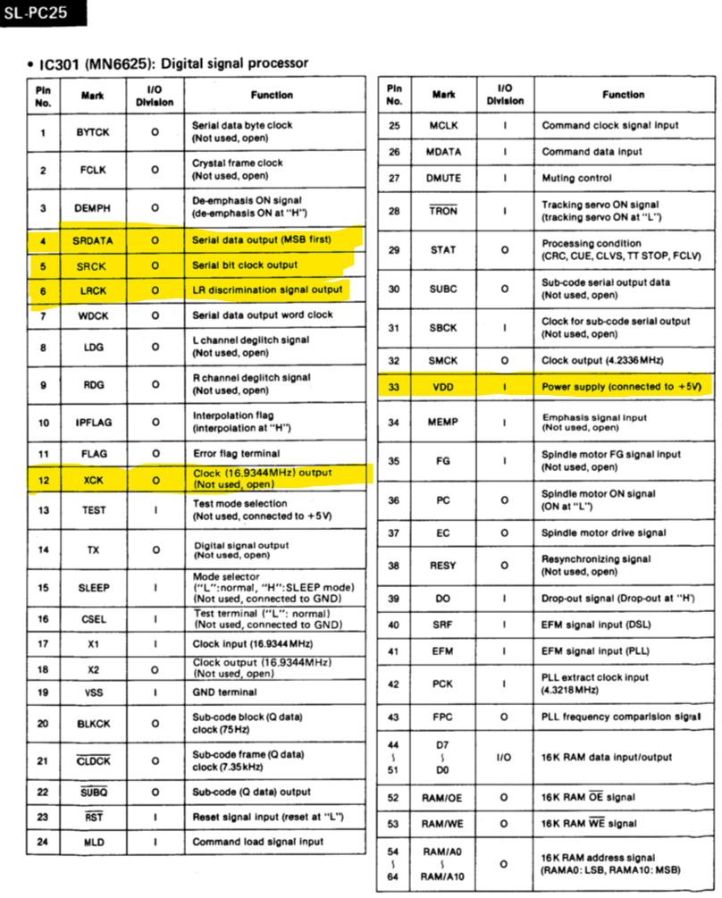

Looking at the thread above inspired me to dig deeper.
I can see repair manuals for the SL-PC14,20,25 models. SL-PCxxx manuals
The SL-PC25 has an MN6625 DSP, with pins 4,5,6,12 showing SRDATA, SRCK, LRCK, XCK. Great!
Pin 33 tells me there is a 5v supply available.

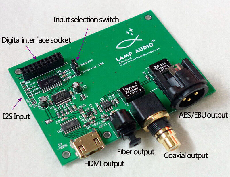

eBay has several I2S to optical/coax/AES converter cards in the $12-$90 range. Some have one of the outputs missing that I do want. Some have USB, HDMI, and bluetooth, none of which I need.
I'm looking at this one for $25 delivered eBay I2S converter
It wants a 5v power supply, which I assume I can vampirically steal from the Technics.
Seems to me I can connect up pins 4 5 6 12 33 and GND, and it'll work.

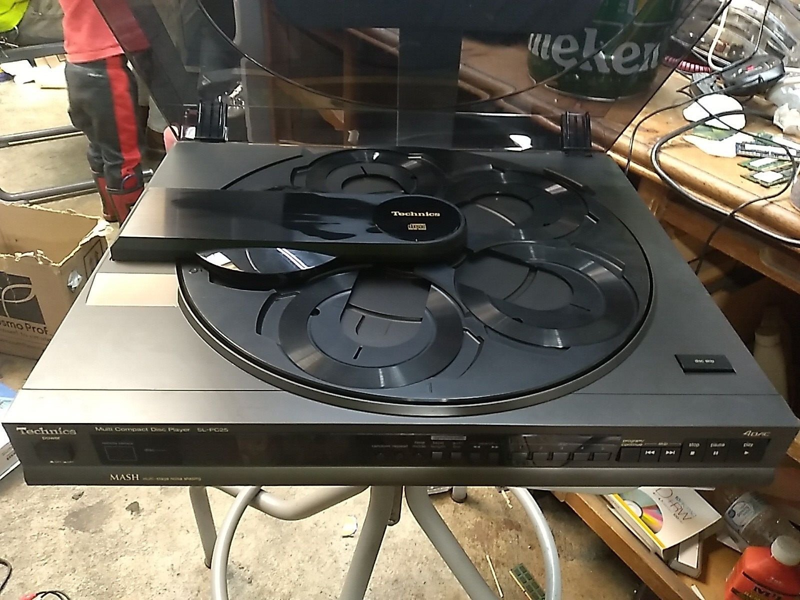

Grr.
eBay vendor cancelled the SL-PC25 order and listed the reason to eBay as buyer cancelling the order. Which I didn't. Why do people make up lies like that?
The player purchased is the one pictured above. Appears unmarked and looked nice.
Plenty more to buy, but I won't have one to play with this weekend.

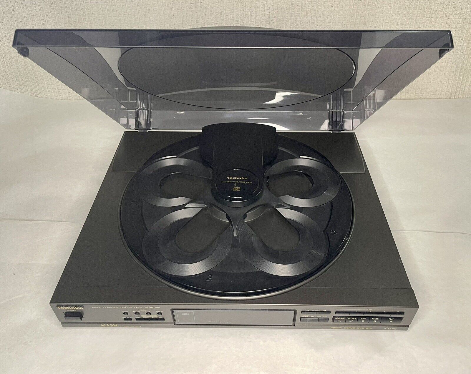

This time I chose an SL-PC705. My selection criteria are to choose the one in visibly best condition, and that is listed as working.
ETA Monday 31 July. Actual purchase shown.
The first purchase SL-PC25 was released 1990 at 9lb.
The second purchase SL-PC705 was released 1991 at 10.4lb.
So it must be better. Because that's how it works, right? Not to mention the model number is bigger!
I do not (yet) see a repair manual. I'm optimistic that I'll be able to open the unit, read the numbers of the DSP and DAC, and on the internet find the pinouts of either IC in solus or in another Technics/Panasonic manual.
The physical format is different - on the SL-PC25 the transport is in the left of the unit. In the SL-PC705 the transport is at the back of the unit where I was going to put the I2S converter. Hmm. Didn't realise that until I wrote this update. Oh well. The convertor will either go there, or it'll go in the side. Or I'll remove the existing RCAs. Or I'll make it external.

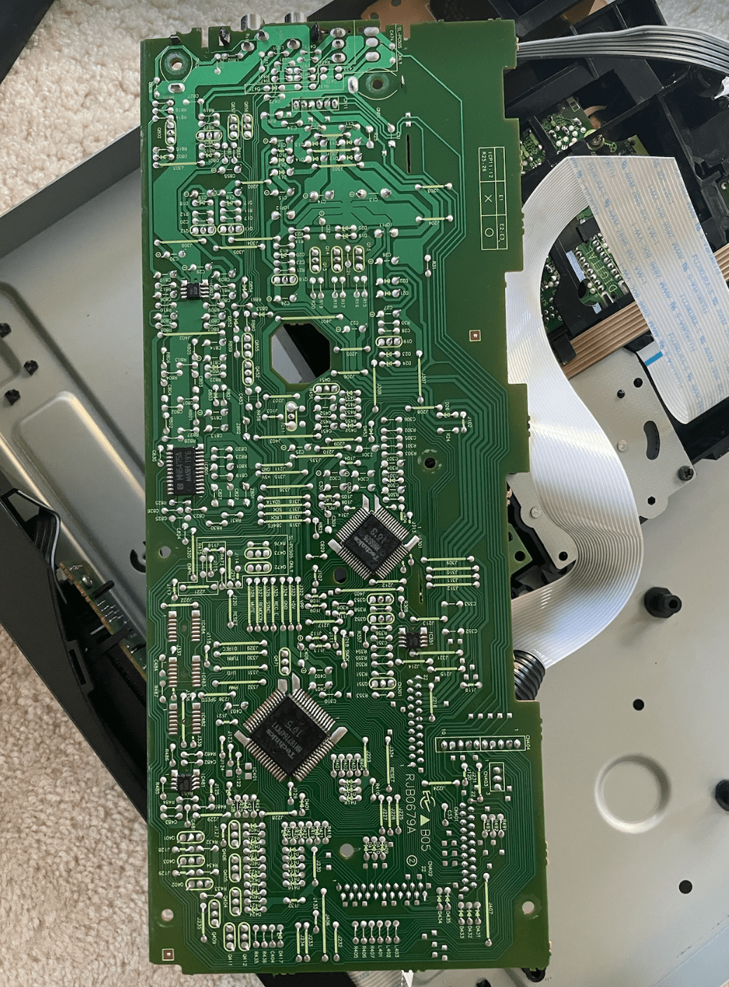

I like this generation of Technics cd player, I had almost all the ones with Philips mechanics and I still have 4 or 5 and suddenly I ask myself the following question, why not simply copy the output? digital P series with the 6625?
knowing that there is a good chance that the main PCB of your changer comes from a single cd model and that said PCB has the original location (unpopulated) of the digital output stage.
These are just guesses but I've seen enough of them to know the similarities between the models.

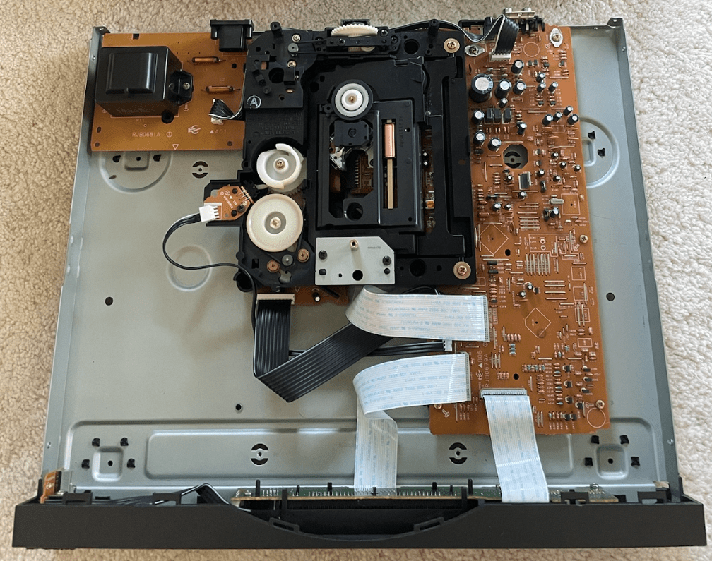

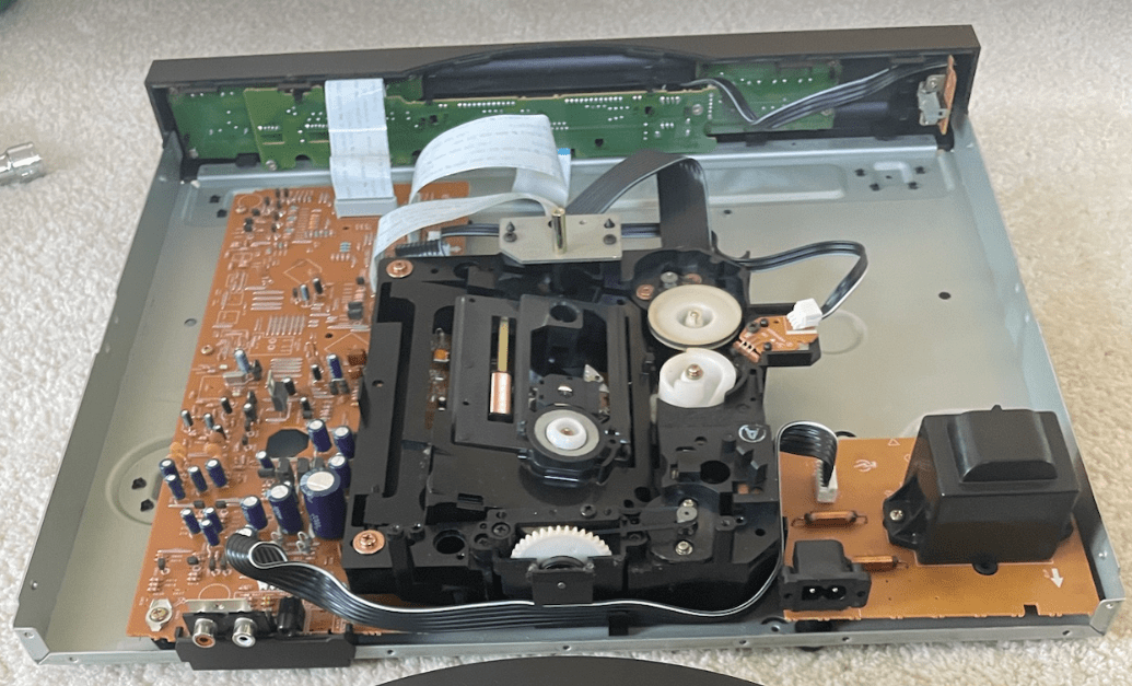

I have the SL-PC705.
The only unpopulated section is for the wired remote of the SL-PC505, suggesting the board is only for the 505/705.
We obtain the I2S signal locations from the DSP, MN6626 link (same as the SL-PG100 at the top of this thread)
For what it's worth, the DAC is MN6475A link
Despite the huge size and ample free space, it's not obvious where to put the toslink card when it arrives (the small card at the end of post #11).
From these images, there appears to be space near the existing RCAs, or near the power supply.
That space is not there - it is occupied by housing for the hinges.
Hmm. When the toslink card arrives, I'll see how easy it may be to desolder the optical and coax sockets, and mount those on the back panel while the majority of the card goes in that large space front-left.
