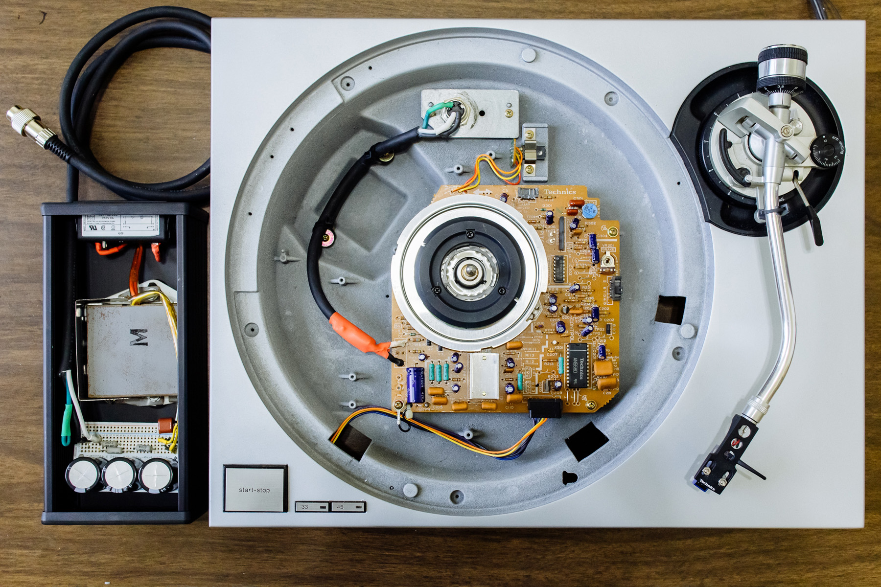

The most guarantees come by removing the transformer (and all AC) from the deck all together. Everything else will be subject to somewhat random outcomes due to individual product construction technique.

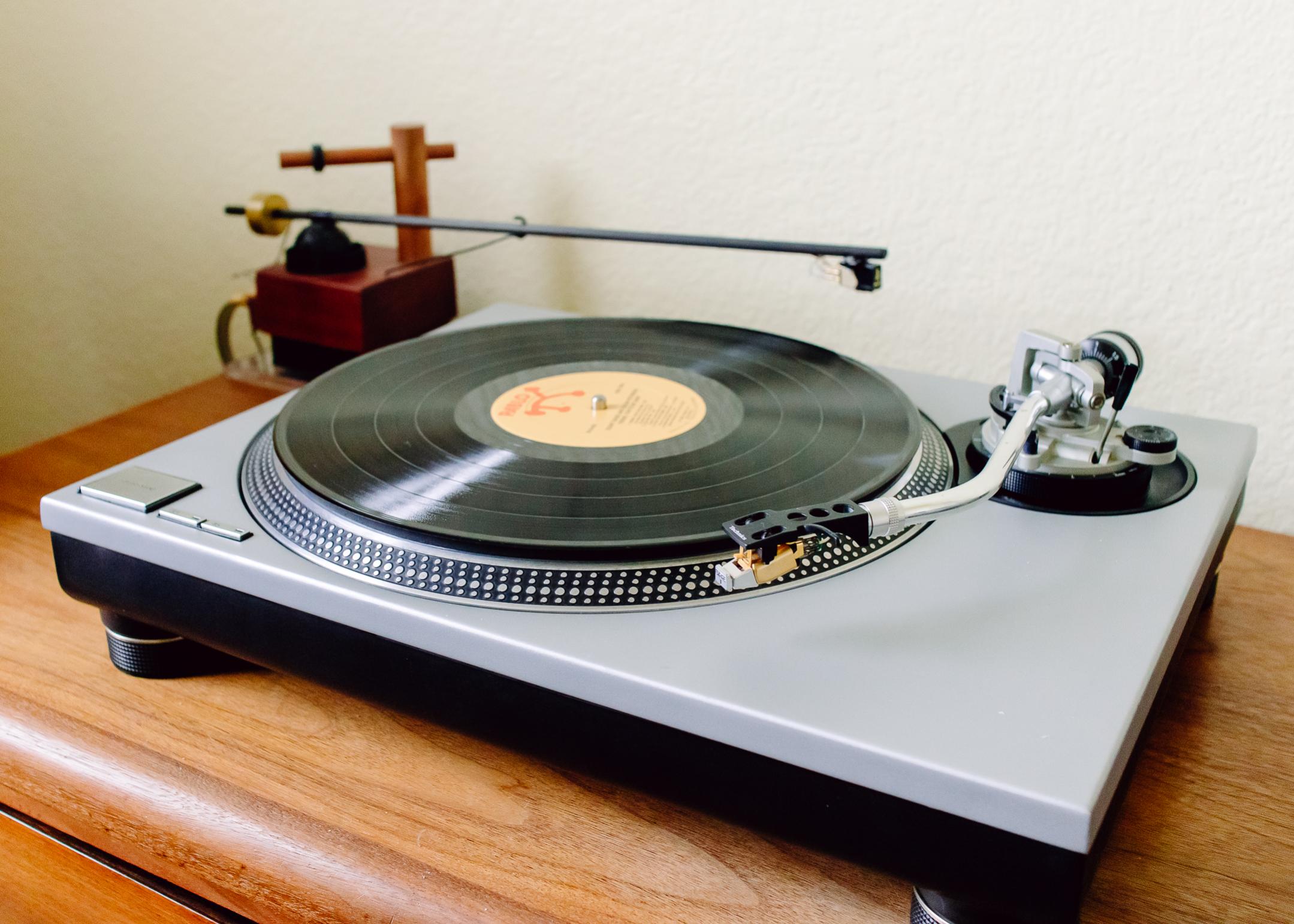

Hey guys, I am refinishing my 1200's plinth and had a couple of questions about the strobe. Do you really need it on this deck? KAB says that eliminating the strobe reduces the noise and blah-blah, not sure I am buying that it is audible. So that is the one thing to remove it and disable the circuit. However, most important 🙂 Check the photo of new sl-1500, I absolutely love that clean look without sl-1200 stylus light and turn on/strobe bulge 🙂.
I mean what are the chances that something get broken and the speed will go off a bit and you will never know and well be listening all your records a bit slower/faster like an idiot hahaha 🙂
meanie - it was just plain bondo body filler. Tape the holes from the back, spread bondo over the top, then sand it flush after it dries. I'd actually like to do another one and use metallic filler so the top could be powder-coated.
