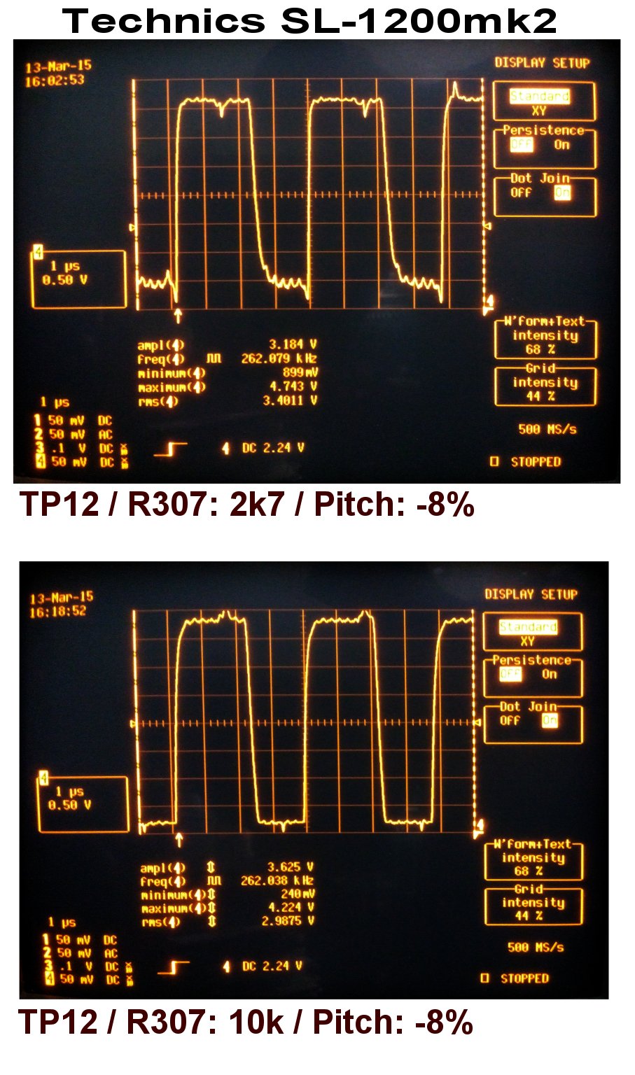

It looks like Imageshack decided to destroy my account, here's the screenshot missing from previous post.
This clearly looks like the 2k7 resistor is overloading the "FO" output.
Interesting.. In terms of current flow, I guess that means that R307 was pulling too much current from AN6680's FO output?

Any idea why it only affects the falling edge of the square wave?
That's the same conclusion I came to too.
AN6680 and AN6682 are supplied with 9V from AN6680's internal reference and Q201.
For some strange reason (Anyone with an explanation let me know! Did they plan for TTL and finally go CMOS?) IC302 (4011) is supplied at 5V from R304 and D301.
It would make sense that the AN6680 "FO" is an open collector or open drain output and that R307 is the pull-up resistor allowing for a 0-5V output, if R307 is pulling too hard "FO" cannot drive low correctly.
I just checked the I/V curve of AN6680 "FO" relative to GND on a spare IC, it appears symmetrical, so possibly not open drain type output, it would be nice if someone could confirm that by measuring "FO" with R307 open. (I no longer have the turntables.)

The scope is a Lecroy 93xx series, nice scopes to use, I now use an RS232 link rather than digital camera 😀
Quick update,
I had 2 in for repair with the same problem, the second was fussier, looking trough the service manual on various schematics you can either read 2k7 or 10k for R307.
The turntables I have are from 2006 and had 2k7 for R307, replacing this by 10k solves the problem much better than finding a good 5.1V zener for D301 as this turntable would loose lock with voltages of 5.3V on D301.
With 10k the fall time and low-level noise of "FO" (Pin1 of IC301/IC302 or pin3 of IC201) are much better.
The odd thing is that with a trimpot in place of R307 I find that 2.7k ohms is about the value needed for problems to appear, maybe Matsushita decided their product was much too reliable for the present day and found a quick workaround for making it less reliable with minimum modification. Maybe not, but then someone will have to explain why R307 should be 2.7k

Many of these turntables have worked perfectly even with the 2k7 resistor for years, then at one point components have aged enough and in hot enough conditions the fault shows-up.

The .PDF service manual I have states both 2k7 and 10k ohm for R307.
I spent a while investigating on that fault, charged quite a bit of cash, I've had no feedback from my customer who uses his turntables intensivley, I take that as good news knowing that I would have heard from him if there had been a problem.
I only settled for that solution because the service manual mentioned 10k for R307 and the measurements agreed, I'm also convinced it's the most reliable fix suggested so far although the waveform could be cleaner.
