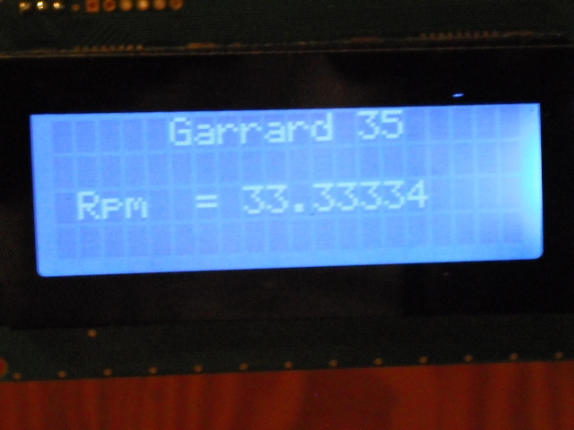

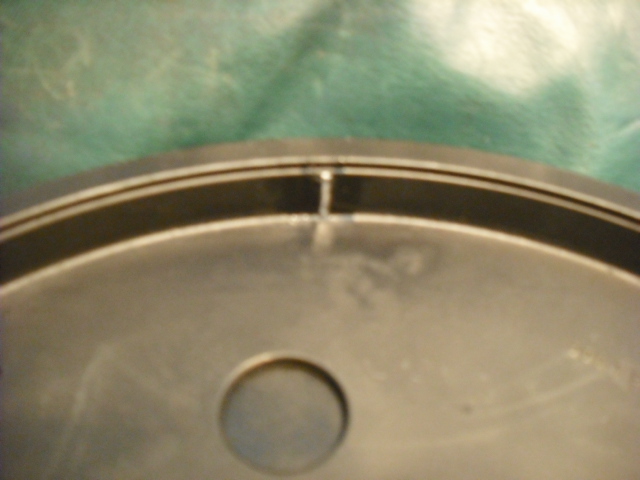

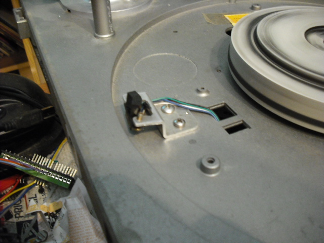

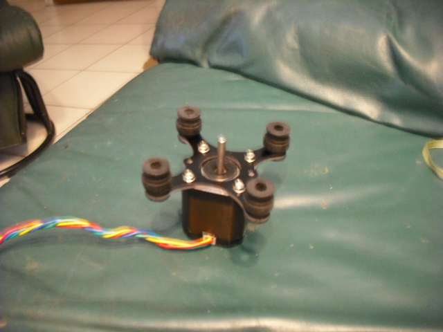

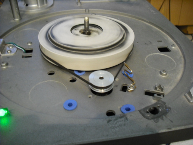

I have an old Garrard GT35X with a worn out motor that I was planning to toss it in the trash and then decided to see which alternative I have to replace the motor. Since I worked with micro I decided to repair it before toss it out. I tried some dc motors controlling them by the micro but the speed was not constant. Then decided to use a stepper motor since it is easy to control the speed using PWM. To control the speed I used an Optek OPB775TZ reflective object sensor. Painted the bottom of the platen black and glue a small reflective metal strip at the edge of the platen to use it as a speed index. Replaced the original spindle to 1 inch diameter pulley since the stepper was running at 1000 pulse per seconds and was causing a whining noise coming from the stepper. Doing so the pulse per seconds drops from 1000 to 660 PPS. Now the noise it is barely heard. You have to be very closed to the motor to hear it. Wrote a program to control the speed by reading the index pulse to calculate the time between index pulse and then adjusted the PWM frequency right on at 33.33334. To prevent the motor vibration I used a "Vibration Isolator Low Profile Carbon Fiber Mount" used in drones. Right now it is in test mode and the sound it is very good and the speed it is also constant. Attached are some pictures showing how I mounting the motor, the sensor and the index marker.
