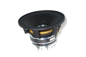

If you want whizzerless hemp and a tweeter, you could always buy these and keep that point source imaging. They haven't made it to the DIY crowd yet, but I gather a few are on the market in other applications. The pic is lifted from Hemp Acoustics products page.
pj

I’d imagine these would work well in a BIB.
From Madisound’s website: “The H1333 and H1353 will have a leaner bass sound, perhaps blending a little better with a subwoofer in a purely audio system.”
Or perhaps the BIB cabinet design could bump up that bass nicely and eliminate the need for a sub?
These drivers look very cool and could be a good solution for SS fans wanting to hear the BIB benefits of more bass, enhanced imaging, ease of presentation, increased soundstage, etc…

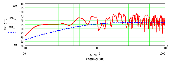

Here's a 'short' version with 150in of line length, zdriver of 32.5in and 75in^2 Sl. Target F10 of 23Hz, before room gain.
Ha! And that's the 200 pages! It's important. Our little tribute to Terry Cain. He certainly didn't invent them, but without him, not as many of us would have heard of this alignment. Me included.

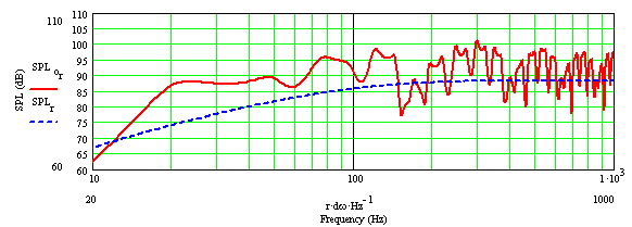

And as it's the season for having fun -you know I said 'short' version' above? You didn't think I'd leave it there did you? 😉 The long one. Full 1/2 wave tuned TQWT for Seas Coax with 26Hz Fs. Triple fold, floor-venting BIB -it needs the triple fold, I promise.
Line Length = 260.5in.
Zdriver = 28.25in
Sl = 85in^2
Flat to 20Hz in 1/2 space. F10 ~12Hz before room-gain. If anyone is insane enough to build this (and it's certainly not impossible by any stretch of the imagination) be aware you'll need a suprabaffle to space the driver out from the first sloping internal baffle. I'll let you sort out the internal layout as I'm lousy at drawing. Hope Terry would approve. I think he'd have a grin on his face at least.

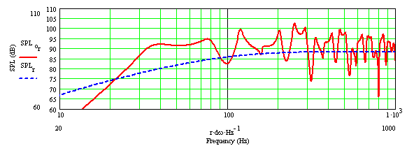

Accidentally deleted post when editing. Quad fold is theoretically possible. Target 19Hz. Absolute limit for the insane. Nurse! Thought Experiment. Almost certainly won't work in real life. But a bit of fun.
Line length = 356.5in
Zdriver = 38.75in
SL = 85in^2.
Note: these aren't actually very wide boxes. To get the 85in^2 terminus I assumed 8.5in wide x 10in deep mouth. Not the ideal flare rate, but for these particular sims it's not important as they are assumed to be unfolded.
Of course, as you'll see from the graphs, you loose gain in the LF from the longer lines in favour of extension. Not automatically a bad thing, as we've got room lift to add to this little lot.
Greg -tell us this doesn't work and get us back on the planet after our quick indulgence in madness. 😉 It's the silly season after all.
