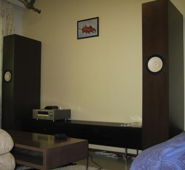

Sawdustfull summer behind and I finally got my BiBs ready.
Speakers are 70inch tall as ScottMoose suggested, and I must agree they're not ugly at all.
Width is 225mm and Depth 545mm, which gives me little extra to low end.
With a little padding inside of them the sound they produce is excellent.
Summertime well spent, coverd with sawdust...

tpakkanen said:Sawdustfull summer behind and I finally got my BiBs ready.
I miss those days, so many drivers/'dream' designs, so little time.........
Anyway, FE206E? Any EQ used?
GM
