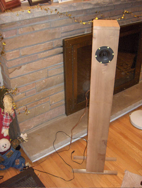

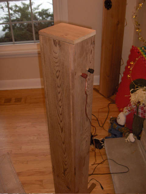

cheap and easy bib!
Dayton RS100-4's from PE. Cheap, good FR response, not too sensitive, but Tripaths can pump more watts into 4 ohms.
BIB calculation works out amazingly for these drivers:
3/4" thick wood.
5.5" x 42.5" (4 of these, front, back, and sides)
4" x 39.75' (internal divider)
4" x 5.5" (for the top/bottom piece)
You can have most of the cutting done at the store, since 5.5" is what most stores carry as "6 inch nominal" board stock. Front and back and sides work out to the same panel size, very easy.
So far I've made a couple, out of poplar and cedar. Pick coming up soon.
Mitch

Mitch,
What line length/tuning are you shooting for? I know I'd really love to know how these sound. I've got a pair of RS100-8s that I've been using in OB for the last several months, but I've always thought to try putting them in a BiB, see if I could get away without any sort of help down low with one.
Kensai
Kensai

When I ran the Dayton RS 100-4 through the BIB calculator, I got different #'s.
Mine w/.75" thick material came out to: ( outside dimensions ) 6" wide X 7.5" deep X 42.5" tall.
Still very reasonably sized, and do-able with lumber yard stock, but some ripping would be required.
John
John
Here's an exerpt of the bib calculator spreadsheet from http://www.zillaspeak.com/bib-howtobuild.asp
The nice result is using the "rounded dimensions" and the automatic cut calculations at the very bottom.
Attached some pics of the results in cedar.
