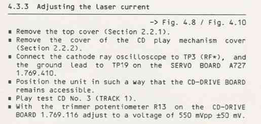

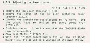

Hi Chris,
Thanks for your quick response. You could be right. Unfortunately the service manuals of Philips CDM1, and the players using this drive, follow a very different adjustment method from the one in the A727 manual (see attachment), using Test cd 4822 387 30096 track 1 (is this #5?) or a laser simulatorprint....
Do you know what kind of signal (KHz, dB) is on track 1?
Lourens
Lourens

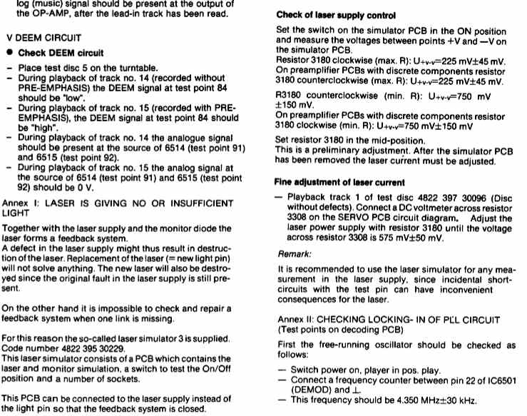

Hi Lourens,
Interesting. The procedure you have listed looks very similar to the training I received with Philips. I'm trying to remember back. I am pretty sure this is Philips Test CD #5. The tracks are simply music (that I am sick off). It is the reflectivity of the CD that is important. So you see, it has nothing to do with the material encoded on the disc.
My copy of Philips #5 gives a low level, so that you tend to turn up the laser power too high. I found that out when a Philips tech was giving me hell. I brought my disc (bought from them) up and proved it was not my fault. It was actually set bang on with my disc. BTW, my cost was $200 for #5 and $250 for 5A. No choice, I had to buy them. Stinkers. No other test discs cost so much. Rape and pillage.
Your part number is a Revox number. I am pretty sure it is Philips #5.
-Chris
-Chris

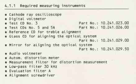

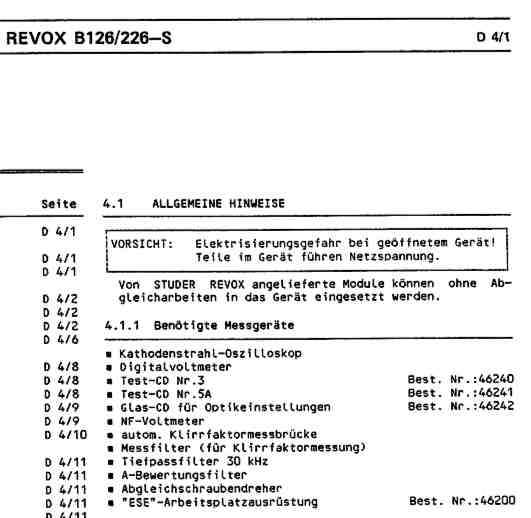

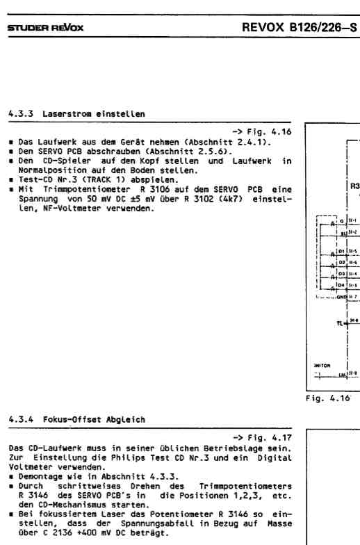

Hi Chris,
Sorry I invoked such anger. I guess it was (and is!) just a matter of commercial self esteem to exercise ones monopolistic rights?
Meanwhile it is still a bit confusing looking at the different approaches for laser adjustment. I compared several manuals, all of cdm1 equipped players from Studer (A727), Revox (B126/226) and Philips (CD104/204/304). The attached clips do show a certain consistency in the used test cd's though. My conclusion is that they all refer to the same disc numbers, but with different titles and part numbers:
#3 Revox part number 46240 = Studer 10.241.023.00 = Philips "Disc without defects" 4822 397 30096
#5/5A Revox 46241 =Studer 10.241.026.00
Never mind. I was just curious how to find an easy way to check some laser parameters after I compared a recently serviced A727 (ex NOB, Dutch public broadcast) with my own ones. In one of those I replaced the cdm1 for an almost unused one from a Philps CD104. They all sound different, of course
Lourens
