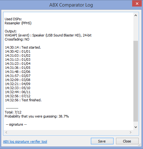

Let me be the first to show the test result, 7/12, close to coin flipping :).

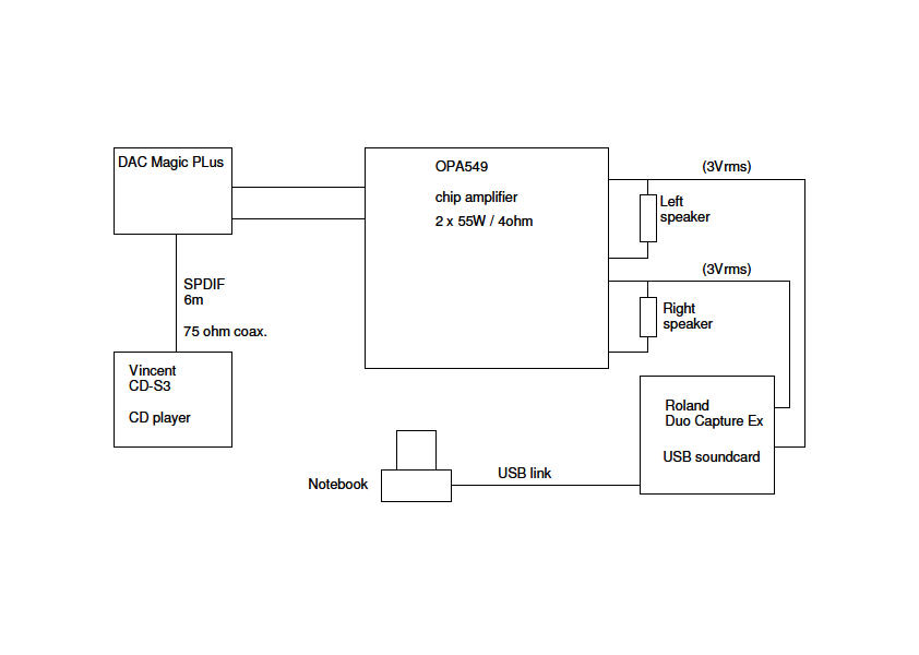

Let me say more about the test. There are two 44.1/16 files, on of them is original data from CD disc used in the test, the second file is recorded through this chain: Vincent CD-S3 player, 6m of coax SPDIF cable, DacMagic Plus D/A converter, power chip amplifier with OPA549, speakers Quadral Ascent 90, Roland Duo Capture Ex USB sound card for A/D recording. The two test files were matched in amplitude and time aligned at the beginning. The output for soundcard is taken from speaker terminals of the chip amplifier, the speakers are connected during the test. Voltage level is up to about 3Vrms at peaks. The chip amplifier has purely crossover distortion that lies 60 – 70dB below the signal magnitude (THD = 0.01% - 0.1% depending on magnitude and frequency). The crossover distortion has harmonics up to “infinity”, that means that both even and odd high order harmonics of distortion are present up to at least 200kHz at almost constant amplitude. I will show the spectral measurements later.
Attached is the test schematic.

Hi David,
the "probability" number is calculated by the abx software and there is no way how to affect it. It depends on the order and number of successful and unsuccessful attempts during the test. However, I do not thing this is important, much more important is the number of successful attempts from the total number of attempts, IMO.
