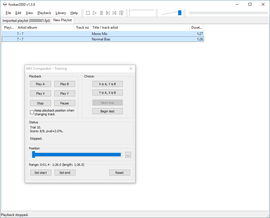

Sorry for gravedigging an old thread, but this is a super interesting topic. After reading through it I've seen people mention that it's not possible to discern the normal biased Texan simulation. I think I've managed to do this using the original song (Steely Dan I think?), listening for the snare drum transients. Both the low bias and the normal bias files hit a tiny bit softer, and since the original recording is so dynamic, it's sometimes noticable. The most difficult thing was probably finding a balance of listening to the files close enough after each other and at the same time trying to find the differences immediately, because any repeated listening tired my ears/brain super fast.
With the Bach violin I heard nothing in the violin itself - I don't listen to classical music much, so I'm not really trained for this. I was correctly able to recognize the low bias version by noise profile at the very beginning, but that's it, so I didn't even try the normal bias.
With the Rotel the 1 kHz tone is obvious, but the music was not obvious at all for me. I didn't listen to it very long, may try again some other day to identify other sounds to listen for, but the only difference I heard was with hihats - in one file they sounded more dry, in the other they sounded more resonant - I think that was 7 of 9. The difference was super sublte though, so when I got to 7/9, considering the filename I decided that's enough.
