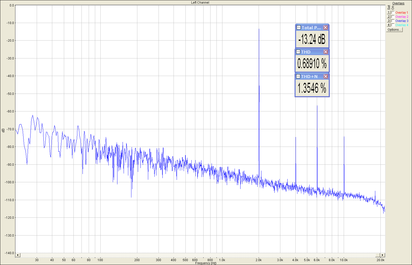

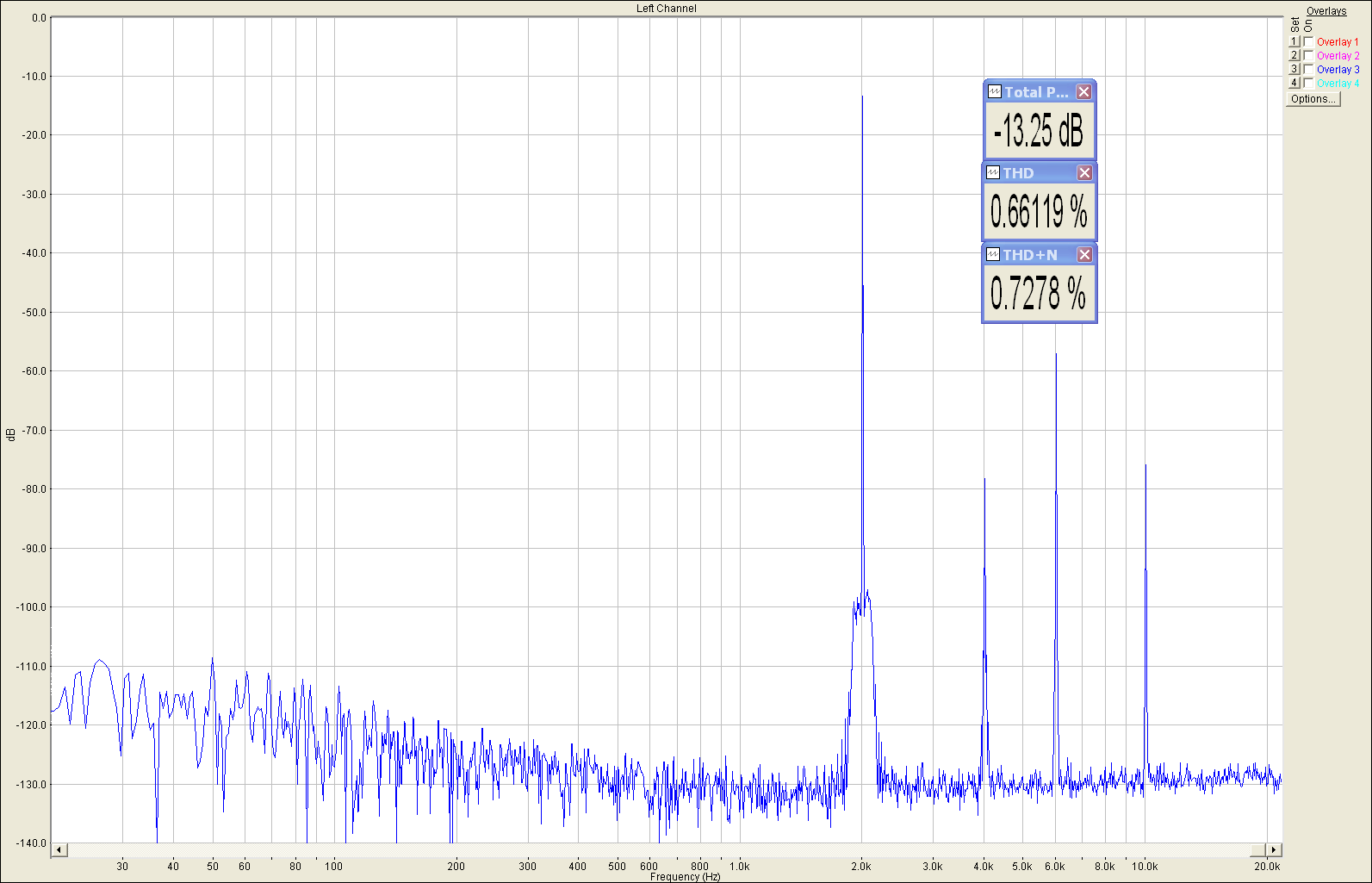

Guys, would you be interested in a test of audibility of speaker non-linear distortion? I think I have quite a good method how to extract ambient noise and microphone path noise from the recorded speaker sound. You can see it in the attached plots.
I have several recordings of speaker sines collected from the past. This one is 2kHz sine recorded at about 2V signal. If you would like to check audibility, the files are here:
http://pmacura.cz/speaker2k.zip
One of the files is digitally generated 2kHz and the second one is recorded via speaker and has ambient noise extracted (2nd image below).
ABX result should be posted. Anyone able to discern the files by listening?
