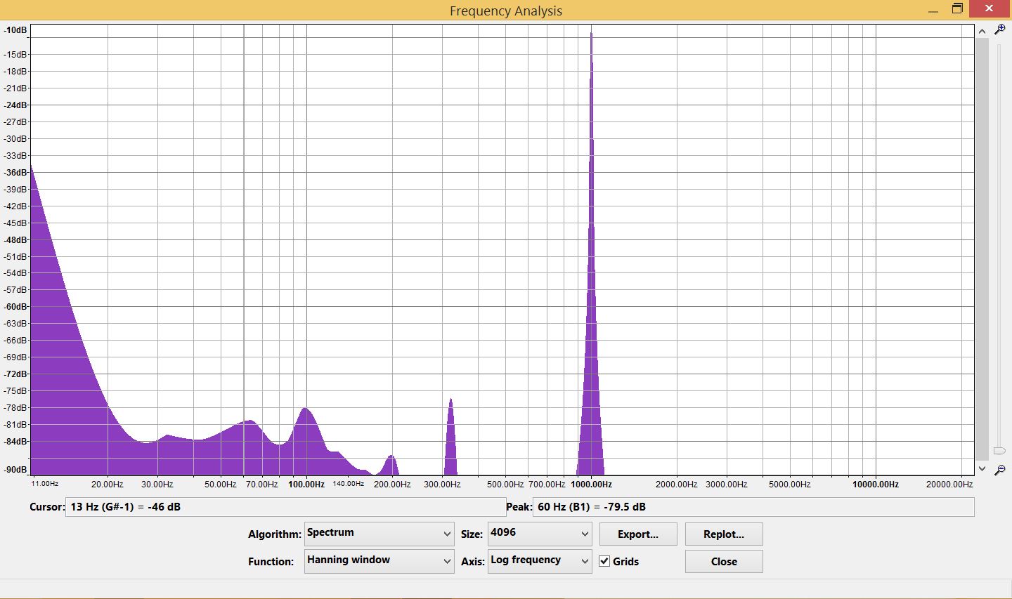

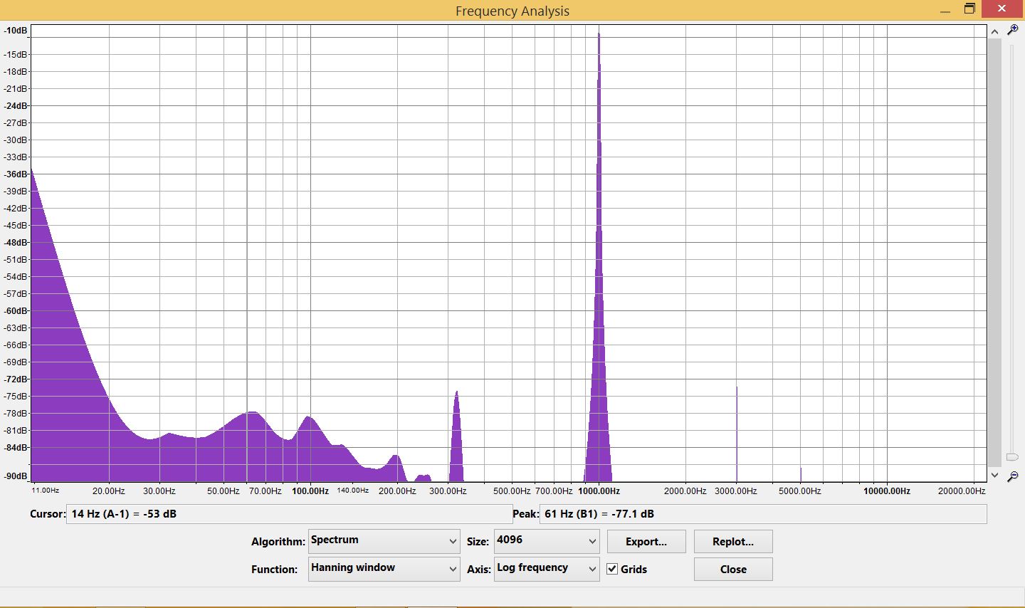

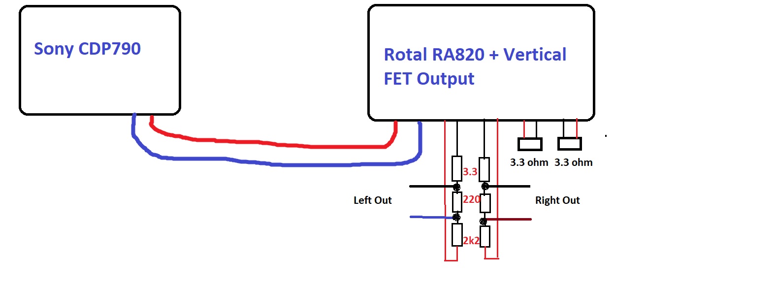

OK, here is the Rotel stuff...
For those just picking this up, I mentioned my old Rotel amp a while back and so took the opportunity to make some files based on a real amp with real crossover distortion. The setup was as shown below with the Rotel loaded by two 3.3 ohm 5 watt metal oxide resistors. Although that seems severe, I think given the levels involved and the fact we are looking to deliberately provoke distortion that it seemed a workable value.
Two sets of files, pure tone and music were produced using normal 120ma bias and zero bias.
The volume on the amp for the 1kHz tones was set using a Philips audio test disc (-3db track) to give 4 volts peak across the 3.3 ohm. Crossover distortion was visible on a scope (just) at zero bias.
The volume on the amp was then increased to give 5 volts peak across the 3.3 ohm load while playing a -6db test track. This was done to give the 'best fit' to the ADC input on the PC.
The input to the ADC was via an attenuator of 2k2 and 220 ohms in series together with 3.3 ohm ground lift resistors.
The Rotel has two speaker outputs and so the load was connected to one set and the record out connected to the other.
The FFT of the 1kHz tones is also below. The tones themselves are clearly labelled and included in the zipped folder.
The two music files produced from normal bias and low bias are here (the file names are a little enigmatic

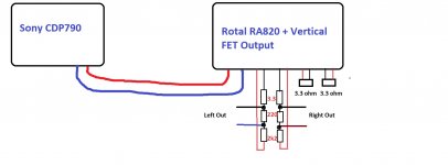

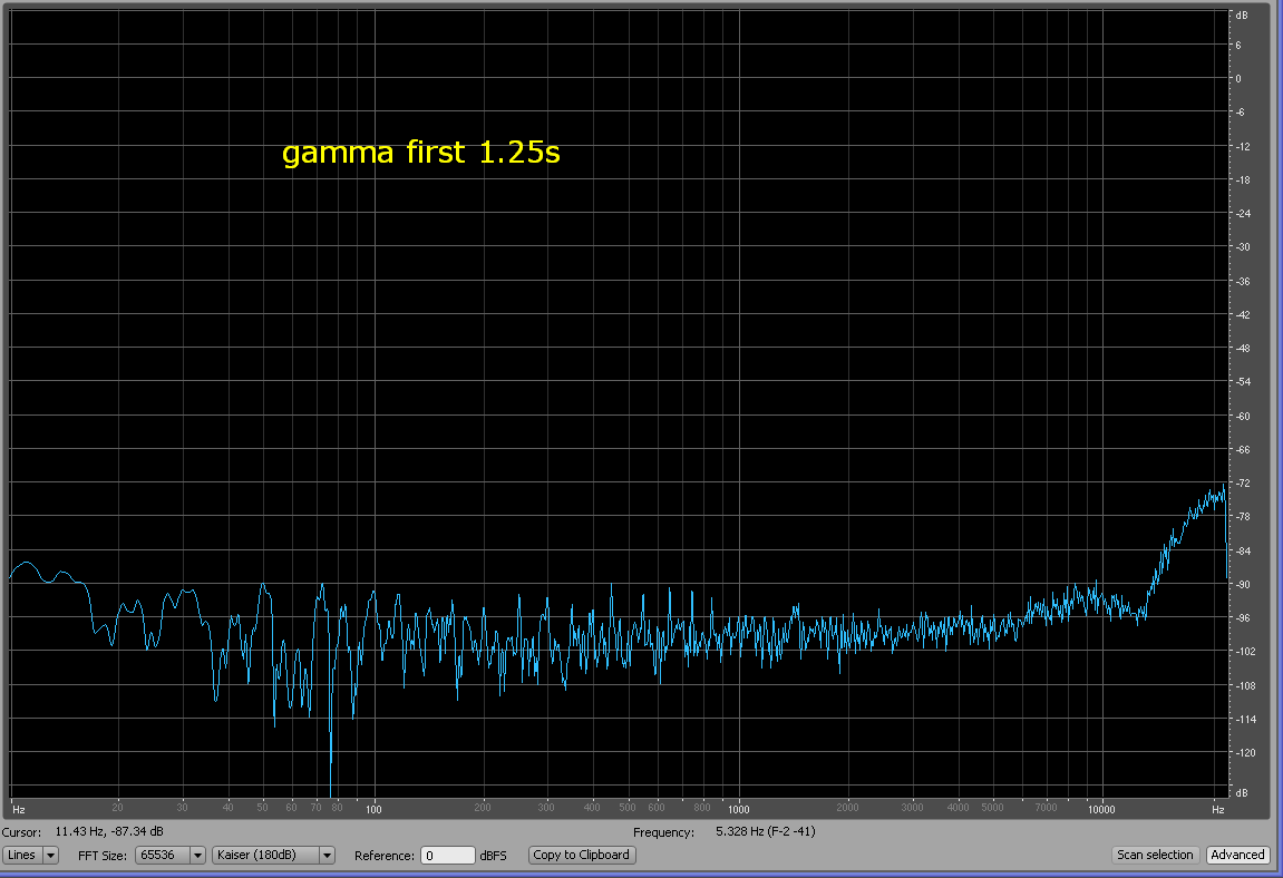

Yes, but interestingly enough "kappa" (file B in my ABX) was noisier by ear in the beginning of the music sample.
This said I do not mean the initial system noise, but the ambient noise in the beginning of file that starts about 0.5s as a kind of "huh".

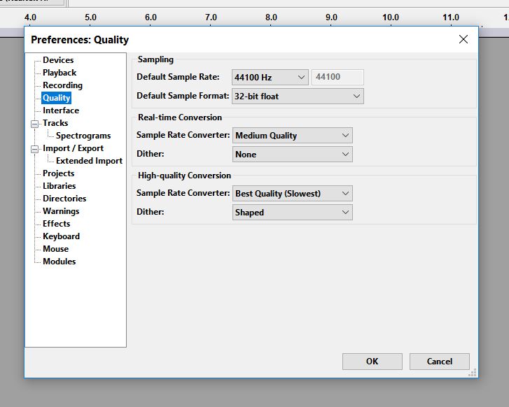

Karl, what kind of dither have you set in your Audacity? Noise shaping, right? How about TPD?
Like this:

Yes, shaped means dither with noise shaping, it emphasizes range above 10kHz up to 20kHz, exactly what I have shown in the spectrum. It is used as it is believed to reduce added noise in low and middle frequencies with increased noise above 10kHz inaudible. In one of my tests years ago I have shown that noise shaping dither may be audible and discernible. I would prefer to use a TPD, triangular option of dither.
Another interesting observation is that low biased Texan suppresses the added HF dither noise, maybe it is just incapable to follow very small higher frequency amplitudes due to crossover area of insensitivity.
