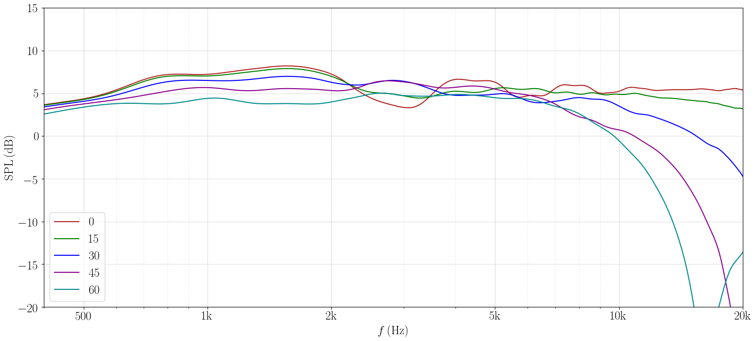

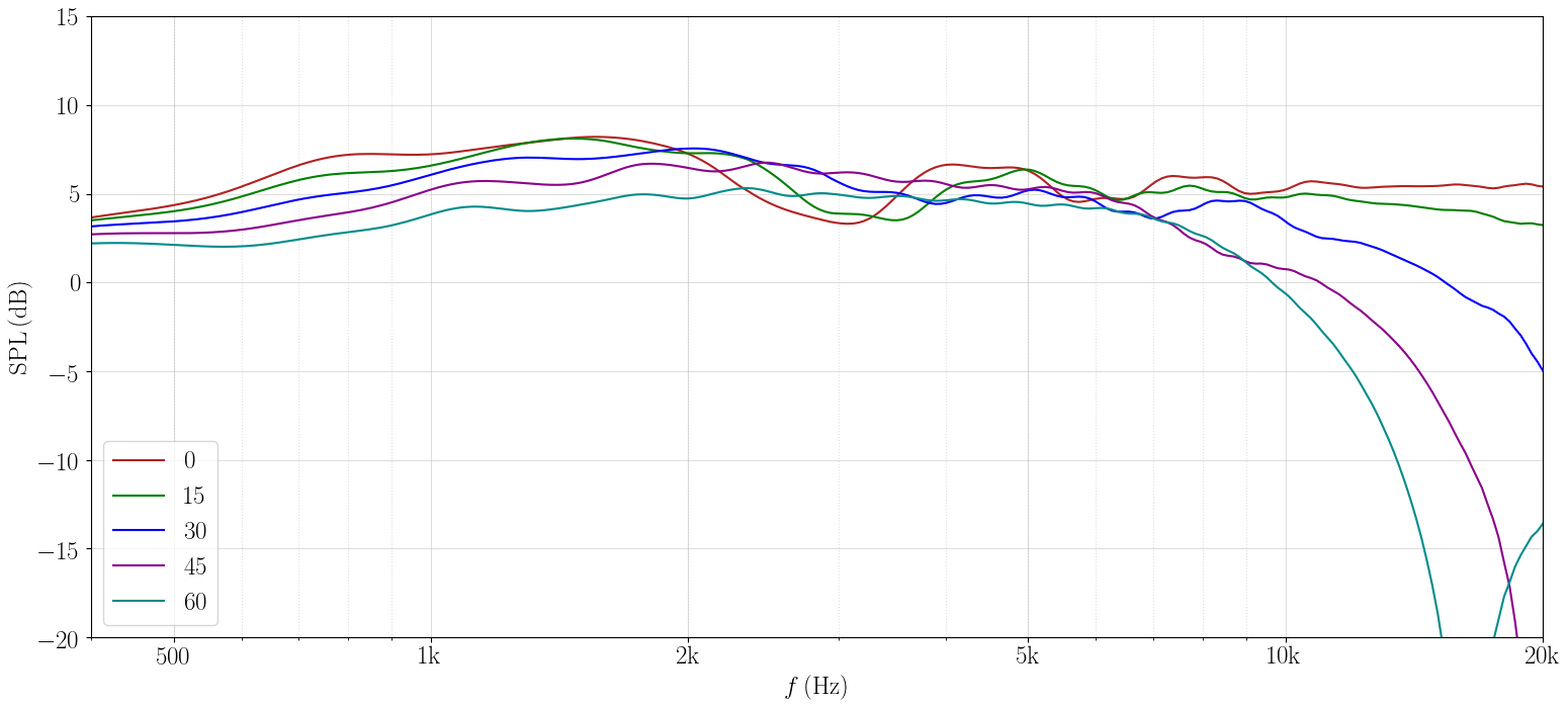

Definitely the 4th profile with the 30 degree bevels is producing superior results. It's the only one that doesn't have that severe on-axis dip between 2.4K and 3.2K. I wonder how shallow the bevel can be and maintain similar results?

Could somebody just walk me through what I am supposed to see in the plots.

What interpretation? Can't somebody just walk us through these curves and point to exactly what they are supposed to be revealing?

Take a look at the on-axis plot of all 4 baffles together (the first plot in post #14): The SPL matches from 10k up, the region where the tweeter would be isolated from any baffle effects. I conclude that the recording levels are properly matched between the various baffles. Therefore, the small SPL differences in the low frequency range (below 1.5k) are NOT a recording anomaly, but are actual differences in baffle effect.
Yes, the plots in #14 are fine, whereas those in #15 need normalization.Take a look at the on-axis plot of all 4 baffles together (the first plot in post #14): The SPL matches from 10k up, the region where the tweeter would be isolated from any baffle effects. I conclude that the recording levels are properly matched between the various baffles. Therefore, the small SPL differences in the low frequency range (below 1.5k) are NOT a recording anomaly, but are actual differences in baffle effect.

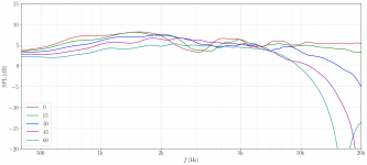

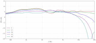

Here are simulated diffraction gain curves (for the control baffle with sharp edges) in both the vertical and horizontal directions (normalized to 0dB at 10Hz). Note that these curves flatten out quickly everywhere off the tweeter axis, with the implication that the power response is essentially the same for all baffle shapes. In the plots, I've tried to keep the same aspect ratio, axis increments and line colors as for the measured data. I just made a guess for the tweeter location and enclosure depth, so if I get more precise baffle data I can regenerate these curves.
BTW, these results indicate that DaveFred's polar plots were actually normalized properly in the first place, so my apologies for the earlier comment about that.
It would be very interesting to see the measured vertical polar curves, as well as the infinite-baffle measurements. With the infinite baffle data we could extract the diffraction gain.
NOTE: images order is horizontal then vertical
