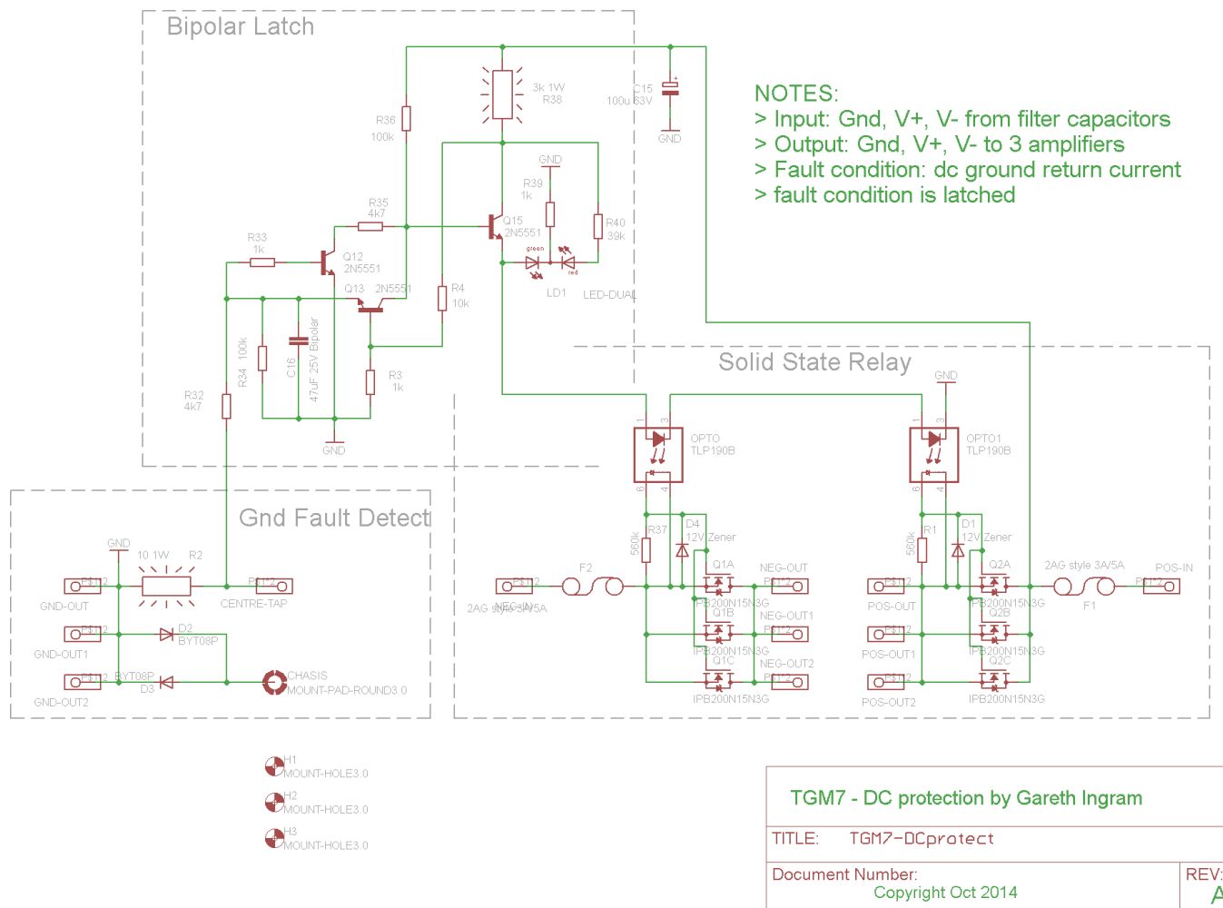

back to the topic of speaker protection, I'm thinking of another crazy scheme!
This time, something that I can pop into the power supply without needing to wire things up to the amplifiers. The idea is to look for a dc error and cut off the power rails. Instead of measuring a dc error at the amplifier outputs I would instead, look for the error in the speaker return current to the transformer/filter capacitor ground. It seems to check out OK in spice. I've 'borrowed' the basic circuit from the TGM8 amplifier protection circuit.

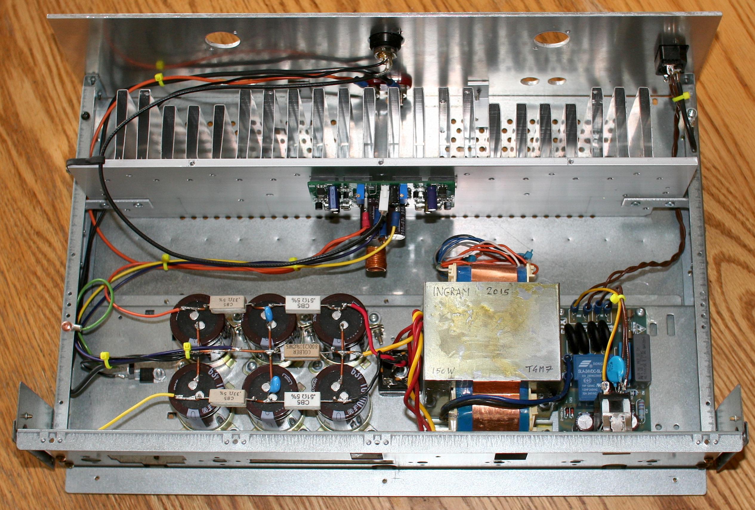

This is the final version of the TGM7 amplifier.
I decided to go with a mono-block, so that I had lots of headroom on the power supply and heatsink, plus the wiring is easier (back panel has cut outs for total 3 channels for future expansion). The power rails measure at just over +/-52V at idle. Bias is set around 120mA per rail (could probably be set quite a bit higher if warranted).
I think I described the power supply already - soft start module included, trafo then feeds a snubbered bridge rectifier and then 3 pairs of 10,000uF 63V caps in a C-R-C-R-C topology. The speaker return, input RCA ground, amplifier ground and safety earth (back to back diodes to chassis) all terminate at star ground between the final caps. Chasis is connected to IEC ground pin.
For speaker protection I decided on an 800R 5W resistor between the CT of the transformer secondary and the star ground. The amplifier has fuses in the output, inside the feedback loop (see earlier details).

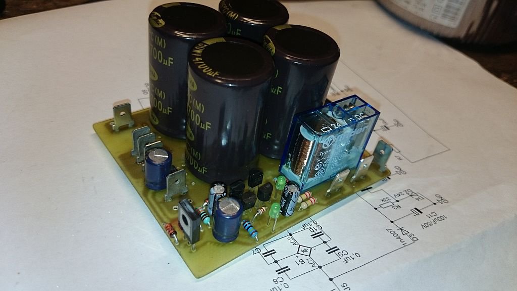

Bigun
I am using simple speaker protection circuit, it is working very well, for past few yeares never failed me down. It may be usefull for you.
The time can be adjusted simple by changing one capacitor value. The 12V and 24V relays can be used (just one zener replacement neaded if required). There is no neaded additional supply either.
-DC protect
-delay speaker ON
-fast speaker OFF (when transformer is switched OFF)
-DC protect
-delay speaker ON
